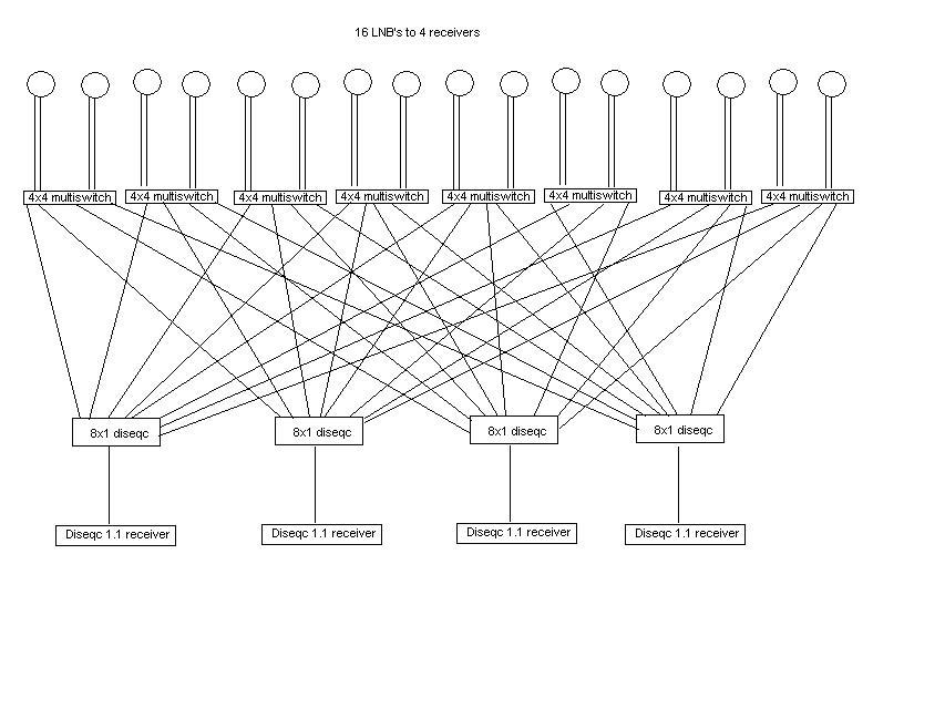

Here is one that I painted up (very poorly) but anole will update it to look spiffy :)
16 LNB's to 4 receivers using 8 4x4 multiswitches and 4 8x1 diseqc switches

And I just sent 'em back saying: Post 'em! They're great! And we're done!
Didn't realize he was going to do such neat drawings in Paint.
I was expecting word-descriptions, or maybe scanned-in gravy stains on napkins. - :)
They were just beautiful, as-is.
I did write up some switch tables, but anyone building anything that complicated can probably do their own! ;)
I know I did volunteer to do more pictures, but some of those Ice drew up would take up SO much paper with real icons, and keep me up 'till the cows come home.
And again, anyone getting into this complicated stuff should know what he's doing by now!
hint: LNB to the left side of the 4x4 is 22khz off, and the LNB to the right, is 22khz on.
I had that wrong or inconsistent before, and have since edited all my pictures to comply.

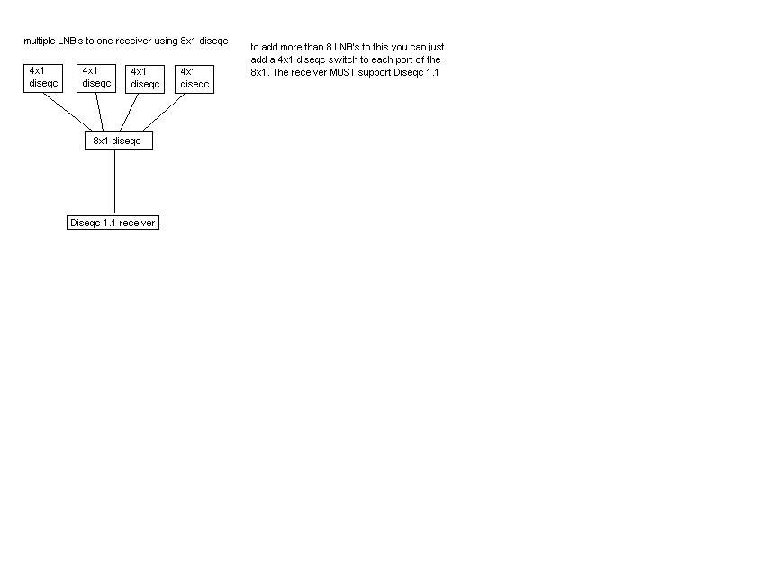

If your receiver supports Diseqc 1.1 you have the ability to add 4x1 diseqc switches to the inputs of the 8x1 for easy 3 LNB additions (I say 3 as if you go from 8 to the next step up yoiu would unhook the LNB in a port and hook it to the 4x1 so you'd go from 8 to 7 (unhooking the cable to hook up a 4x1) to 11
You feasibly could get 32 LNB's on this setup (or 64 if you added a bunch of 22k switches) ;)
Tony, Did you mean outputs?

Interesting this would come up.
But, no reason to not address it.
I consider the LNB connectors as outputs of signal.
They connect to the four inputs of the 4x1 switch...
...and then the one switch output connects to the LNB or input connector on the FTA box.
As you say, signal flow.
