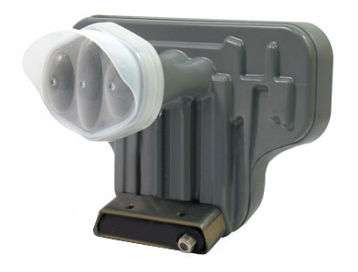

New sl5's aren't sidecars, but an all in one lnb like this.
