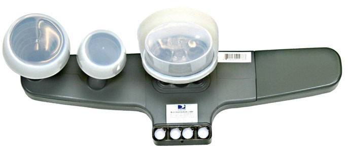

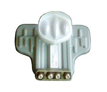

At the cabin on the older slimline make sure to use b band converter. Reset the receiver, repeat sat setup & be sure to select the appropriate dish setup. Also make sure switch is set to multiswitch.
The left pic is a slimline 3
The right is a slimline 5
It is important to select the correct setup.

Stardust & Raoul thx for the response I have done all that, b bands are in place. I was told it was a slimline dish and it has the slimline 5 lnb as pictured in your post.
