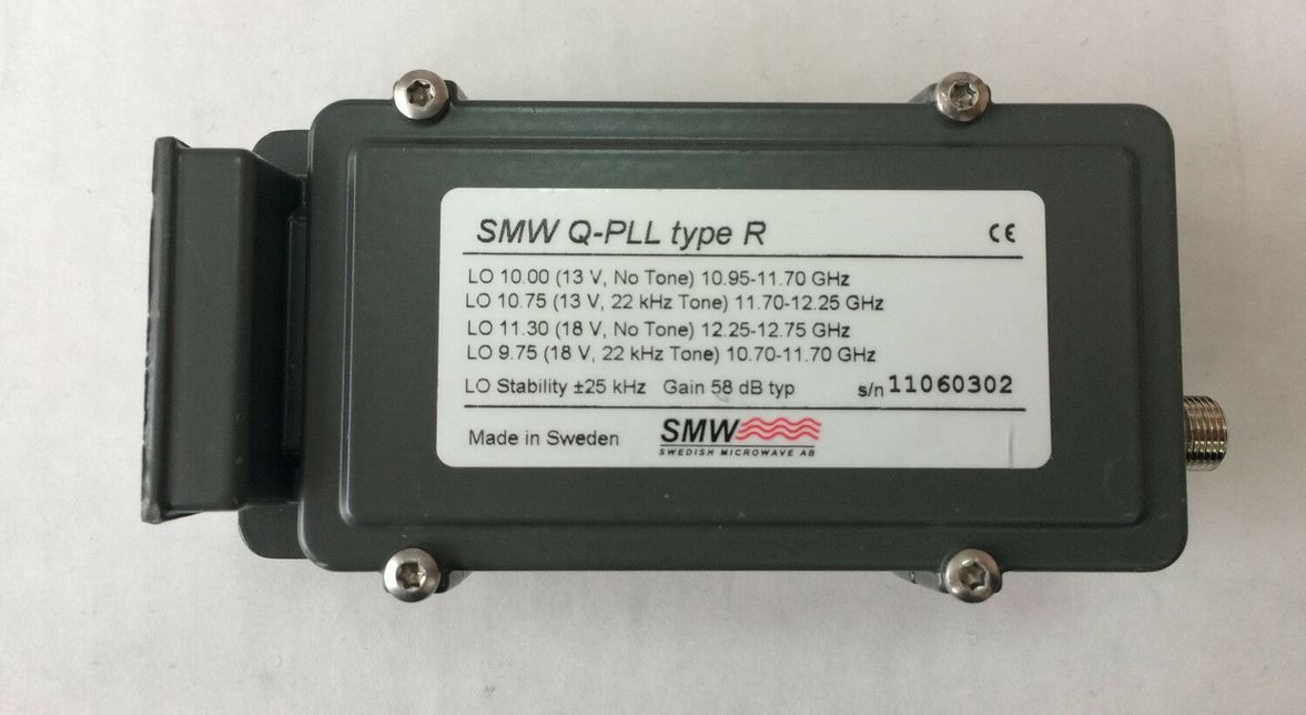

sub101uk SatelliteGuys Family Original poster Apr 1, 2020 53 21 london Jul 28, 2020 #1 I was wonder if any one on this forum knows the the LNB settings are to use a SMW Type R. LNB with a Technomate TM-5402 Many Thanks Attachments Ser 11060302 SMW.JPG 81.8 KB · Views: 289

C c-spand SatelliteGuys Pro Feb 25, 2019 1,404 846 USA Jul 28, 2020 #2 Looks to be universal band. 10,700-12,750
M Magic Static SatelliteGuys Master Lifetime Supporter Oct 12, 2010 7,498 4,854 Montana Jul 29, 2020 #3 That appears to be a single polarity LNB that is capable of four frequency ranges depending on the LO that's used and the voltage applied to the LNB and 22KHZ. A special purpose LNB. Reactions: a33 and KE4EST
