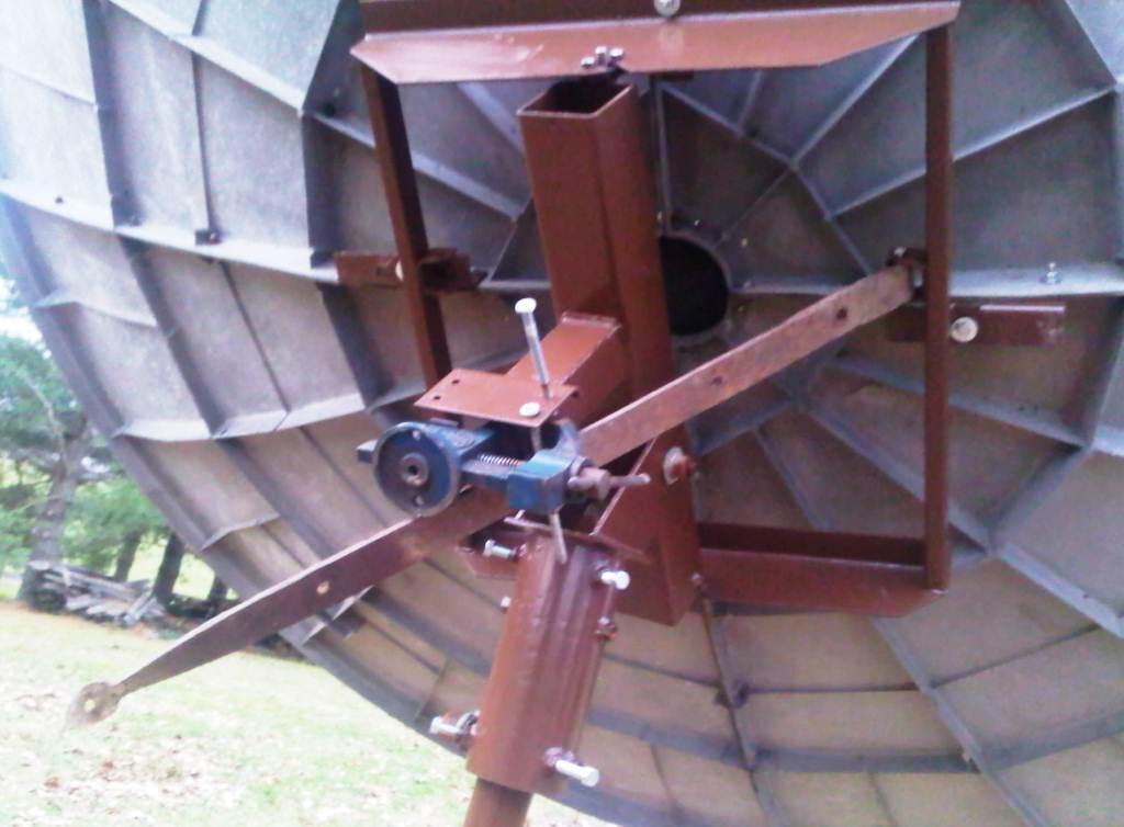

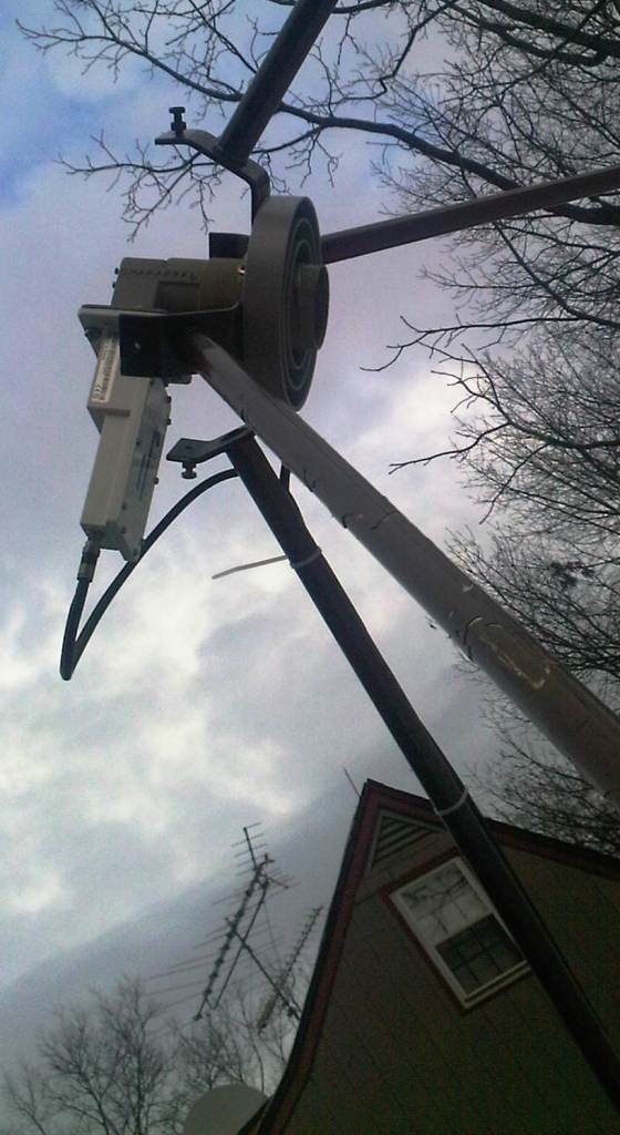

Now don't laugh too hard as I now have a fixed dish on 99W for the winter and can pick up EScapes (DVB-S2) with no problems.I decided to wait until spring to purchase and install the motor.
Some Pix.

WOW! When someone gives you advice you use a'vise literally! :D
That sure does look like Minnesodie handy work to me! :eek:
Congrats!
Great looking dish, nice job!
