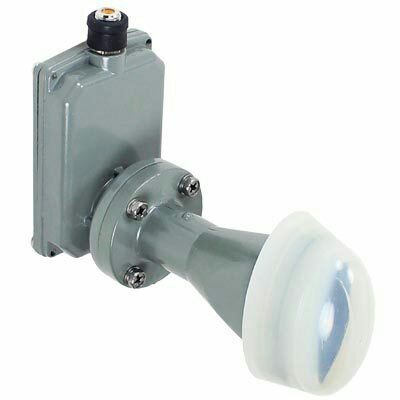

Yep, the WD service at 95W uses this, a standard 11.7-12.2 GHz Ku-band linear (Horiz pol.) LNBF.
L.O. 10.750 GHz.
Always interesting how the longer dimension of the feedhorn-waveguide assembly of a linear LNBF is at right angles to the electrical polarization it receives. Therefore, in this case the pointiness is on the longer vertical part of the shape, yet the wavefront it receives is horizontal or in line with the shorter part of the shape.
