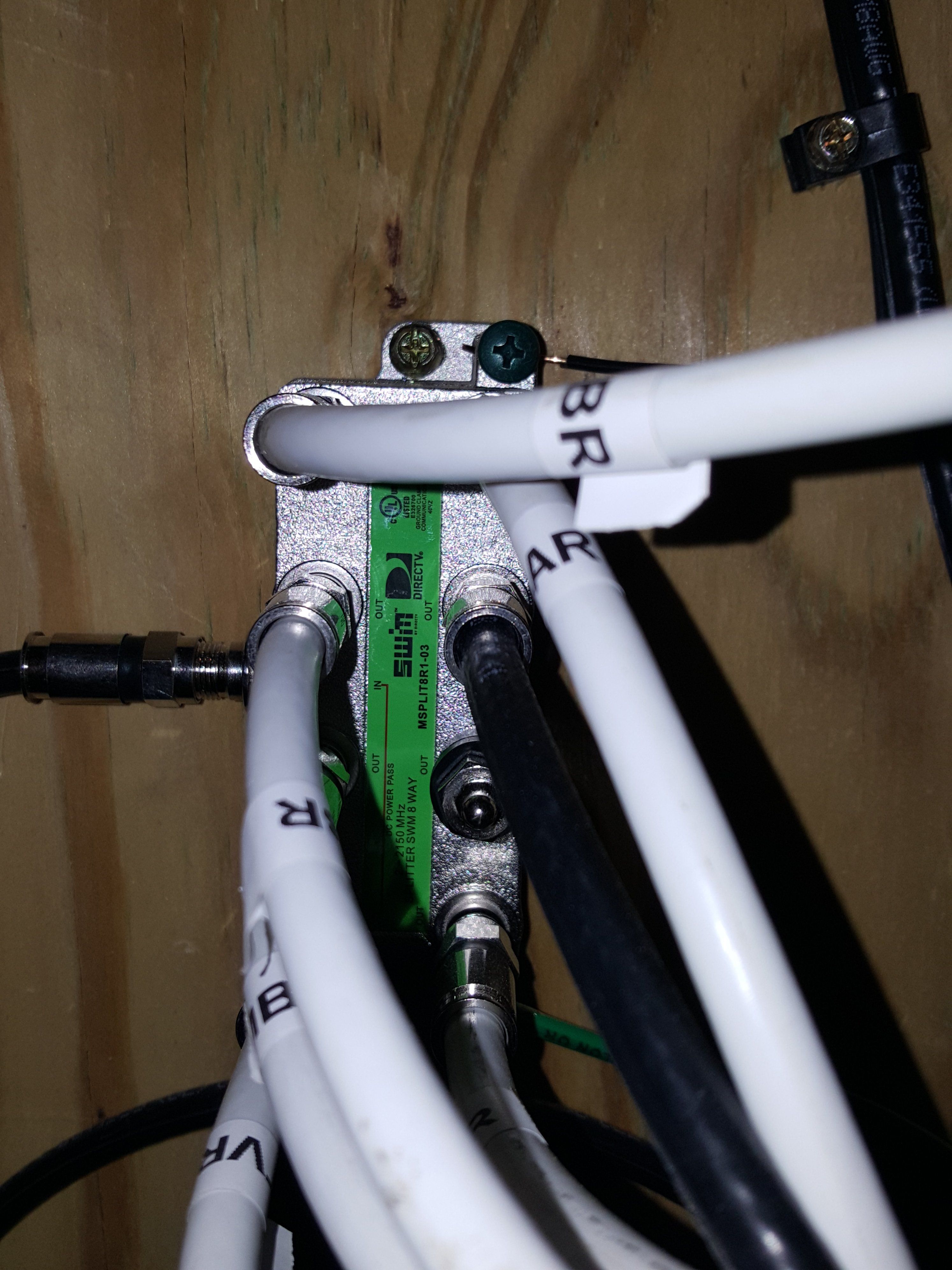

I was able to snag one of the reverse band lnbs from the ebay seller but is hasn't arrived yet. I have the HR54, 2 regular clients, the 4k client, and an HR24. Last night I had to reboot the HR54 and had no signal on the HR24 until it rebooted. I would also like to incorporate the 29v power inserter into my system so I don't loose signal to the HR24 but am not sure what way would work the best. What is the best way for me to incorporate the power inserter so I don't loose signal on the HR24?

Move the line from the power passing output of your splitter to an open port and install the power inserter to that port. You will need to run coax to the location you install it. I recommend the basement.

What you are saying makes sense to me if you have a SWM-16, with the third port solely dedicated for power output only, but there is no open port if you are using a SWM-13 or 21 tuner SWM-3(reverse band/non-reverse band) to a single 8-way splitter, there is only the power pass through port on the 8 way splitter. Are you saying run the single line to a 2-way splitter, then from the power pass through, run a line for the 21v/29v PI, & then from the other port on the 2 way splitter, run a cable to your 8 way splitter?
