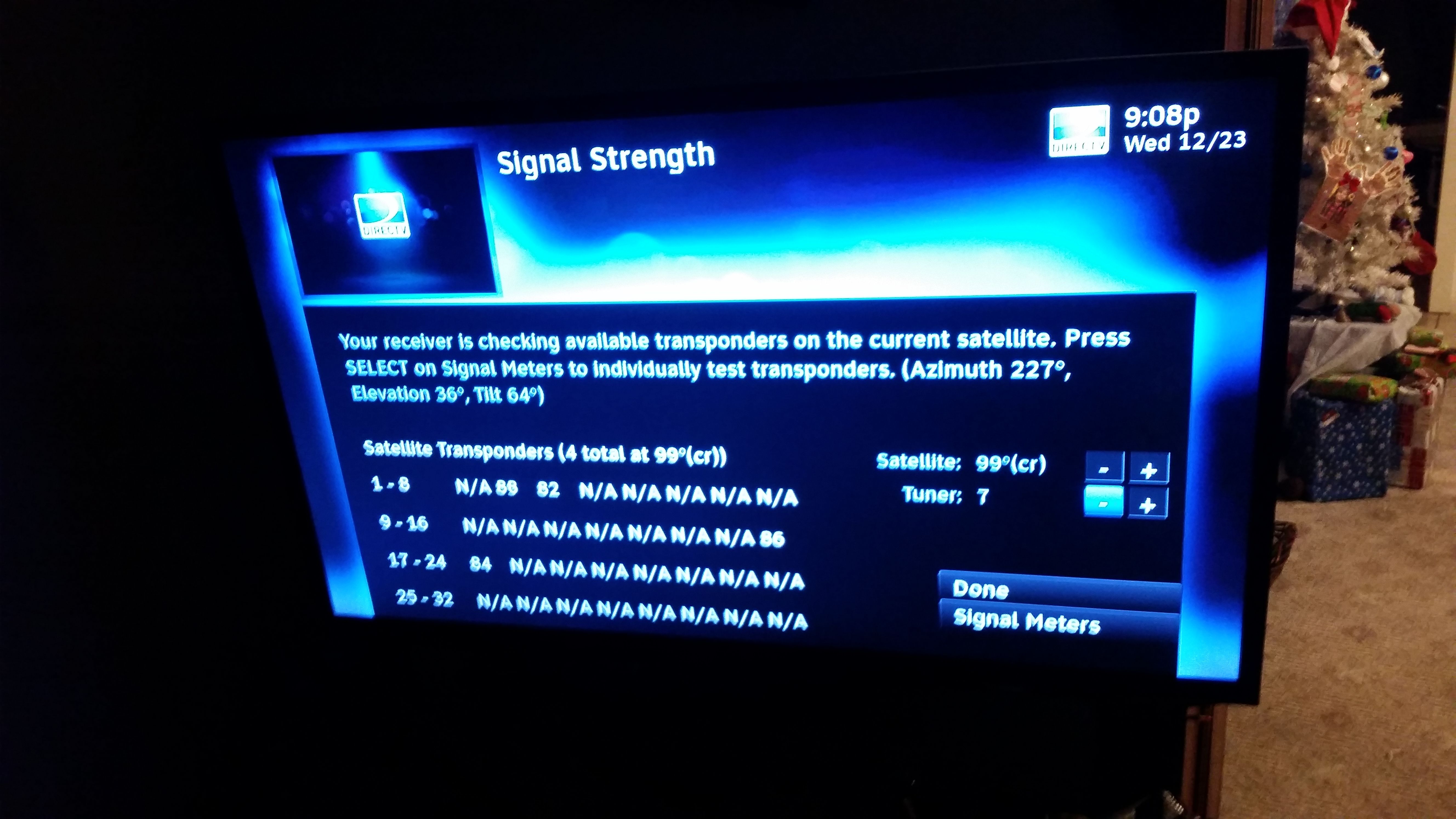

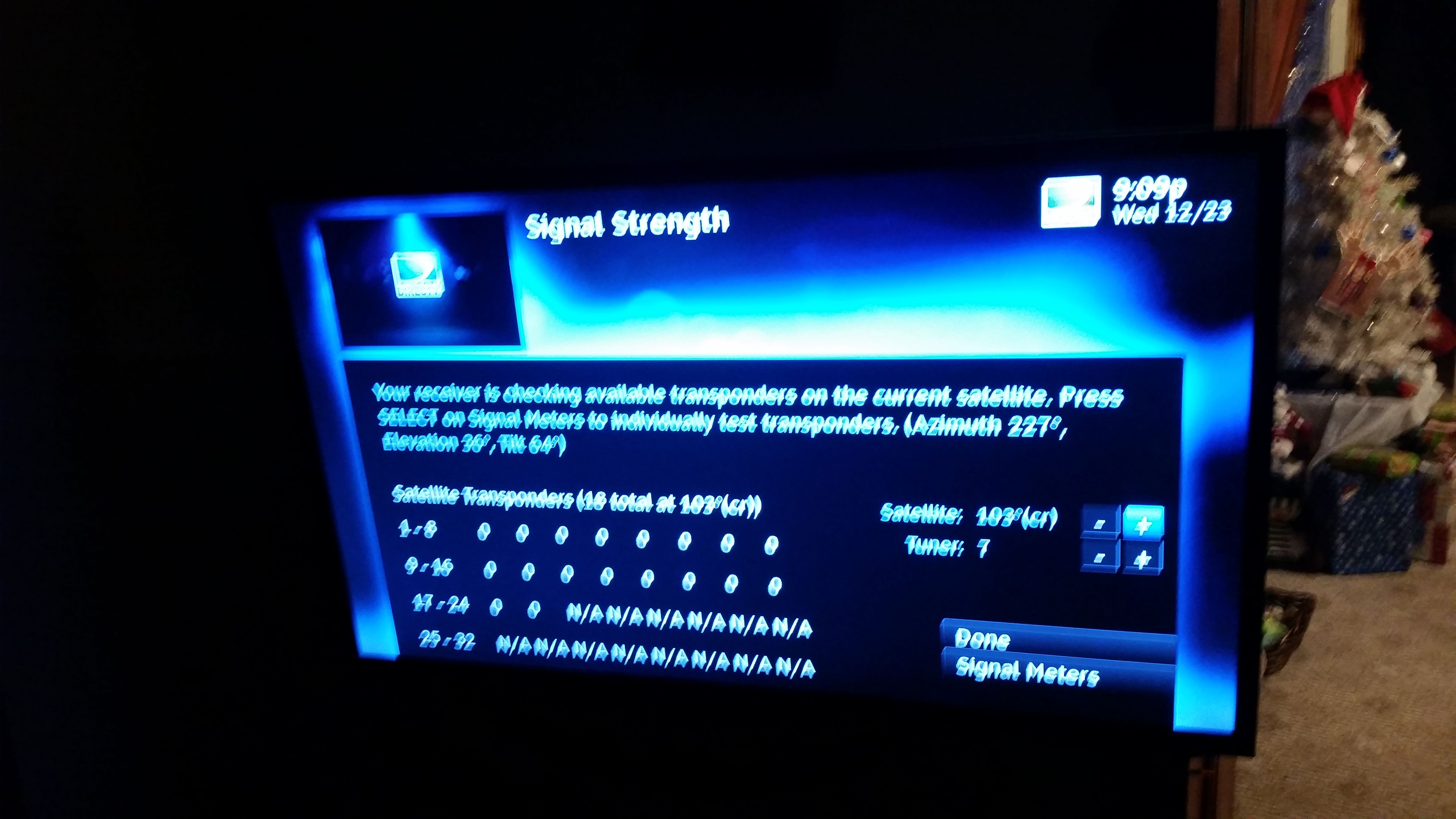

103cr is apparently not live and 99cr comes across weak. Passed EIV with no issues however..

Makes sense, I honestly forgot about that. But I'm still suppressed the 99cr is in the 80s

Here in TX signals similar to twizd3dkitty: 103cr all zero/NA, 99cr shows TP2 at 83, TP3 at 87, TP16 at 85, TP17 at 89. This is on my HR54, with the system running 19 tuners.

For interest, I added an HR20 running 0x9e3 from early December (this had been pushed as a new NR at that time). Went through startup and to live TV without any issues. This was tuners 20 and 21. Signal strengths all OK, no 99cr or 103cr of course.

... Signal strengths all OK, no 99cr or 103cr of course.
Dish type is automatically set to the 3LNB reverse band so that must have been in the firmware some time ago.
Oh, ... didn't know the HR20 couldn't see the Reverse Band signal screens 99(cr) and 103(cr).
