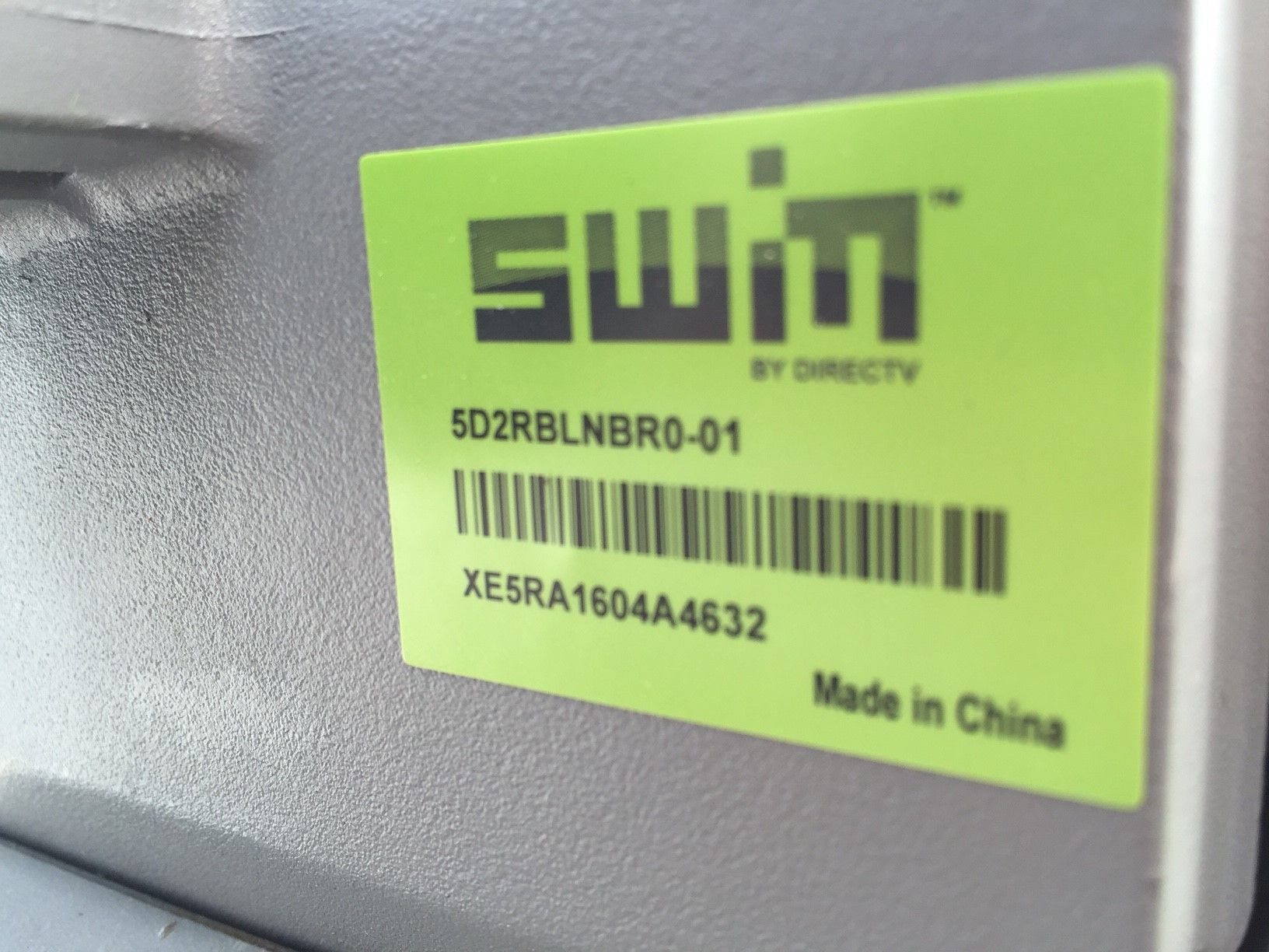

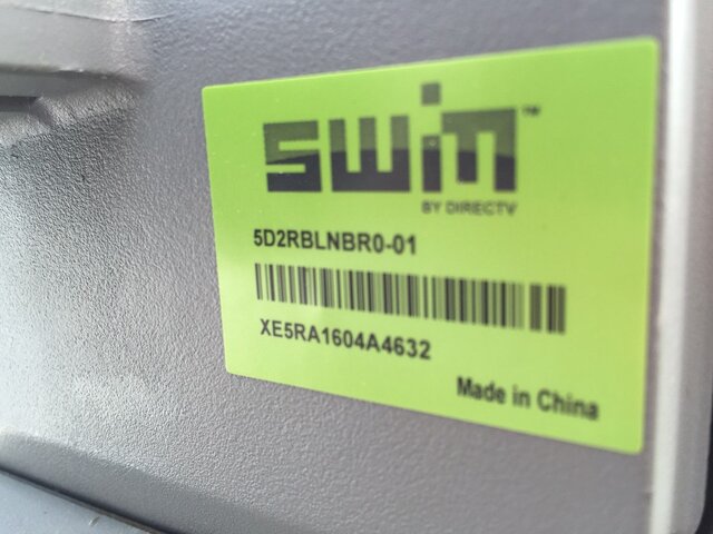

What is the complete part number?
Reactions: whitewolf8214

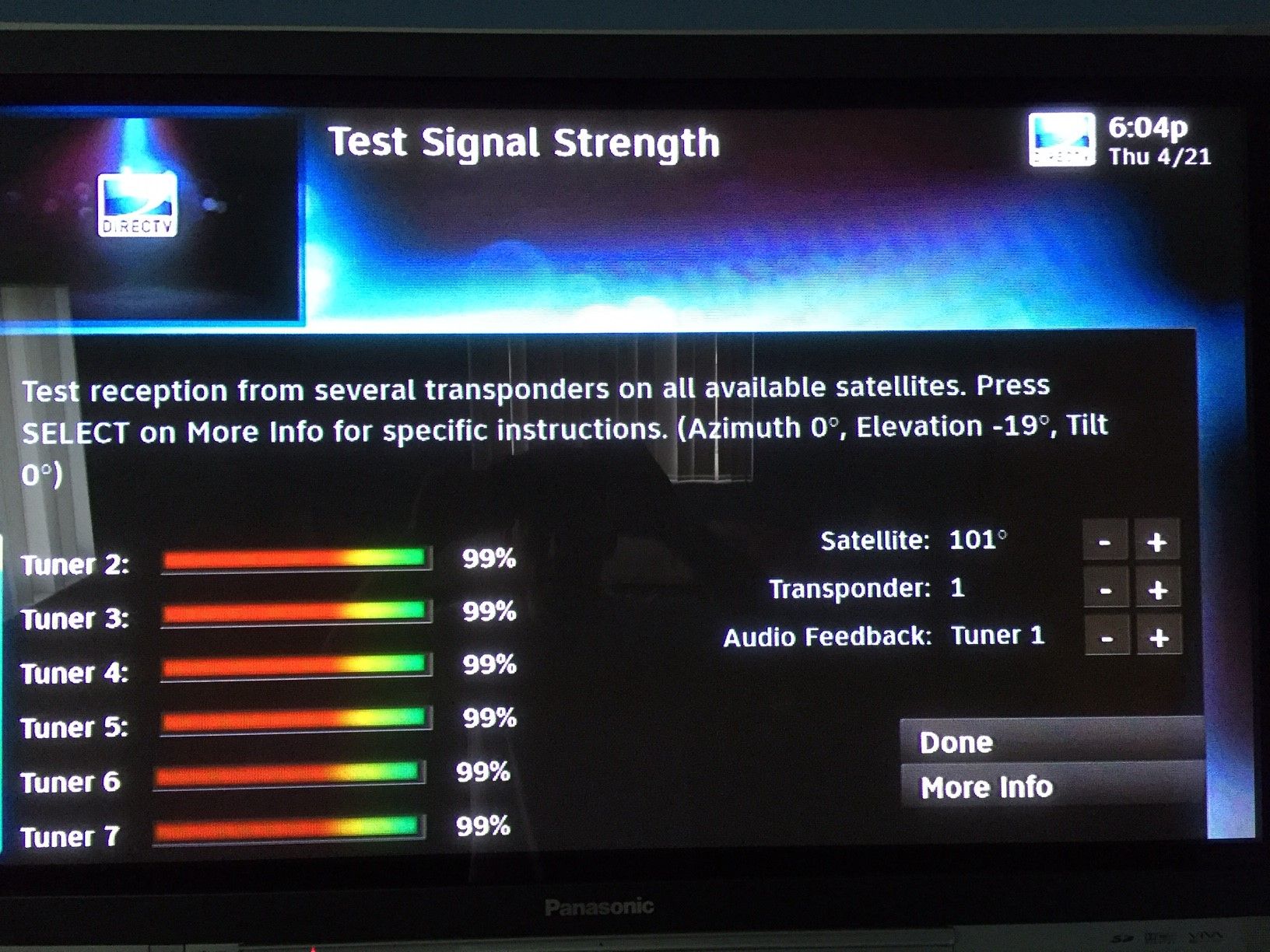

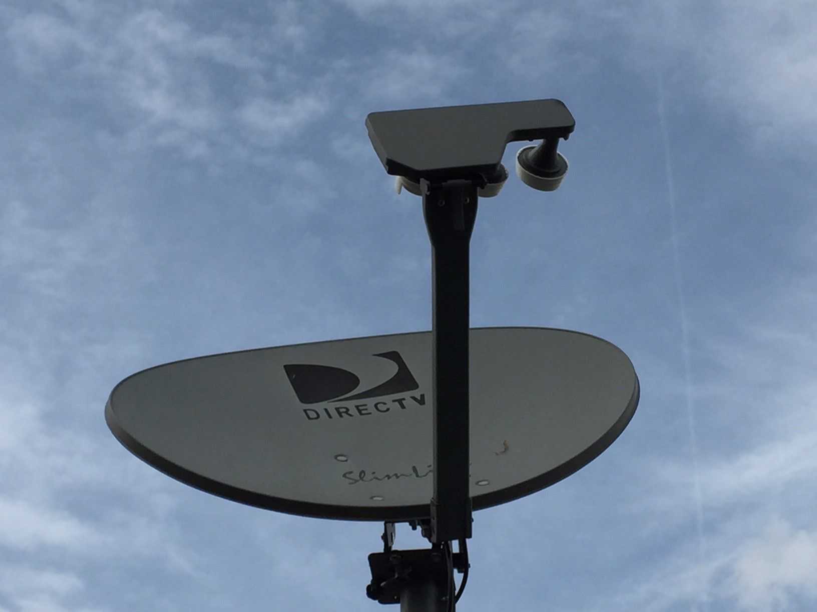

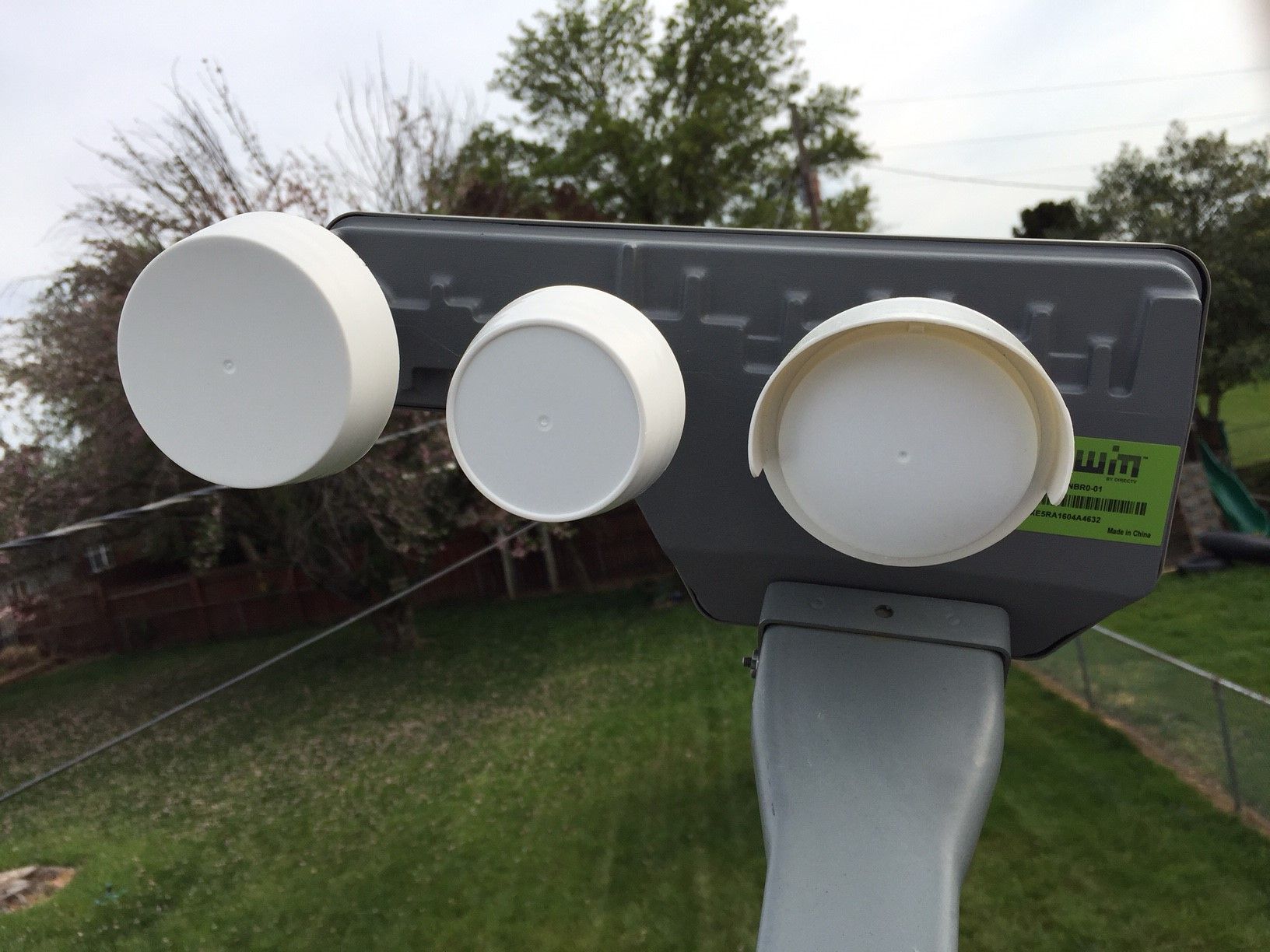

Ok, hopefully this is what you guys are looking for.
Install was completed on an existing Slimline 5 connected to a SWiM 16 switch via 4 coax. We are now down to 1 coax and a 1x8 splitter with a power inserter.
Equipment includes:
HR54-500
C61K-700
HR24-500
H25
H24
Satellite setup needed to be run on all receivers. Here are some pics for you all. If you want to know anything else, just ask and I'll do my best to get you an answer.
