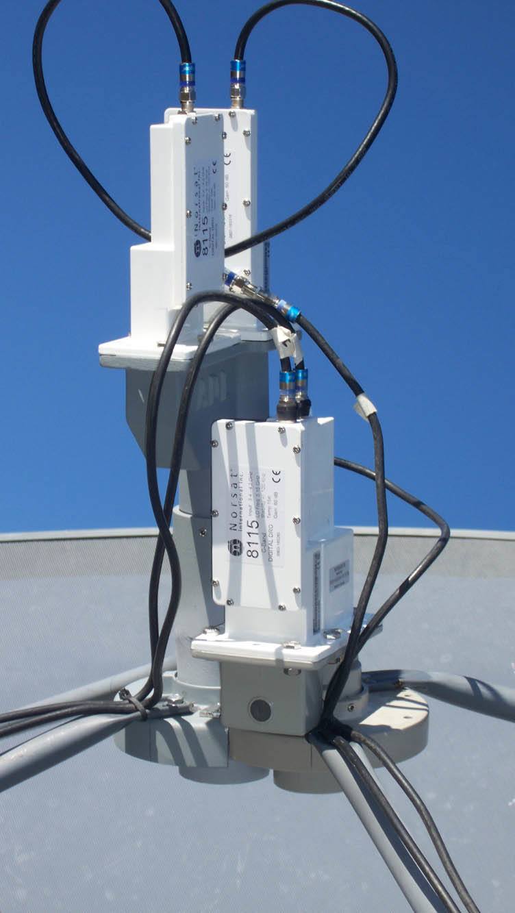

In terms of heavy, take this feed package and add something like ADL's circular C-band ortho with another two Norsats. The ADL feed seems like a country mile long with the LNBs. I put both of these up together on my 10' Winegard. Fortunately the support arms are pretty strong. The little feed in the picture is the single linear ortho. Love those orthos.
I use this same Chaparral feedhorn and Norsat LNBs on both my C band dishes. I use dual feedlines and these feedhorns and LNBs work like tanks. Best possible signal. I use Norsat 8515 and 8115 LNBs and I love them.
What is the model number of the C-Band only Dual Chaparral Feed Horn?
It is a 1329, just look on Chaparral's website at the dual feeds. I have one with two Norsat 8115's, excellent performance on a 7.5' SAMI.
