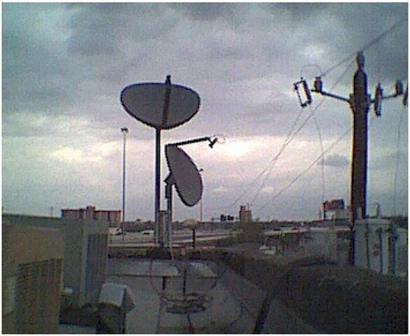

If you mount the dish inverted, you should be able to hit the horizon without any problem.
It may require a strategic hole in the mount or J-pole , but nothing more.

Below is a picture of a regular dish on the left, and one inverted on the right.

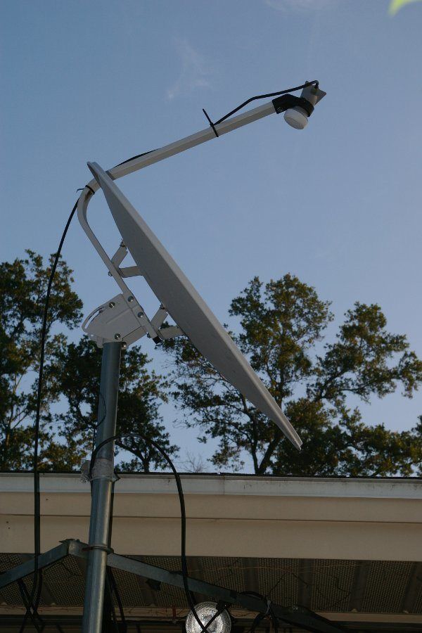

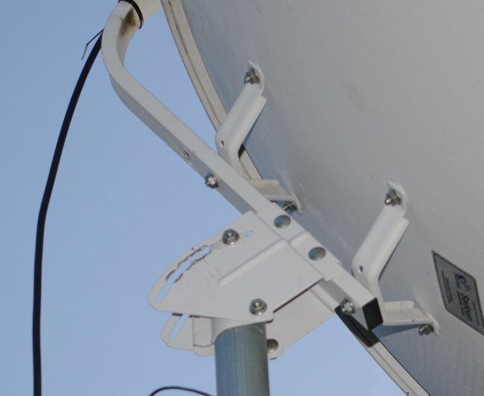

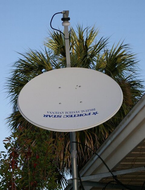

Hi Crackt and the group, here are three pictures of the Fortec 80 CM I have on Telstar 12. The Fortec mount works very well inverted and can go much lower then the 12 degrees I needed for T-12.
The close up of the mount might help you get an idea of where to set the elevation.
Hope this helps, DC
Hope this helps, DC
it helped a ton... thanks for the visuals. im going to use a fortec 36". i need 3 degrees. im probly not going to hit 30w but i wont know until i try.
Hope this helps, DC
wow after looking at these pictures again i think i had to many chemicals when i was attempting to aim my inverted dish. if i read right your aimed at 12 degrees there d_c?

Hi Crackt and the group, inverting the dish does not change the skew; however, you will need a lot of skew to hit a satellite at 3 degrees elevation. I'm at 60 degrees to get T-12.
Hope this helps, DC
