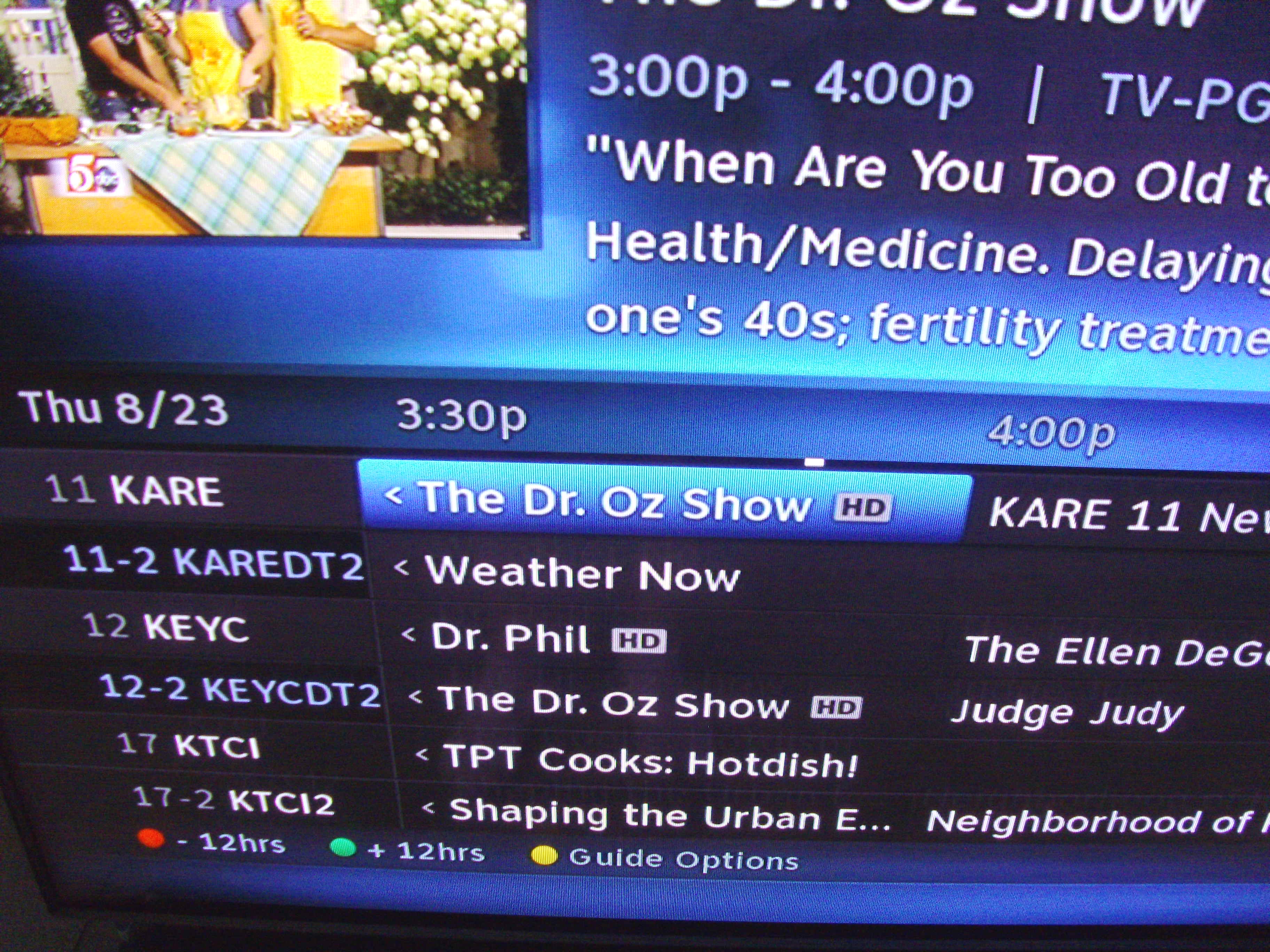

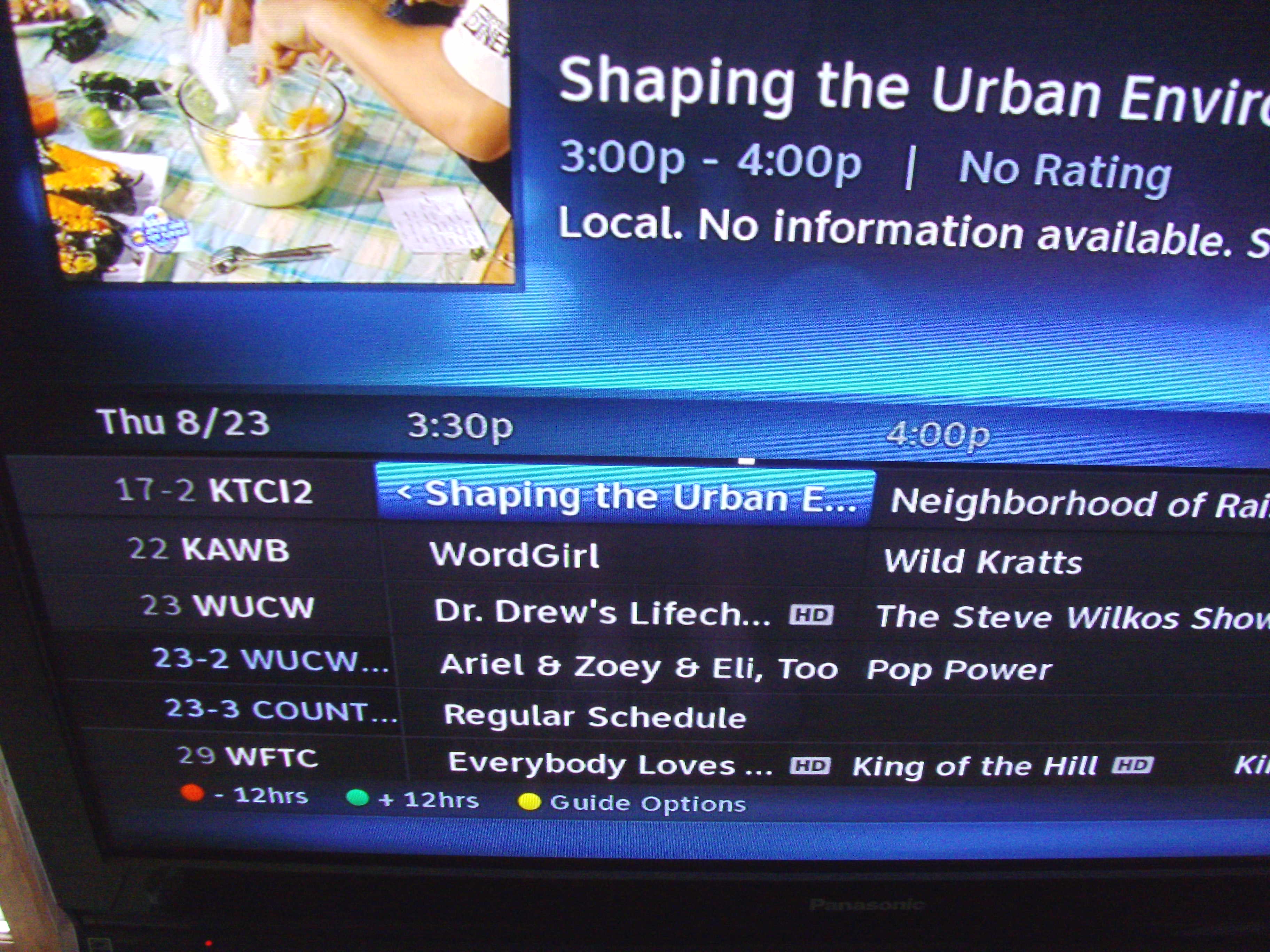

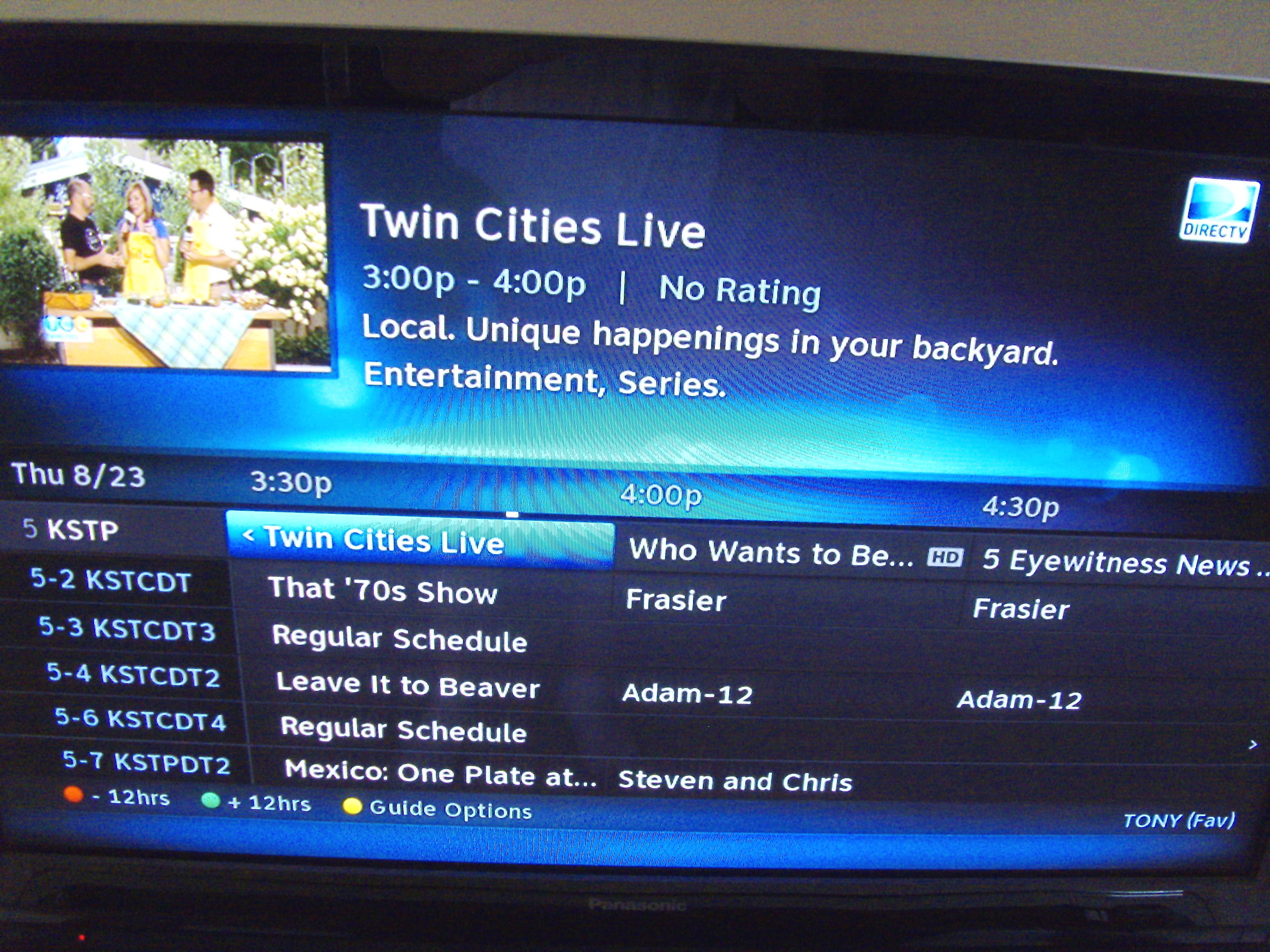

Here is what mine looks like. I have only a few stations being used via the AM21 since most of our stations are in HD ;)
I have the 5's (5-2,5-3,5-4,5-6,5-7), 11-2, 12-2 (I can get KEYC from my house in SW suburbs), 23-2, 23-3 and 41-1,41-2,41-3 in the guide.
As you can see I get guide info for 5-2, 5-4 and 5-7. Your friend with the HR24 can only see those in his guide and not 5-3 & 5-6 too.

Holy crap, thats alot of subchannles for one channel to have. The picture quality has to suffer greatly.
nope. Its actually 2 stations merged together.
KSTP (ABC) and KSTC (independent) are owned by same folks (Hubbard...they started USSB back in the day)
KSTP is on RF35
KSTC is on RF45
They use to be separate but they decided to merge the PSIP together
so the setup is like this
5-1 KSTP ABC (RF35)
5-2 KSTC IND (RF45)
5-3 MeTV (RF45)
5-4 ANtennaTV (RF45)
5-6 ThisTV (RF45)
5-7 LiveWell (RF35)
so its 1 720p and 1 480i on one station and 1 720p and 3 480i on the other. Our PBS is like that too. 2-1, 2-2 & 2-4 are off one RF station and 2-3 is off another

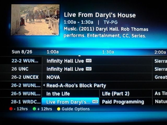

What does it do with incorrect data? For example: Raleigh WLFL-2 is Country Network, but the AM21 calls it PBS. Would the HR34 say "regular programming" or the PBS? In fact, the whole PBS channel is messed up on the AM21. 0826120119.jpg
22-2 should be WLFL-DT2 The Country Network, certainly is not HD or PBS.
26 UNC (correct)
26-2 UNC-Kids (WUNL-DT2) is correct.
26-2 UNC-EX should be 26-3 (Directv provides this subchannel incorrectly numbered, but you can add it correctly OTA, but I do not receive this signal.)
26-5 should be 4-4 UNC-MX (it is a cable-only subchannel, but is available on Time Warner QAM on QAM 4-4 for those of us who care. You can't watch it on Directv, but at least I can see the guide info...)
WGHP 8-2 does not work with the AM21 (you can see the guide data, but they switched RF channels and never changed it for 8-2 in the stupid database, despite many calls and emails from viewers and WGHP's engineers) but people say it shows twice, one with "regular schedule" that you can watch and one with guide data.
