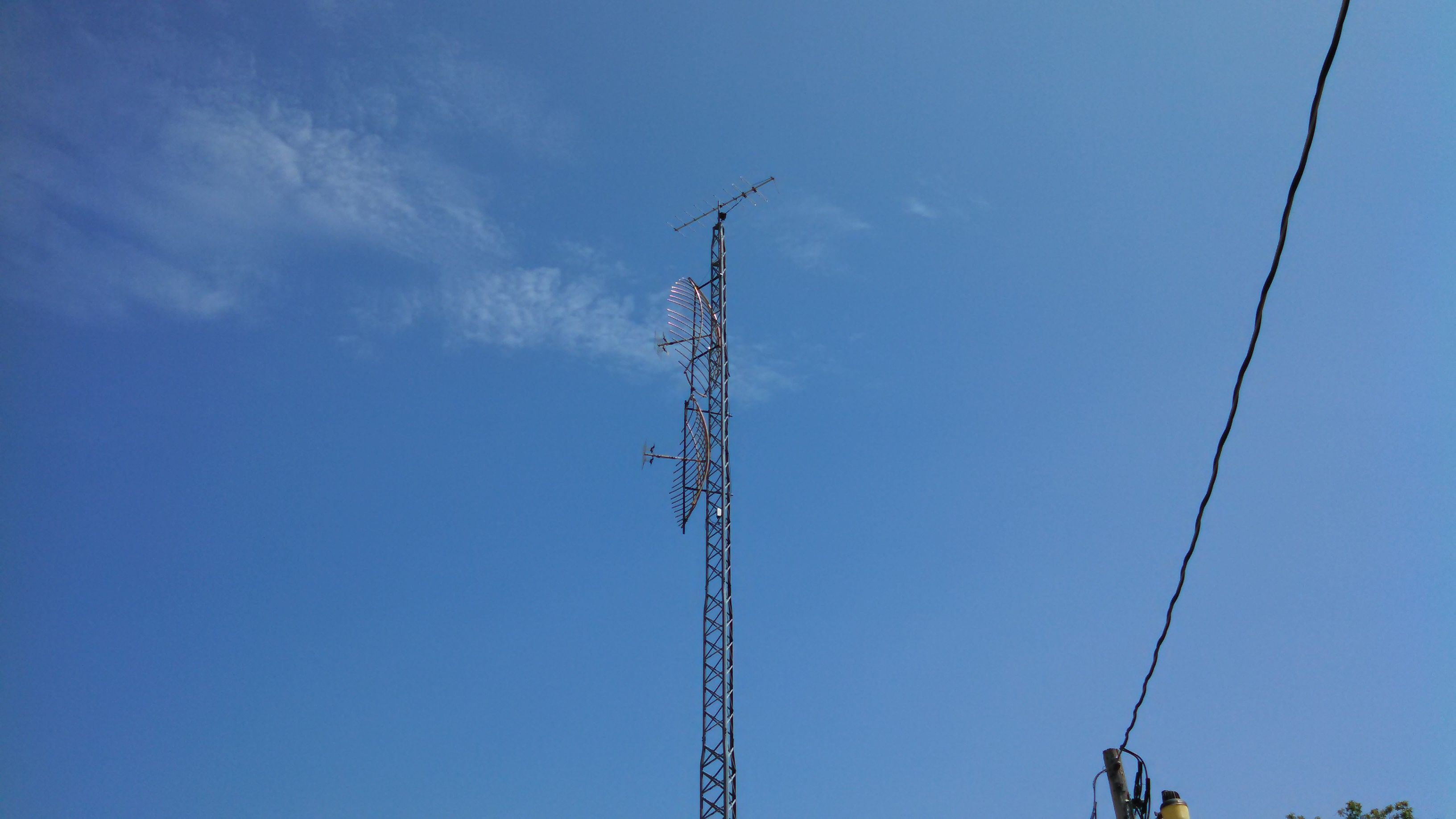

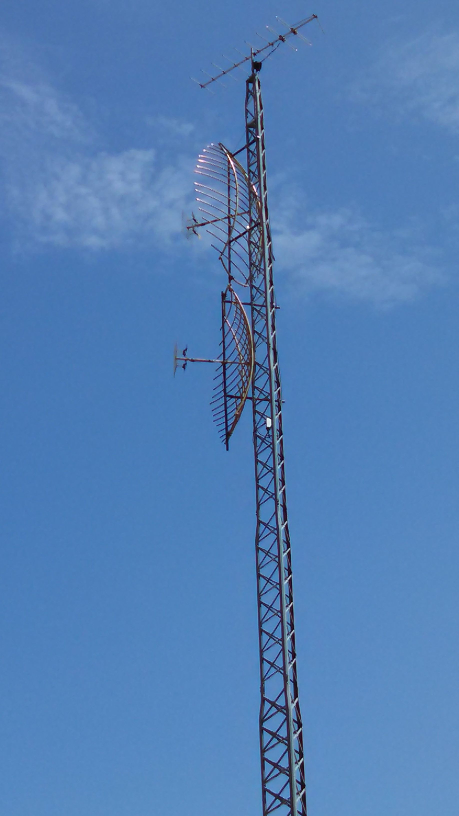

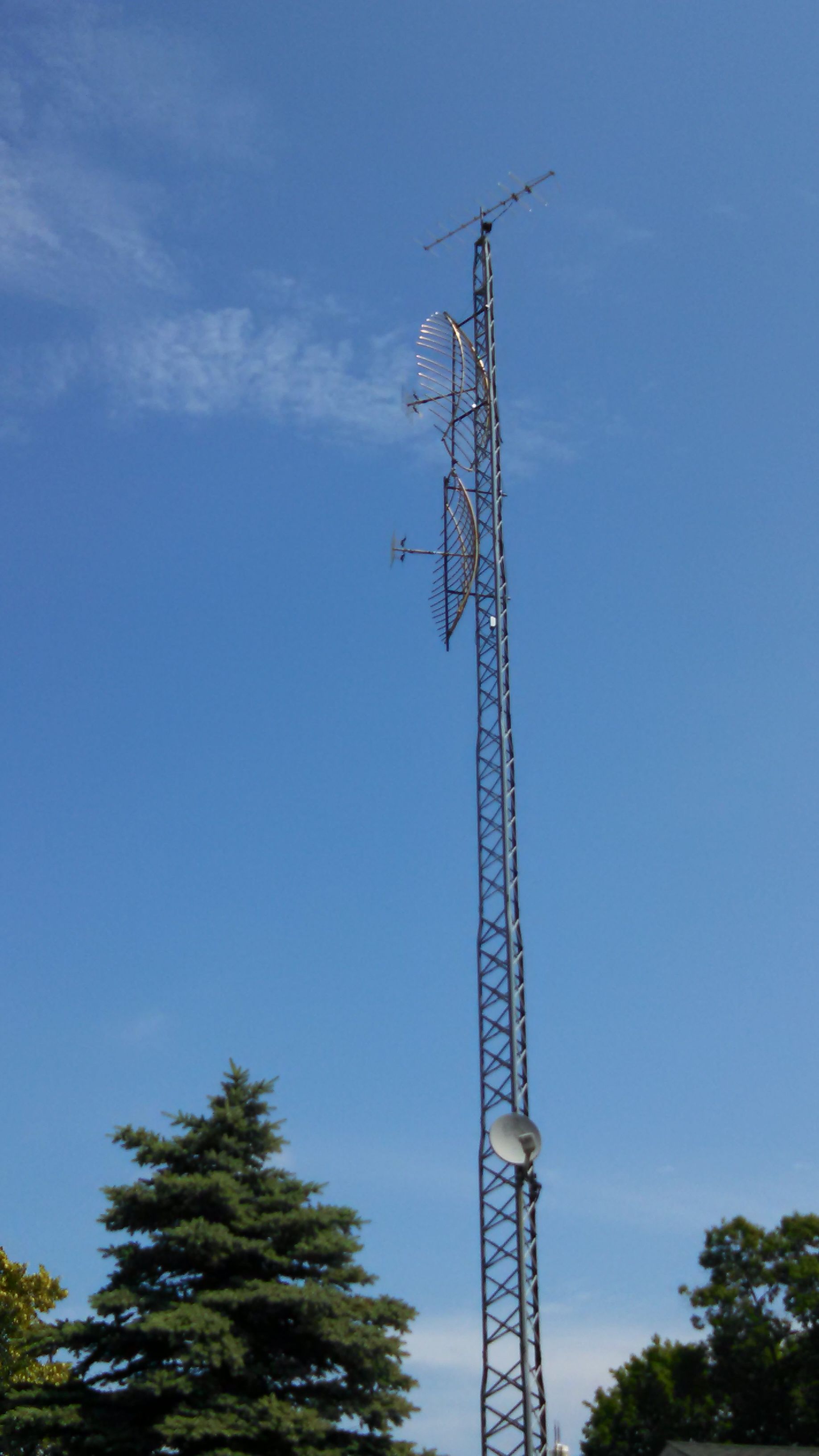

well there is a bar/motel/restaurant nearby (12 miles or so) who does it right
behold......2...yes TWO of the Channelmaster UHF parabola antennas...and a 10 element VHF one
(we'll give them a pass for the dish dish mounted up the tower)
I soooooo want one of those antennas

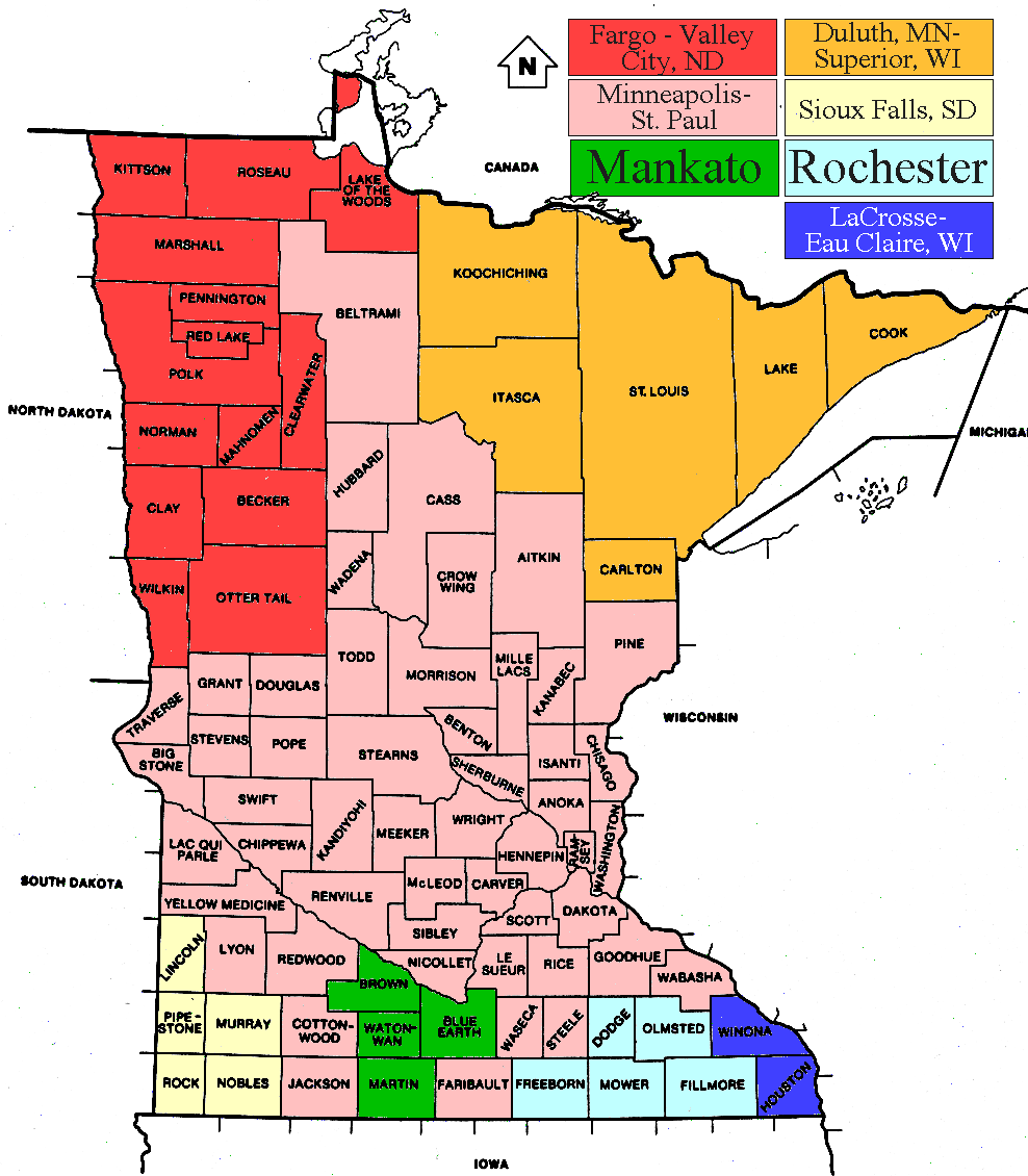

One thing to note is the Minneapolis market is GIGANTIC! It runs from the Iowa border almost to Canada. (click on the picture below) That has to do with WCCO (CBS O&O in Minneapolis) years ago (mid 80's) buying what was KCMT 7 and KNMT 12 (now KCCO and KCCW) and running them as satellite stations (they rebroadcast WCCO). So all of a sudden the other Minneapolis stations started putting up translator stations in northern and central Minnesota. But they were very low power and in specific spots so if you were say 15-20 miles away you needed them big badass antennas. Folks didnt use them to get DX stations. They used them to get local stations to pipe through their sportsbars, restaurants and hotels (this is before Dish and Directv). Tower systems are kinda the norm around here. My neighbor has one. We had a guide wire setup before the house burned down. It was an antenna probably 30 feet above the roofline of the house which was 2 stories.

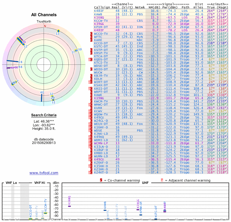

Where I live (and I've posted my tvfool report) I can get the following on a consistent basis
CBS 12 (KCCW) (subchannel Decades)....I wouldnt say consistent as I have a UHF only and they broadcast on RF12. It comes in "most of the time" and only if the antenna is facing SW or West
PBS 22 (KAWB) (5 subchannels)
ABC 16 (translator which is ANALOG!!)
FOX 26 (KMSP translator K48IF) but it is very hit and miss. It pumps out a whole 2800 watts and I'm 26 miles away (My and Movies! subchannel). At night it comes in stable..during the day no way
FOX 39 (KQDS Duluth translator K39GG....but again ANALOG...and the antenna has to be NW and its still real fuzzy)
ION 41 (KPXM). That one comes in almost all the time
As you can see I have minimal stations and I have a big 8 bay on the roof of the house with a pre-amp. While I can get Minneapolis at night with minimal blips (depending on weather) they don't come in during the day.

That's a cool setup ice. At first look I thought the two parabolas were setup as stacked. But upon further review they are facing in slightly different directions.
It does look like that. I assume (and I could be wrong) that is from the days when there were some translator stations for the "Big 3" from Duluth that were about 15 miles NE of Brainerd. So they had one dish at that and the other at Brainerd which had PBS, NBC, ABC
The idea of setting up a 7 foot antenna sounds daunting.
on a tower no less. I'm sure a cherry picker/boom lift was used ;)

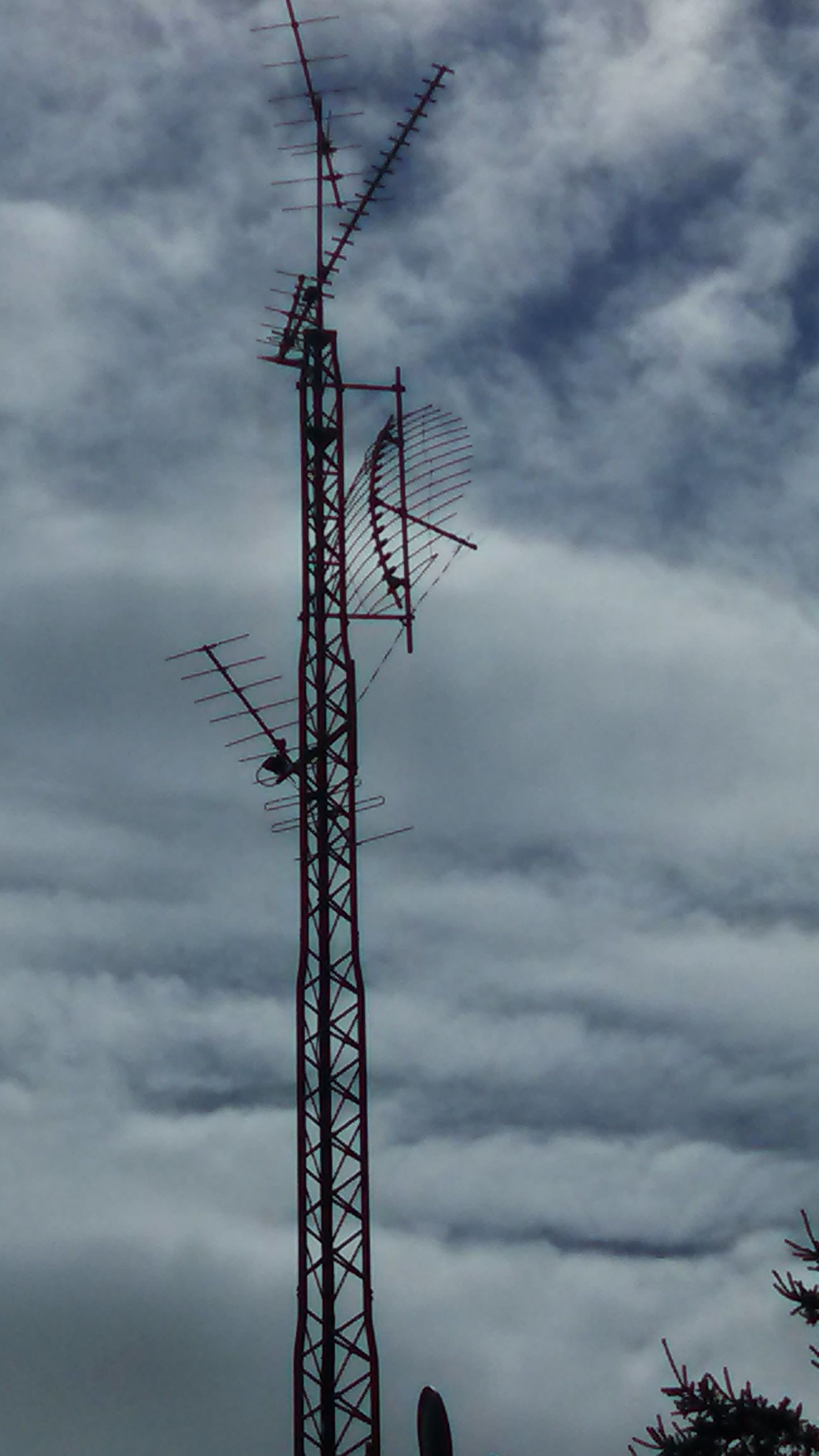

This is by an apartment complex in the same area. Note there is no cable company in the town (its only 200 people.....but home to the worlds smallest town McDonalds) ;)
