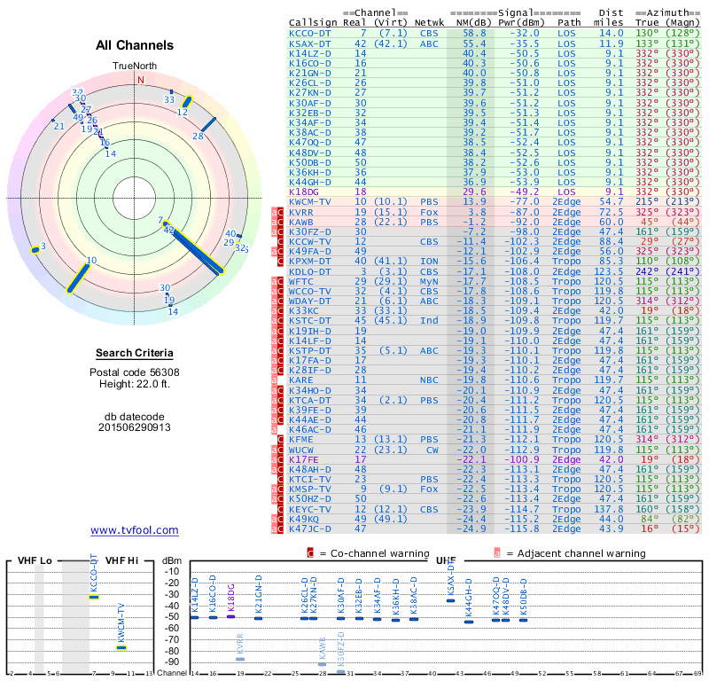

Iceburg is this your channel lineup too. I went to cajunfirst website clicked tv schedule put in Alexandria Minnesota zip and the translators had all kinds of goodies. The tv fool is at the bottom. All them in green is from KSTP, WCUW, and more.

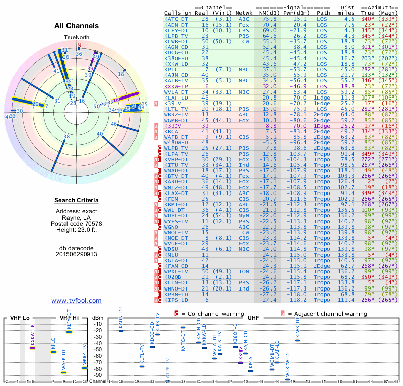

Here is mine. Now WBXH, WLFT and WBTR does not show up, they show up in the grey area at 110 Derby Lane which is 5/10ths of a mile up the road. Those 3 channels are between 65.8 and 72. 1 miles from my home. If they are in the grey will the 8 bay get them. KPBN shows up at the bottom. Oh and I suppose the station number below REAL is what i get on the vhf and on the 8 bay when set up
Nope. Alex is 70 miles away. I've posted my tvfool a few times including earlier in the thread. That is selective TV which has been around for decades. They take donations to keep it running. 100 bucks a year. 7 and 42 are not part of that. Those are owned by CBS (7) and Hubbard (42)
As noted on the tvfool site anything in grey is really hit and miss. Don't expect miracles. The first column of numbers on tvfool. Anything below zero is Not guaranteed you'll even get a picture.
Will you possibly get something? Maybe. But again don't expect mitacles
