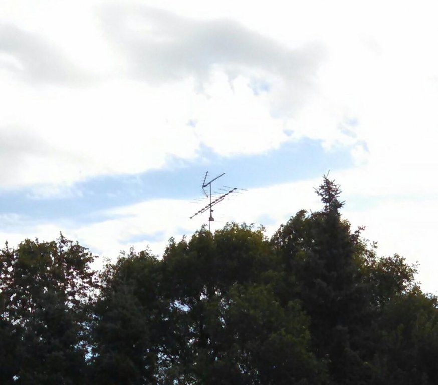

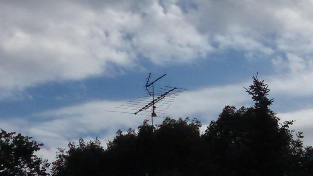

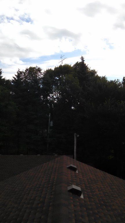

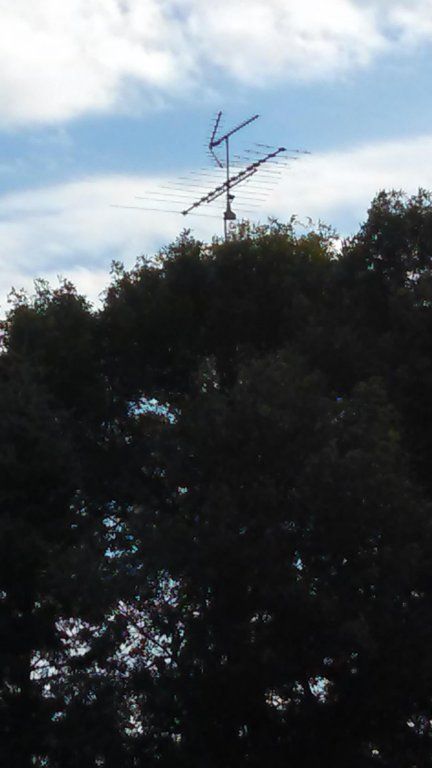

My next door neighbor has a tower system....some pics from the roof of my house
Funny thing is I know what stations she is watching just by which way the antenna is turned ;)
IMG_20150908_110323_109.jpg IMG_20150908_110323_109-1.jpg IMG_20150908_110329_438.jpg IMG_20150908_110335_336.jpg
