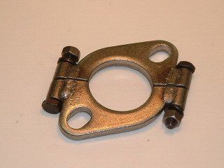

I think the clamp that Delta_Charlie is talking about is actually a split flange. Any decent automotive place will have them. Even crappy tire has them though you'll have to browse for yourself - they won't know what you're asking for. But then you probably already know that, just like everybody else.
They're about $5, and generally look like the attached pic. When doing exhaust systems, you usually need two to attach two pieces of pipe. One clamp on one pipe, second on the other and a gasket in between. Then stick some bolts between them and tighten em up. Voila - one pipe.
