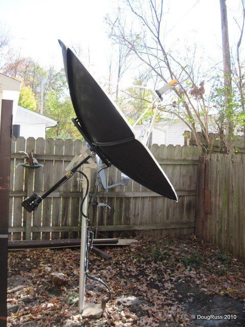

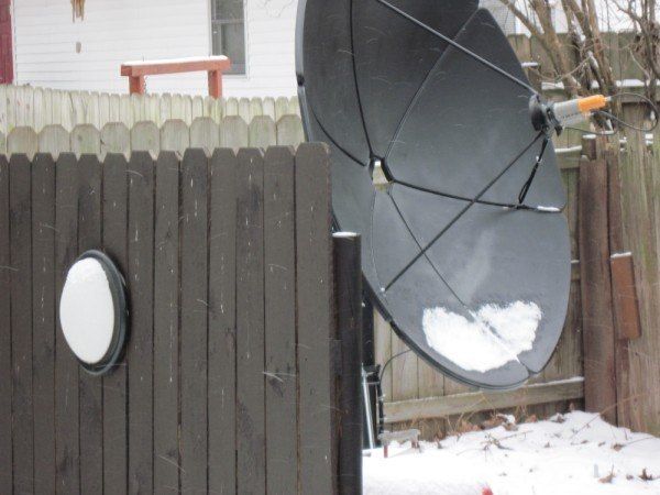

I lightly sanded the bad spots and took a Scotch-brite Pad over the whole Dish face. Then I shot it with a Primer and sprayed several coats of Rustoleum Satin Black. As a added measure, I used several cans of Spray-On "Rubberized Undercoating" on the Back of the Dish as well.
