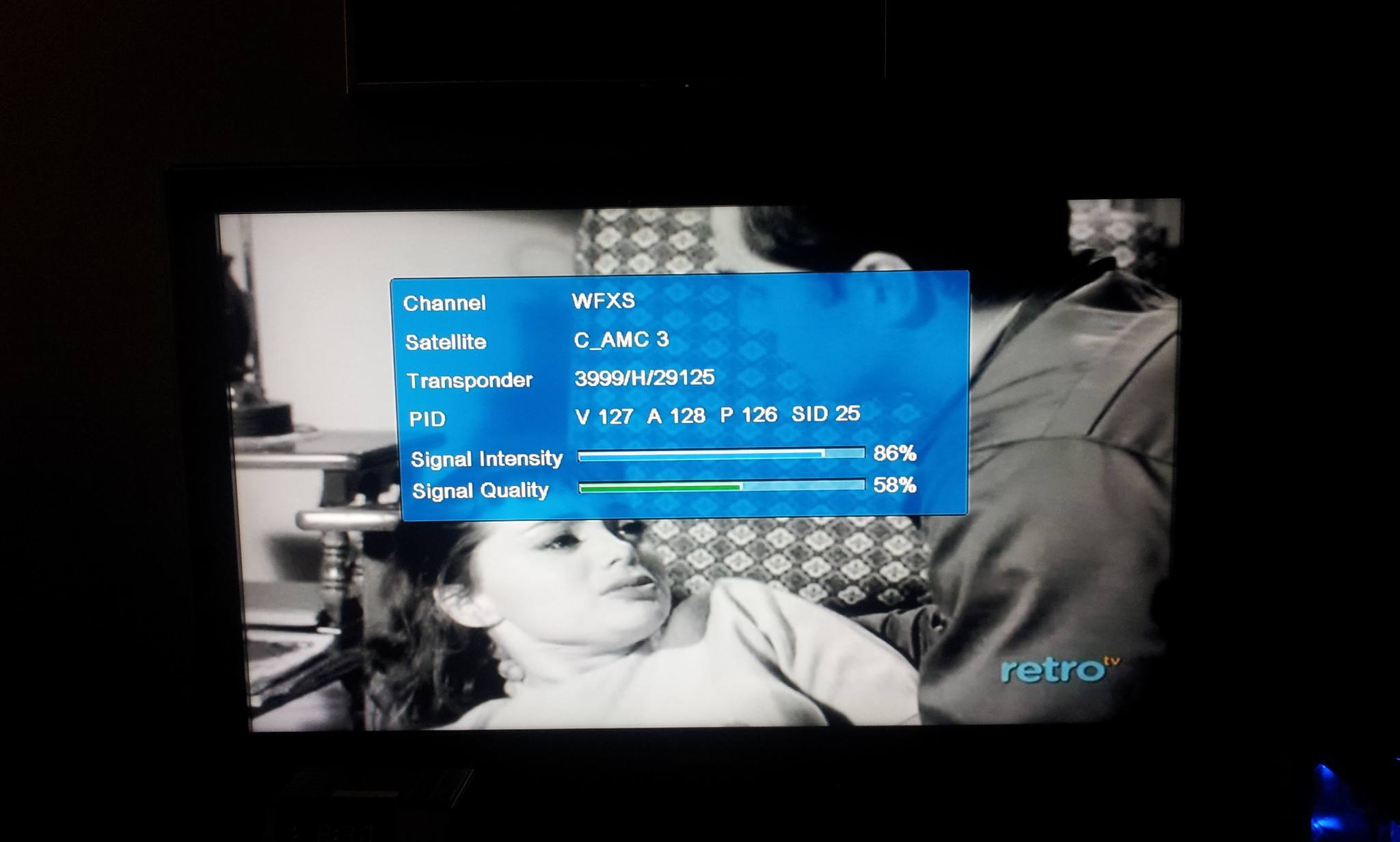

A rescan of the tp got me all the channels now.I cant figure why some of you guys and gals with the big buds cant get this tp while some like me with our small 6 footers can get it.I kind of like having a small Bud!:) it makes finding some of the harder TPs a challenge and more rewarding when i get a lock on them.heres a pic

You are probably located closer to the center (higher-power) of the satellite beam. That will bring up the signal by at least 2-3db, and that's the difference between a 6ft dish, and a 10ft dish.
