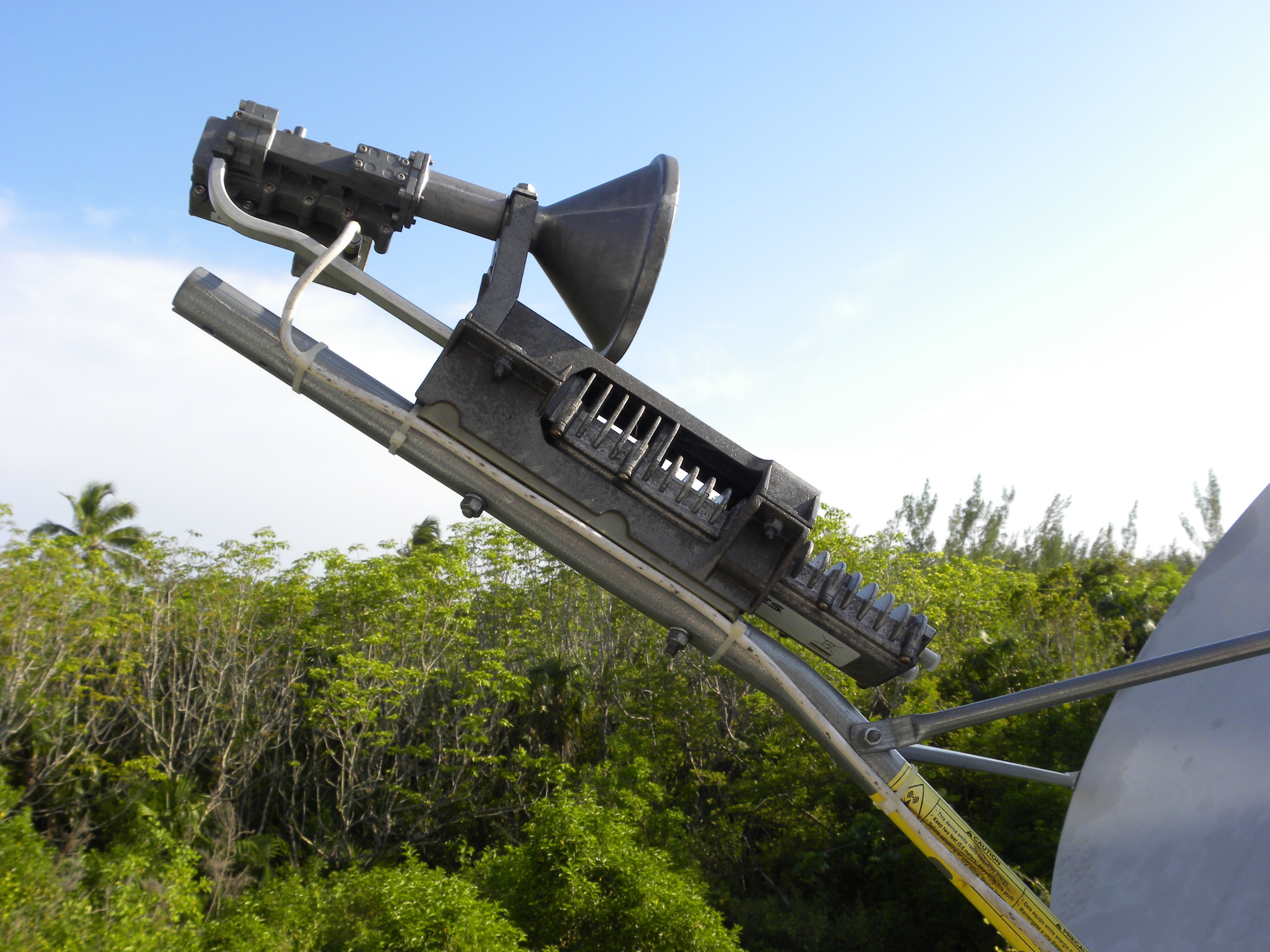

The LNB is most likely 10750 for the LO (local oscillator)
Problem though, it only receives one polarity, not both.

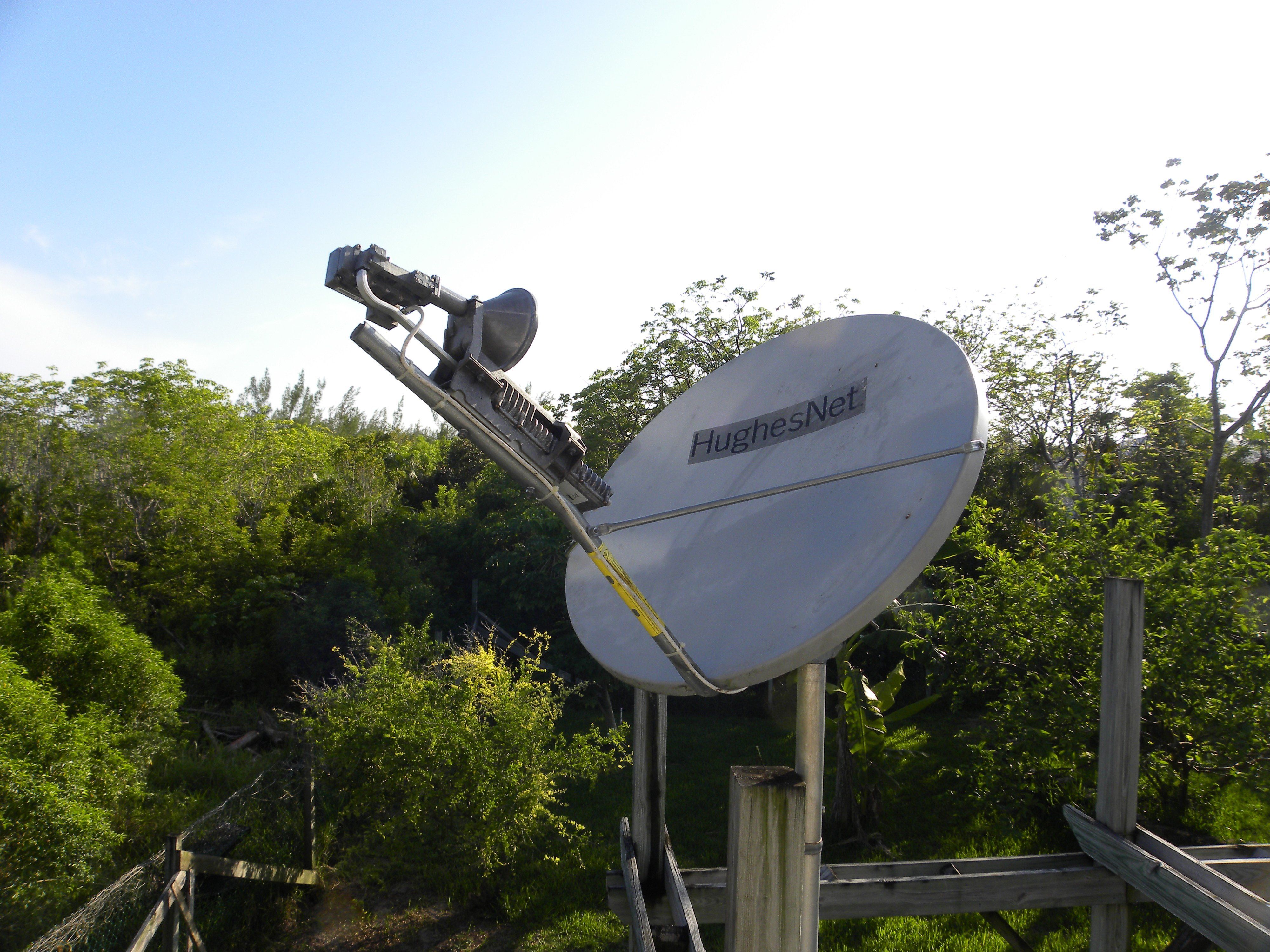

Thank you Anole. It's dark here now, I'll take a pick tomorrow and post, but I think you're right.
Pics
Here's my dish setup.
That's a real nice 1m dish, on a first rate mount.
Any setup meant to transmit, is top quality.
What other members have done with that assembly...
- Measure and record the exact location and angle of the feedhorn
- remove everything from the LNB support arm
- install a regular LNBF
...or...
- remount the original feedhorn, and...
- bolt a suitable LNB to it
There are pictures on the forum showing both ways.
