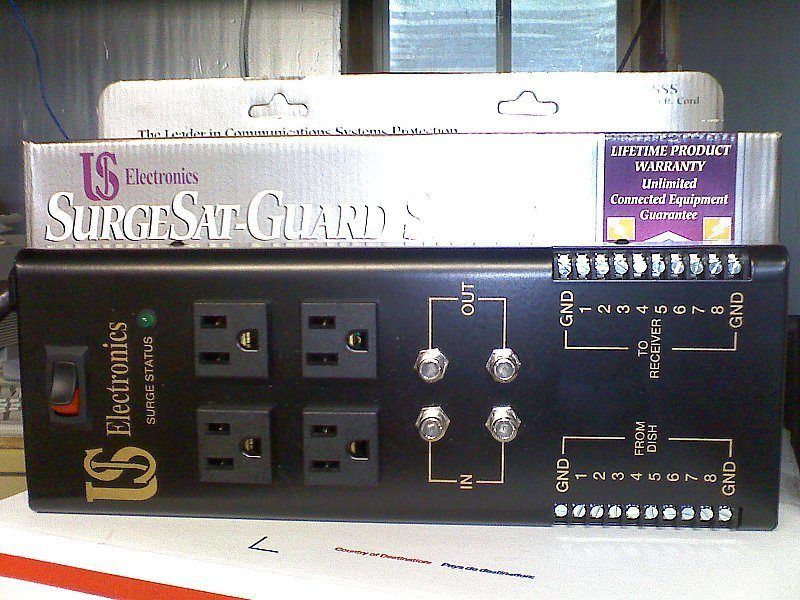

That is a problem, when I got start into this hobby I new this could be an issue with lighting and I found and purchased a case of a surge protectors sold by US Electronics that were made just for the big dishes. It's designed for the cable and also the control lines so everything is protected in more than one way.
