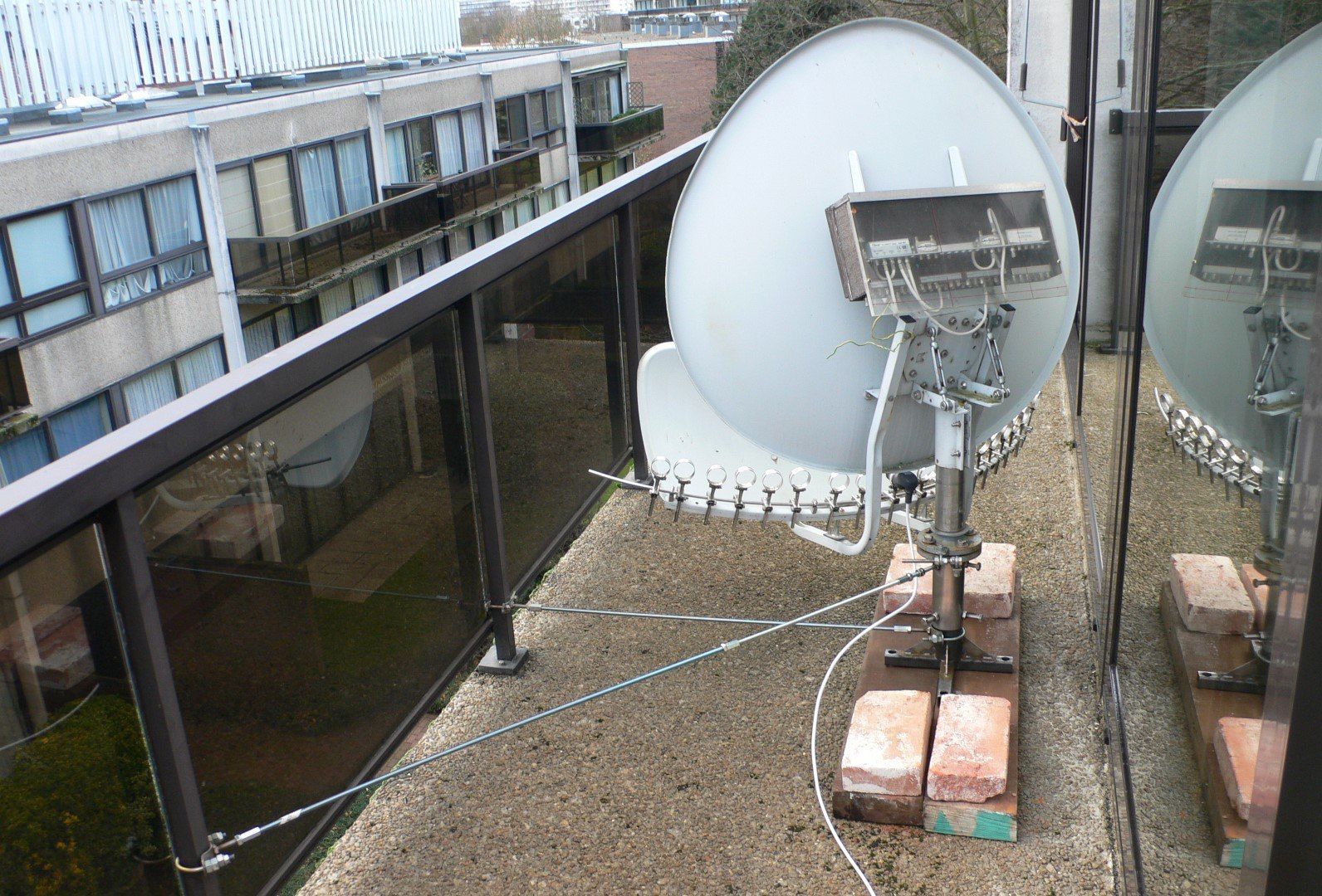

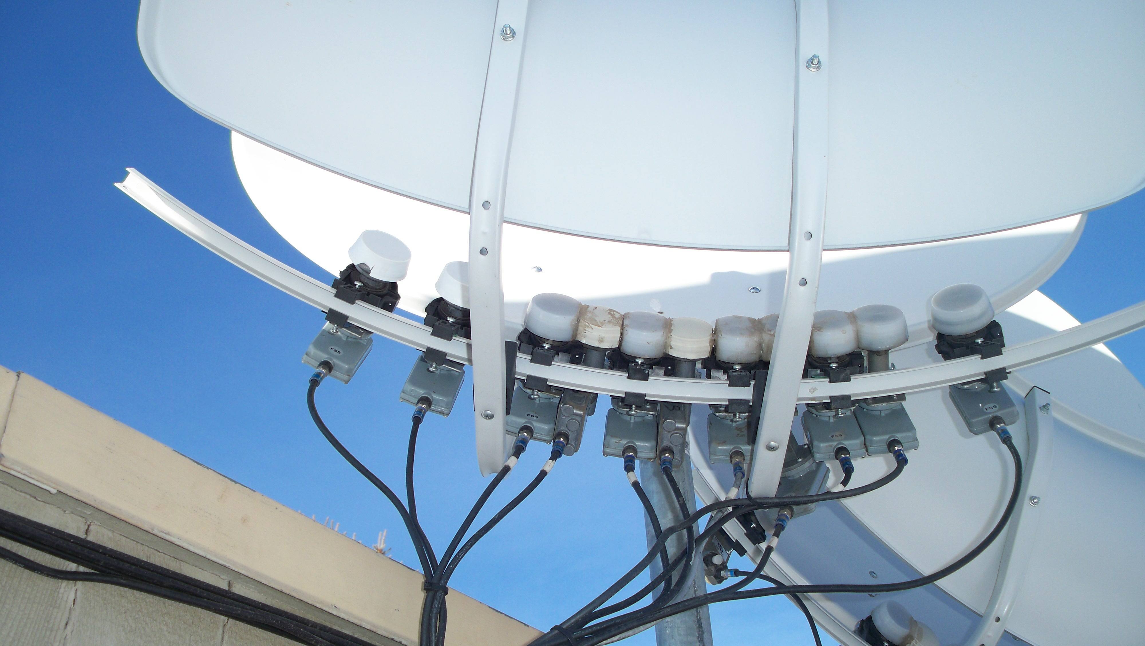

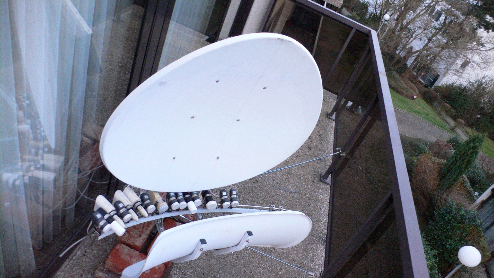

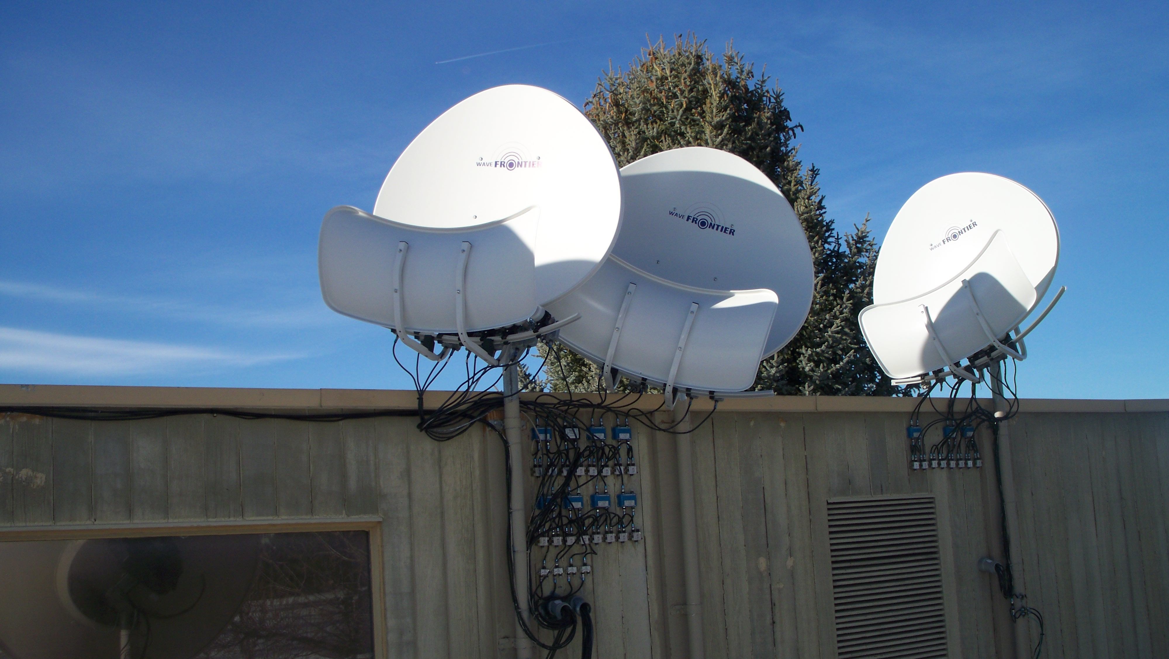

RimaNTSS - Your sensitivity measurements are stunningly close to mine. Science and engineering are great. I don't recall if I've posted anything before, but I've attached a photo of my toroid garden, along with another with detail of the LNBs on one of the toroids. This was a few years ago, but not a lot has changed.
Balock - I have no problems with DVB-S2 signals on any of my toroid LNBs. A 90 cm-equivalent dish is a decent threshold where one starts getting most of the FTA signals that are there. My understanding was the T55 was intended for the more powerful DBS birds. One minor point - while PLL LNBs are generally far more stable frequency-wise than ordinary LNBs, it is very common for them to suffer from higher phase noise. Unfortunately successful DVB-S2 reception is dictated more by low phase noise than frequency stability because modern receivers can easily track the latter.

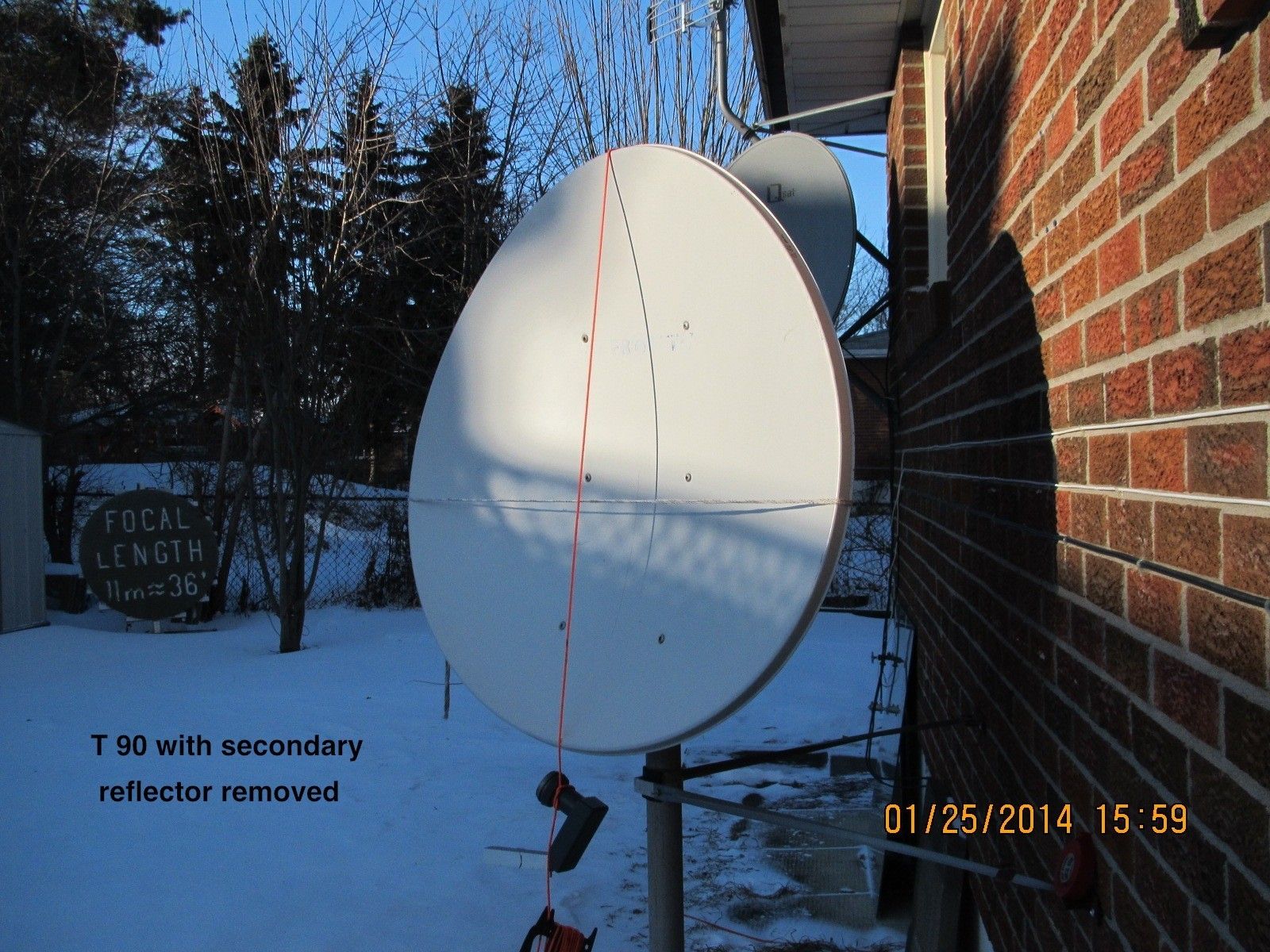

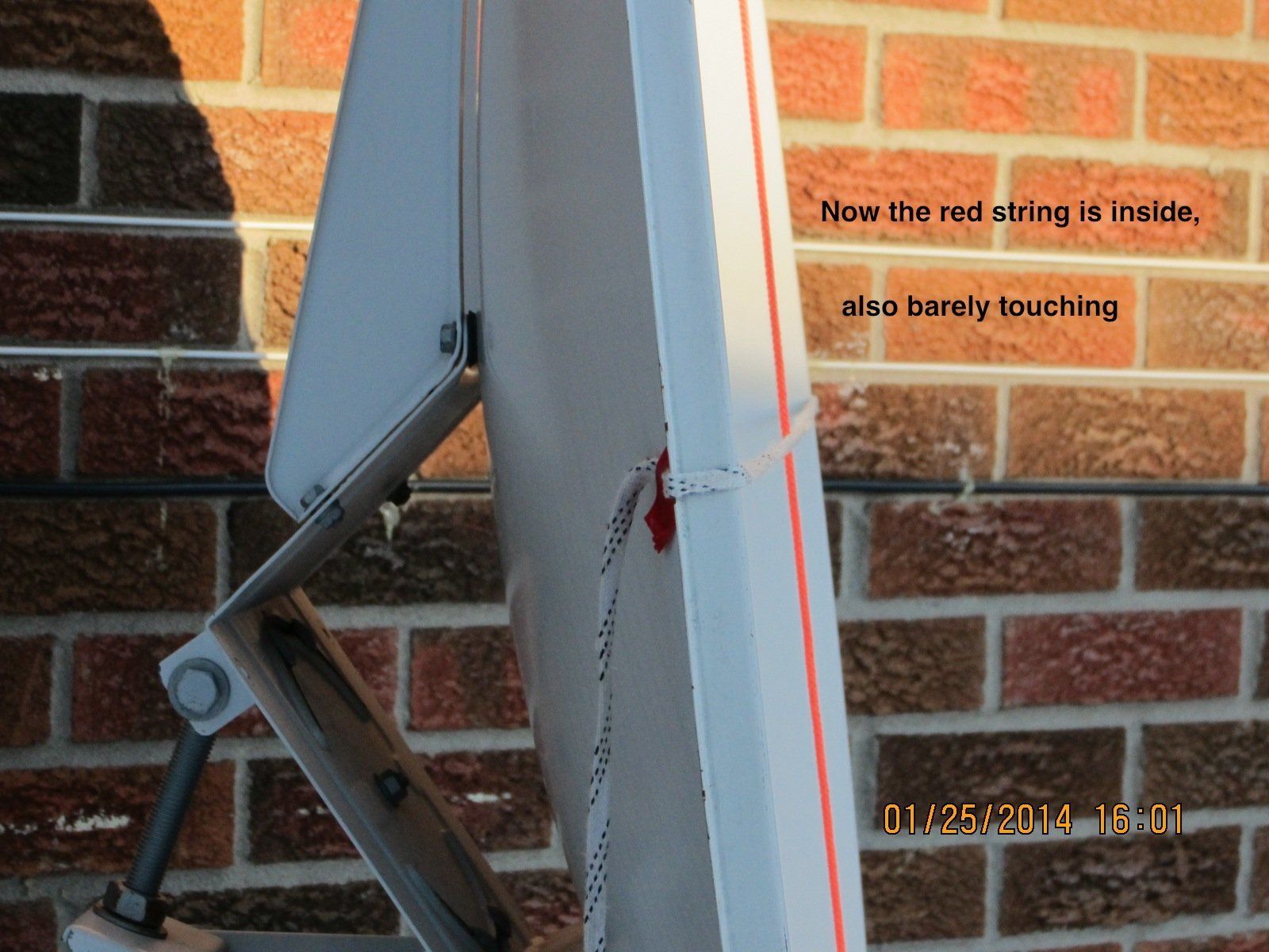

Actually, I have some technical issue with T90- main mirror has changed it's shape. I put horizontal and vertical treads and there is about 15mm difference between treads. Therefore ATM I can not tune it to maximum arc. First I should eliminate this bent first and than finish setup. I have 2 possible reasons of bent: something happened during transportation operation. Or, which I tend to believe, mounting pole is too big in diameter, and when I stick antenna to it shape of mirror changed. I need some time to check it.

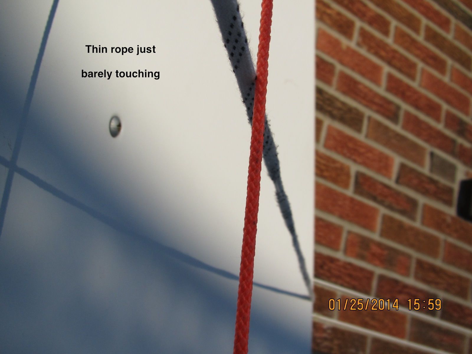

If there is such a distance between threads, there is a distortion of dish shape. Instead of threads, I used thicker rope and shoelace, more visible in pictures.
My dish also has focusing problems, and presently is waiting for better weather to be serviced. However, string test is OK...
It is highly unlikely that your mast caused distortion - there are so many "links" between mast and the "bowl". I used 60 mm aluminum pipe, and it fits OK.

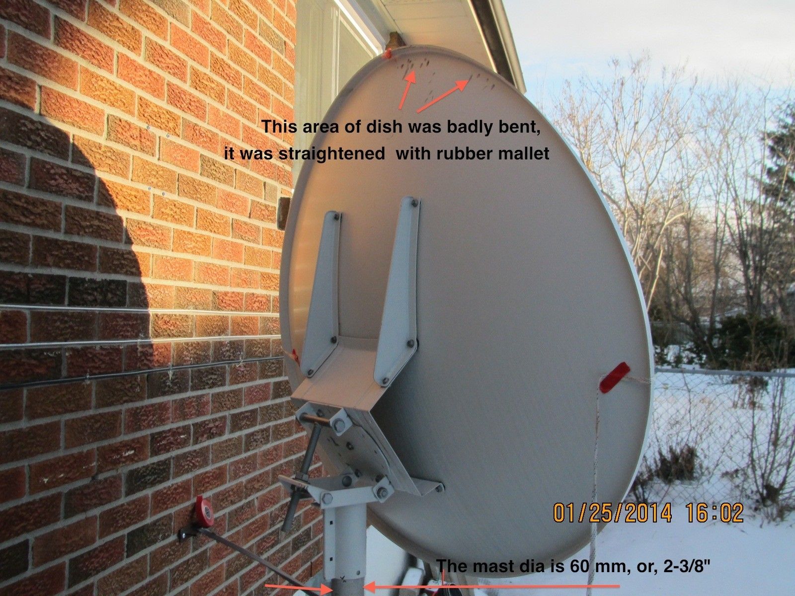

What pipe did you use? Four pictures follow. Cheers, polgyver.
On the Ku dishes I usually use the strings in an X pattern rather than the + pattern, saves removing the LNB support. Sometimes the weight of the support can distort the parabola somewhat, and on the 1.2m fortec star I use a support rope and a spring to remove some of the weight of the arm components, I ran the rope through a hole at the top of the dish and tie it to a spring attached to the top of the mount in the back. Seems to do the job. That looks like a better dish than the one I have and I like the mount on it!
