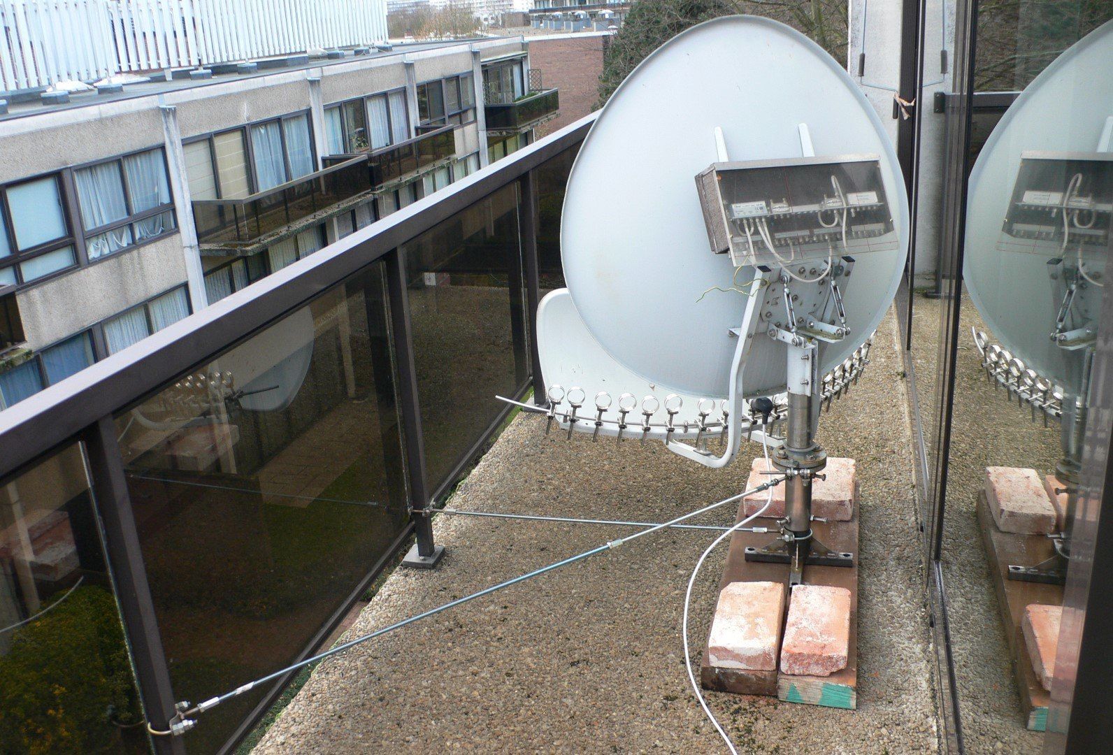

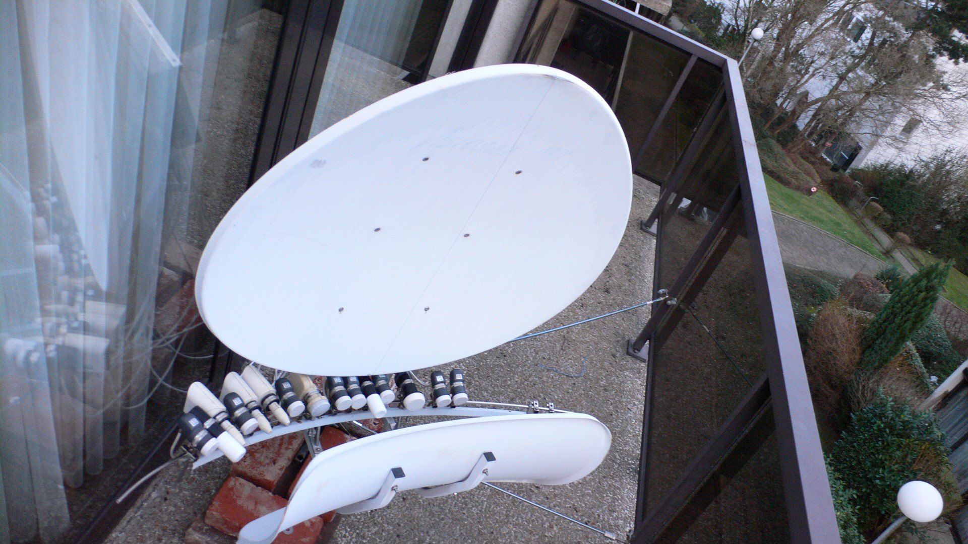

T90 is my favorite dish, have it already 10 years, changed lots of other antennas but T90 still with me. it is nice toy to play with. Reinstalled this dish several times on different locations, that was always fun. Ku-band signals in Europe are great and nobody cares about performance, always enough. On T90 here is possible to tune to all major satellites without any difficulties. Speaking about Diseqcs: I use cascades of diseqcs 1/10 and 1/4, simply because when I needed many LNBs to be connected there were no Diseqc 1/16 on the market. So, T90- installation for more watchable birds and another antenna on the motor to be able to tune to any satellite.

Our satellite signals are quite a bit weaker than what you are accustomed to in Europe. Appears to me you should be all wearing tinfoil garments to keep from 'burning' up. LOL! Have seen many posts where many are using 60cm dishes 'over there'. A 60 cm dish this side of the pond is experimental at best for our FTA. 85-90cm recommended minimum while a 75cm will suffice for a good amount, but miss much, of North American FTA with careful alignment.
I have been using three T-90s for the past five years or so. They receive all of the North American Ku birds, and all DVB-S2 signals just fine, and replaced a couple of 1.2 m offset dishes on motors. I'd much rather set up a toroid than a motorized Ku dish - it takes me much less time and is far more rigid. In my experience Ku offset motors are pretty flimsy and not precision devices. But we have high winds that shredded a C-band HH motor mounting only a 1.2 m offset. These winds can make reception on a Ku motor impossible, but the T-90s are completely operational in the highest winds we get. In terms of sensitivity, the center of a T-90 has a bit higher gain than a 90 cm, but there is a slight fall-off in sensitivity off-axis. As long as you stay within the center 20-30 degrees you'll be fine. By the time you get to +/- 20 degrees, there is a noticeable gain loss.
