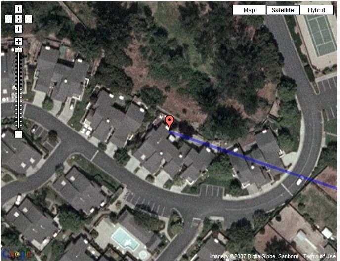

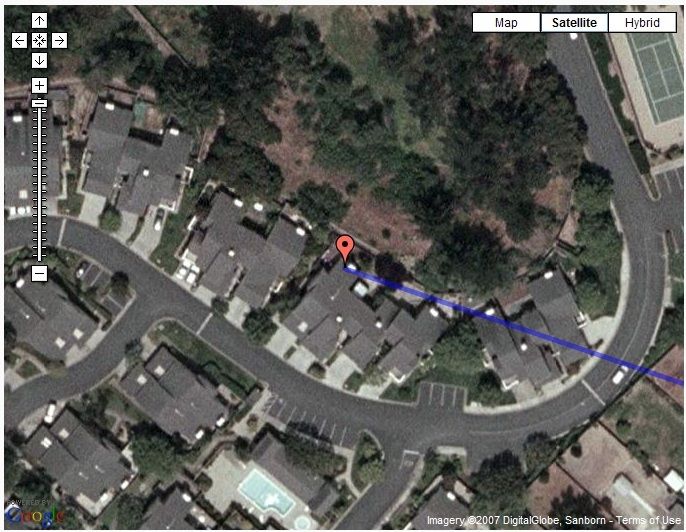

I moved the dish to the front of the chimney and I can't find 61.5 (more on this below). I moved the dish back to where I found it yesterday but about 6 inches higher and most TPs are in the mid 50s and 60s. TP22 is at 40-41. I'm very happy with the readings except that the dish is pointing at the chimney itself and I'm afraid that when it rains hard, the splashing of the rain might block the signal.
I've attached a couple of pictures, location 1 is where the dish is right now. Location 2 is where I want it because the chimney is out of the way but I can't get any signal which I find it very weird. The only thing that could be happening is that one of the trees is blocking the signal as I get closer to the tree. But if you look at the blue line, it's the same path for both locations. I'm planning on leaving it where it is right now and wait until it rains but now it's bugging me why I can't find any signal if I move it forward 4-5 feet.
BTW, the elevation angle is only 14.
Any ideas?

Can you post a picture from the roof with the dish on the left and the chimney on the right?
I don't think you'll have an issue with it, just wait until it rains.
I'll post a picture tomorrow, I wanted to take one today from both locations but I had to run to a meeting at my daughter's school.
