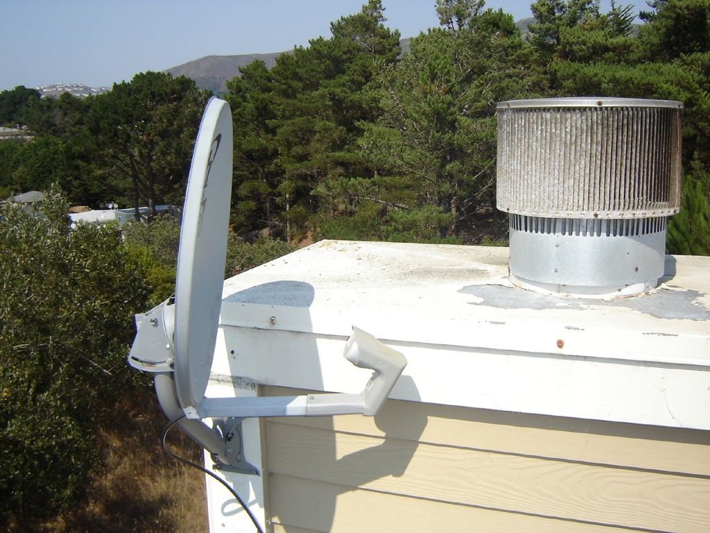

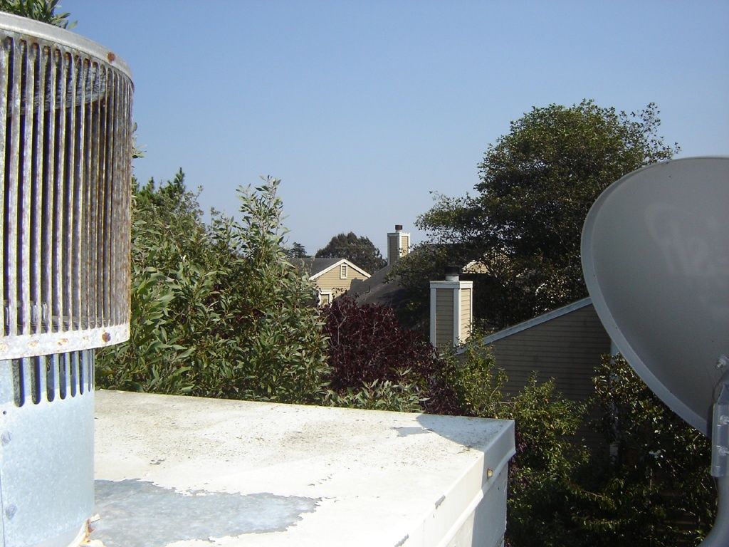

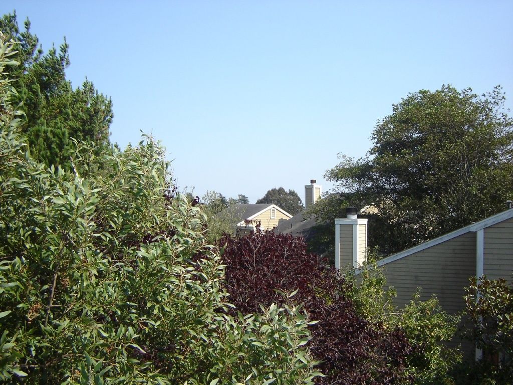

Ok here are the pictures. Location 1 is the one not working and location 2 is working (you can see the 1000.2) and the other one is just where the dish is. For the location 2 picture, I put the camera in front of the Dish logo so that's what the dish sees.

Problem fixed, it was my elevation. For some reason on that side of the chimney I had to adjust my elevation to 16. I checked my mast and it was level but for whatever reason that side of the chimney is not straight.
I had noticed that before when I use the ladder on that side of the chimney but didn't feel that was my problem.
