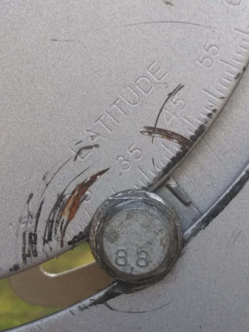

The motor I have has a little mark looking scale thing on the elevation and latitude sides that looks like an engraved arrow and that is what I am using because I assume it is on there for that reason.

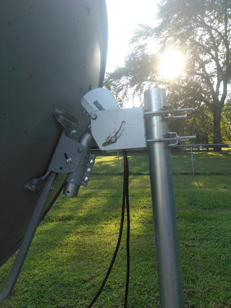

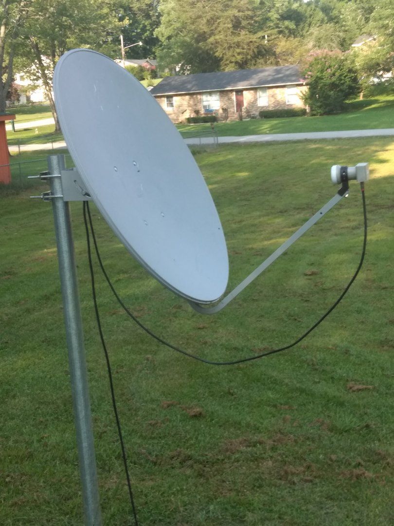

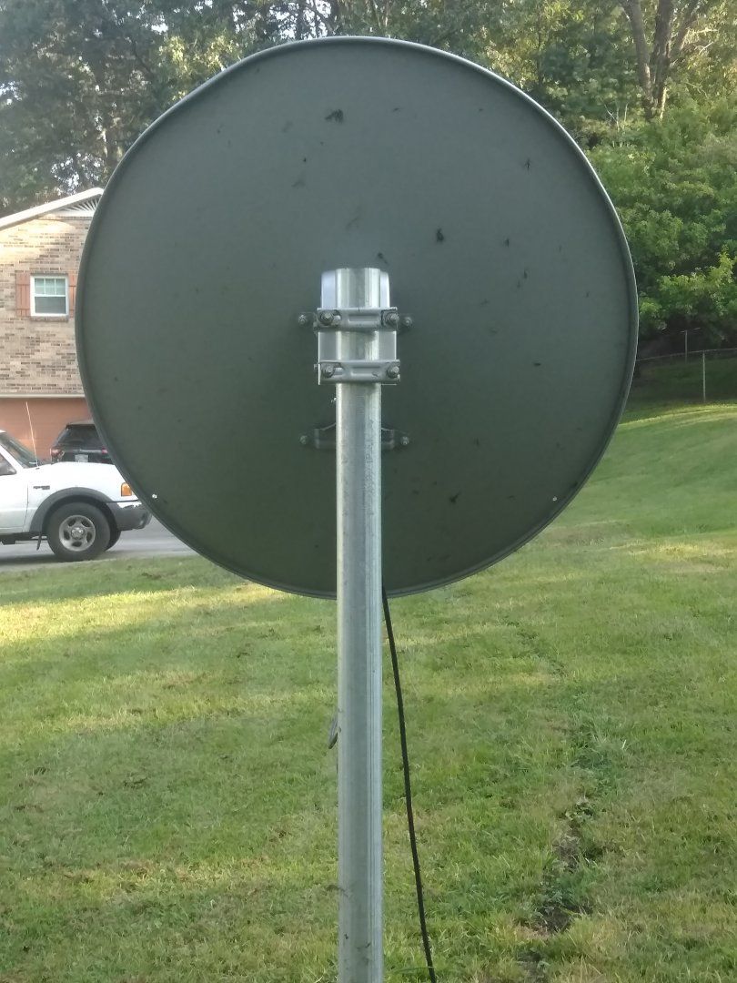

Here are pics. I am guessing the mark on the motor elevation is the scale. Does anything look off to any of you?

Well I'm using a 76cm Winegard dish and sounds like mine is out performing your 90cm. I had a 90cm GEOSATPro that was warped and I could not make work worth a damn. The 76cm out performed that one big time. I received a replacement reflector and the .76 still does a better job.
87W is not good on the Winegard here and never has been. However, 103W is very good with Quality in the high 70's to low 80's. The only thing on 103W that comes and goes is the 4 channel mux. 99W, 123W and 125W have always been good. One of the things I gauge the alignment on is if I am able to get the Fox Mux on 99W...If I can then I know I am pretty well aligned. 113W...Reuters has always been low quality - usually about 50% but always locks with the rest of the channels on that sat in the high 70's.
I do spend quite some time making sure it's dialed in dead nuts to my South Sat and that it tracks the arc perfectly. If your dish is warped even slightly then you will have goofy issues especially on Ku. I noticed that on my warped 90cm that elevation was extremely touchy when I would try and adjust.
Also, I noticed that you mentioned that you are only getting wild feeds on 103W? If that is the case, 103W can be a bit tricky especially if your pole is not perfectly plumb thus causing the motor not to track the arc perfectly. You should be getting all the NBC feeds on the sat.
I would say off the bat that you either have a warped reflector and/or alignment issues -
I am getting everything on 103. All the NC 1-12 feeds, cozi, the nbcs and lots of feeds. I get no fox mux i guess on 99. Which receiver do you have? Maybe geosat 3500 is a low signal quality readout because you can lock in at 5 to 7 pct.
Ok sorry missed the part about the NBC feeds on 103W...I'm using the Mio as my main box but have several in my arsenal. With your 90cm dish and your location (TN) I would think you could do better than you are.
Looking at your pictures, especially the one of the rear of your dish...looking at the 11:00 position, it almost looks like it has an issue like it's bent or something
Reactions: a33
I think so too.
Whether it's just the rim or the whole dish is hard to see.
String test would be necessary (and maybe more dish measurements).

Well I noticed I did have it a bit too to the West. I swung the whole mount and dish a bit to the East and think I am just about dialed in. I am getting almost top signal on 87 and on 125. I may be able to squeeze a hair more, tomorrow I am going to maybe move it another half inch to the east and check to see if I am going to get a bit better. I still cant get the dang ny lotto feed, but am getting everything else.
There is a slight bend on the top of the dish on the outer rim but I know the signal doesnt hit up that high. Until I get ahold of a birdog or sat meter I dont think I will be getting much more with this size dish.
