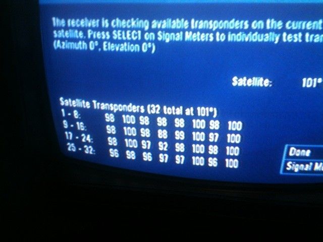

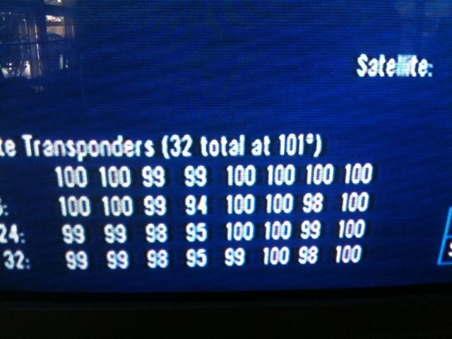

What do you think? TP 2 or 12 ? This is what I go by and my pics speak for themselves.
See attachments.
I can post more of my tuning pics.

I'm curious on how you get such high values for ALL spot beams?
Back when I just had the 18" round dish for 101, I'd tune in the lowest TP (not spot beam like 12) and tweak it as high as I could.
I usually use TP 12 to find the signal and then work from there.
12 is normally easy to get 100 on the 101 from where I'm at.
I don't know if location means anything with this, but I have never had that many 100's either.
On a clear day I can usually get 5-6 100's.
All my numbers on the 101 are 93 and up with 4 100's, but it's been raining off and on all day.
However, he had 16 TP with 100 ....
