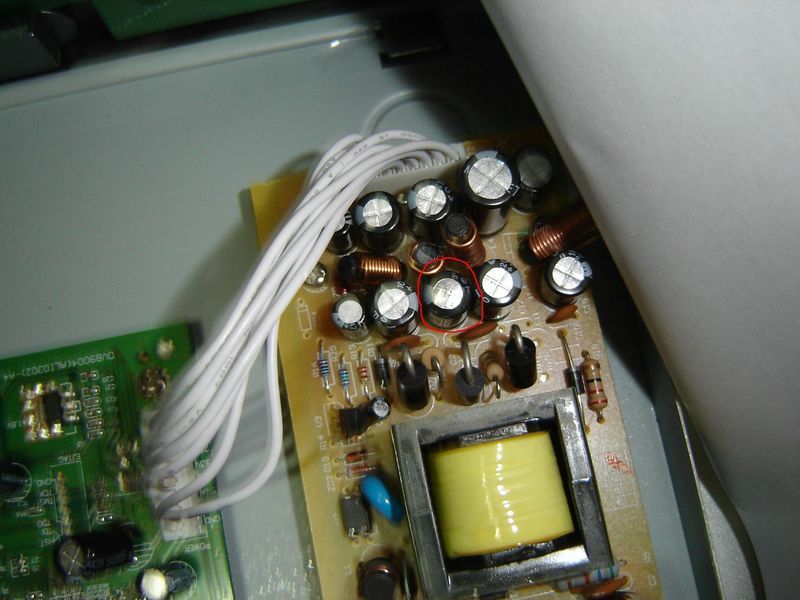

Q qnguyen New Member Original poster Oct 26, 2007 2 0 Oct 26, 2007 #1 Hi, I have a traxis dbs4550 and have problem with it. The power light and lock light are blinking. I could not power it on. Any sugesstion?

H hiebert SatelliteGuys Family Apr 29, 2005 45 0 Oct 26, 2007 #4 qnguyen said: Hi, I have a traxis dbs4550 and have problem with it. The power light and lock light are blinking. I could not power it on. Any sugesstion? Click to expand... Change the capacitors from the power supply and the Traxis will work again Saludos Hiebert Attachments 4550 capacitor [800x600].JPG 65.4 KB · Views: 212

Anole SatelliteGuys Master Sep 22, 2005 11,819 14 L.A., Calif. Oct 26, 2007 #5 You can determine if it is bad capacitors in the power supply, by reading all the tell tale signs in this other thread by Linuxman: http://www.satelliteguys.us/free-air-fta-discussion/108266-broken-pansat-3500-a.html If the unit is out of warranty (or warranty repair is too expensive), you might follow the suggestions found there. Of course, if you don't have the same symptoms and signs, then maybe it's something else. Have you tried to load new firmware to it recently.?.
