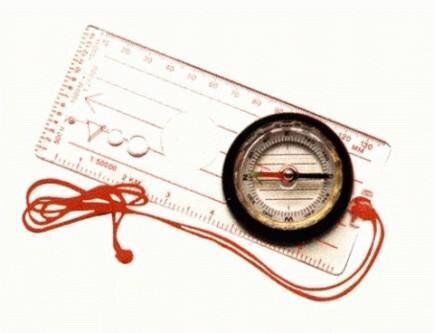

You need to get a compass and make sure you are aiming to the correct heading. I simply use a compass and the receiver's built-in meter and takes about 15 - 20 mins. That mast best be dead on level & plumb. What heading are you aiming for?

I have already tried bringing the tv up on the roof and I have no problem using a compass for those that are wondering.
