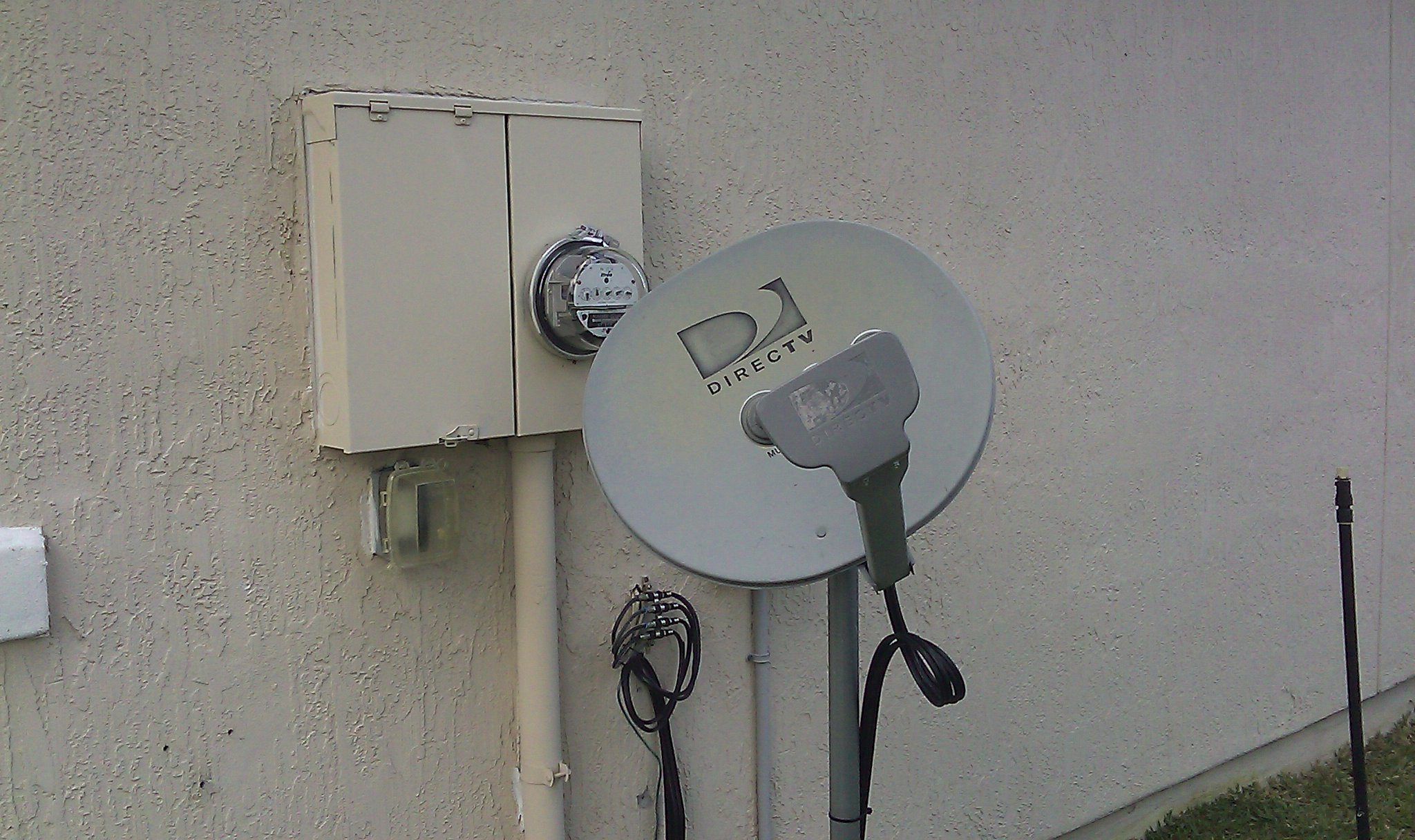

My daughter wanted to get DirecTV because of the introductory offer at $29.95. She called in and the installer came out and everything seemed fine. After 3 weeks she began to lose signal so she called the DirecTV and they sent out a different tech who said the problem was the first installer put in the wrong LNB set and changed it out and left. She still had the problem so she called me to come over and look at it. I told her I'd have a look for the obvious but I'm not that familiar with the latest DirecTV dish hardware.
What I found was at first two things obvious-

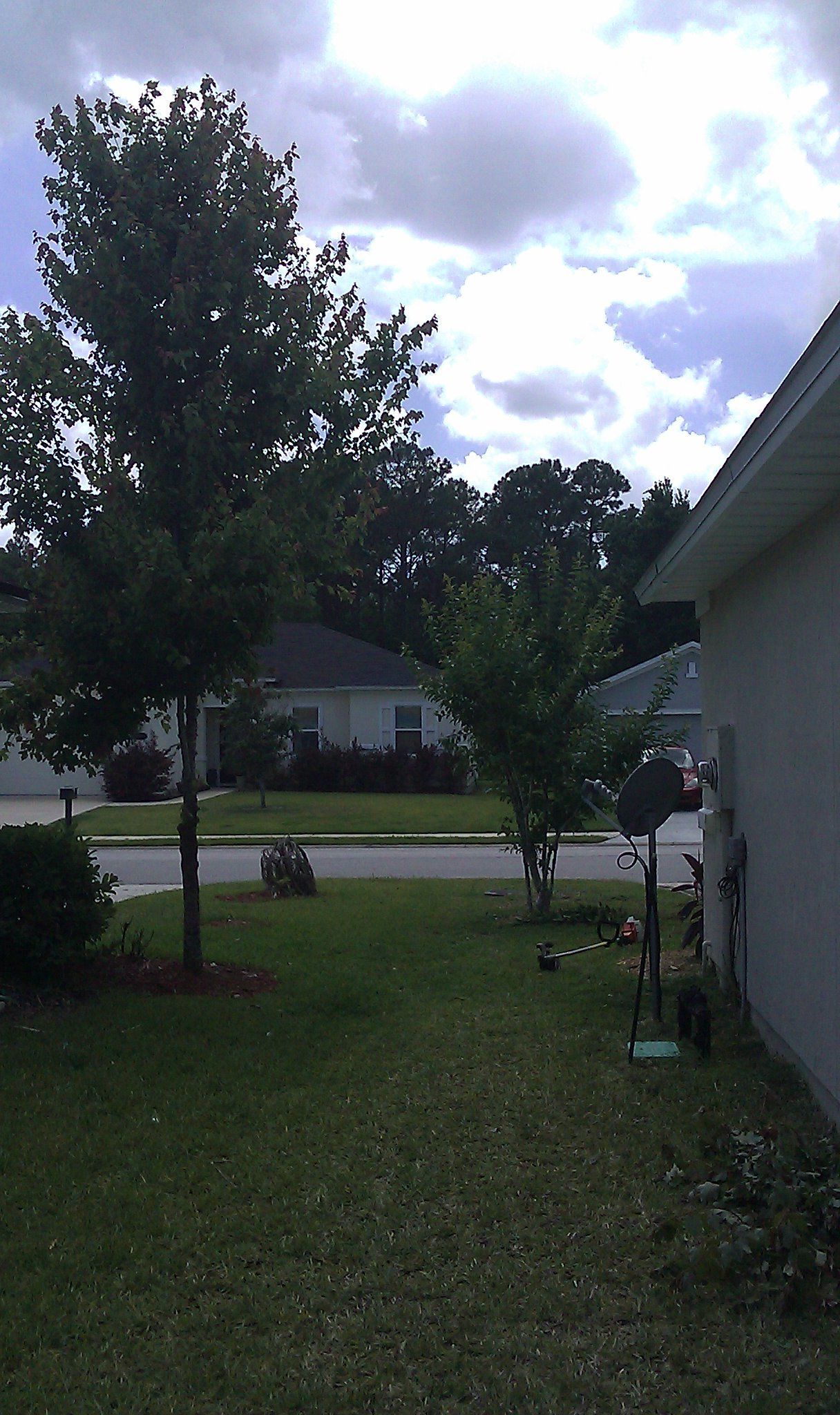

The dish was pointed directly into a tree about 10 FT in front of the the line of sight angle to the sky. When my son-in-law came home he told me that when he spoke to the second installer he told him he'd have to get his neighbor to cut the tree down. ( That obviously is not going to happen )
The second obvious issue I saw is the first installer mounted the in ground pole for the dish directly in front of the electrical meter. The dish is 4 inches in front of the meter. I believe this is in violation of the Code. It actually makes it difficult for the meter reader to see the readings. But I suppose he would have to complain before DirecTV would do anything about that. Secondly, the installer pulled the meter ground wire off the meter and used it to ground the feed through strap for the coax. Now their meter is not grounded! This may be a safety issue.
Another minor issue was that they got HDTV and the installer connected the sat receiver to the HD monitor with coax. I told them they need to get the receiver connected to the TV with an HDMI cable. The TV has 4 HDMI inputs. We are already using one for the Blue Ray Player.
Finally, it looks like they got used equipment (see photo) especially the dish looks to be several years old but I guess DirecTV sends out used equipment for new installs under that special price. The coax looks new.
While the signal looked pretty good, when the wind isn't blowing, they get 92 average meter readings and good picture. When the wind blows the tree the signal varies all the way down to zero and they get the searching for satellite popup every couple seconds. The signal meters swing like a vu meter on audio it is so bad.
If this was my house, I would simply move the satellite mounting mast 10 ft down the wall and and add some extension coax. Put the ground wire back on the meter box and add a 10 ft ground rod for the strap. add a second ground rod for the dish mast. Shouldn't take more than an hour plus time for the concrete to set up.

Hi Don .. that dish is used 100% used..
Second note its not HD. So that is why the box is hooked up via coax.
Third Giving the tree locaion and angle of the dish loss of signal is a given . Why did they do a pole mount?

Hi Don, The problem your daughter has is that she has a phase 3 dish, it is used and is for mainly for sd programing. A slimline 5 dish is used for hd programing. A hd reciecver DOES NOT have rf output. They only have hdmi, component, composite and s video. Sd recievers DO NOT have hdmi or component outputs, they do have rf, s video and composite outputs. Look on the inside access card door and it has the reciever model. What model is it? As far as the dish location, by your photos it's mounted to low and will need to be raised higher or relocated to a place where line of sight will not be an issue. If left in its current place, the growth of the tree will cause total signal loss and the dish will have to be raised, relocated or the tree will have to be trimmed or cut down. The ground wire is a problem because it sounds like the dish pole is the ground for the house instead of having the house ground grounding the dish pole. The electric co. may have a problem with the ground wire and location as it appears to cover the meter and a meter reader may not be able to get a reading.

Although the LOS may be blocked, it needs to be said that the signal actually comes in from a higher angle than what it looks. ~22 degrees if I remember. She definitely needs the AU9 dish and if mounted on a longer pole may work just fine.
Indeed, the angle is higher than you would expect. Mine is pole mounted about 6 feet away from my house, pointed at the house, and I have a pretty steep/tall roof. Either way, though, she needs a different dish (that one doesn't pick up 99/103), and it looks like they could have come down (towards the camera) and avoided the tree (of course we can't see what's to the left of the camera).

I can't believe the installer used that dish. He probably took it off another house when the person was getting a slimline dish installed and reused it at her place. If she ordered SD she should have gotten an 18" dish. If she ordered HD she should have gotten a slimline3 or maybe slimline5. I didn't even know they used those phase 3 dishes anymore. A slimline5 would get the 99,101,103,110,119 if for some reason she needed the 110,119.
The dish may be used.. But the dish style is not a problem for SD. That is the standard Tri-Oval Dish used in locations that require 119-110-101.
The Phase 3 dish is still used for sd installations where the local channels are on 119.

The mounting could have easily been located further along the wall and would have cleared everything. The LOS angle for DirecTV places the LOS near the top of the tree. I agree that as the tree grows it will lose all signal. I don't know if these installers, are just stupid, lack training, or are just lazy and will see what they can get away with. But I have seen equally poor installations from DishNetwork, DirecTV, and Comcast here.
