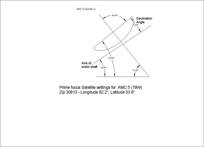

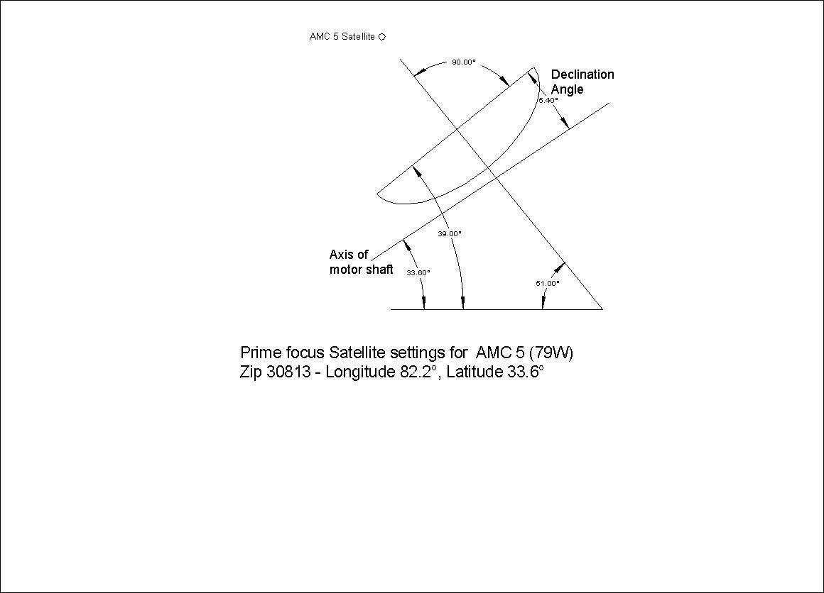

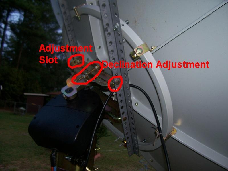

I am sure it adjusts, I have marked his picture, see attachment, as to how I think it works.

Take a look at my post #15 above - about using an inclinometer. Might double check your settings with one.

jagee
I know this is all very confusing. Because you have a prime focus dish, it very easy to see if the final elevation is correct. With a inclinometer (also know as a clinometer) you can lay it on the front surface (rim) of you dish and it should read the angle the dish is pointing directly. Remember that you should be aimed just a little above 1/2 way from horizontal and straight up @ 51°.
When using the inclinometer you sometimes have to adjust your direct reading by adding or subtracting 90° to derive the reading your trying to get.
The Shaft of the motor is at 33.5° which is at almost 90° (actually 85.4°angle with the 5.4° declination) from the elevation of the satellite.
Just remember that a prime focus dish will appear to be aimed about 25° higher than an offset dish when aimed at the same satellite.

Jagee I don't know how the scale is laid out on your inclinometer, IF it is like mine you should get the correct reading on the top of the motor shaft like you describe it. I am sorry that I have not been of help to you with all of my "numbers".
Could you get someone that is accustomed to reading mechanical drawings to help. Print out my PDF sketch above and share it with someone who works in fabrication or construction. If they use angles in their work perhaps the sketch would help them help you.
If someone else on the forum can explain or illustrate this setup in a better way I would welcome the help on Jagee's behalf.
