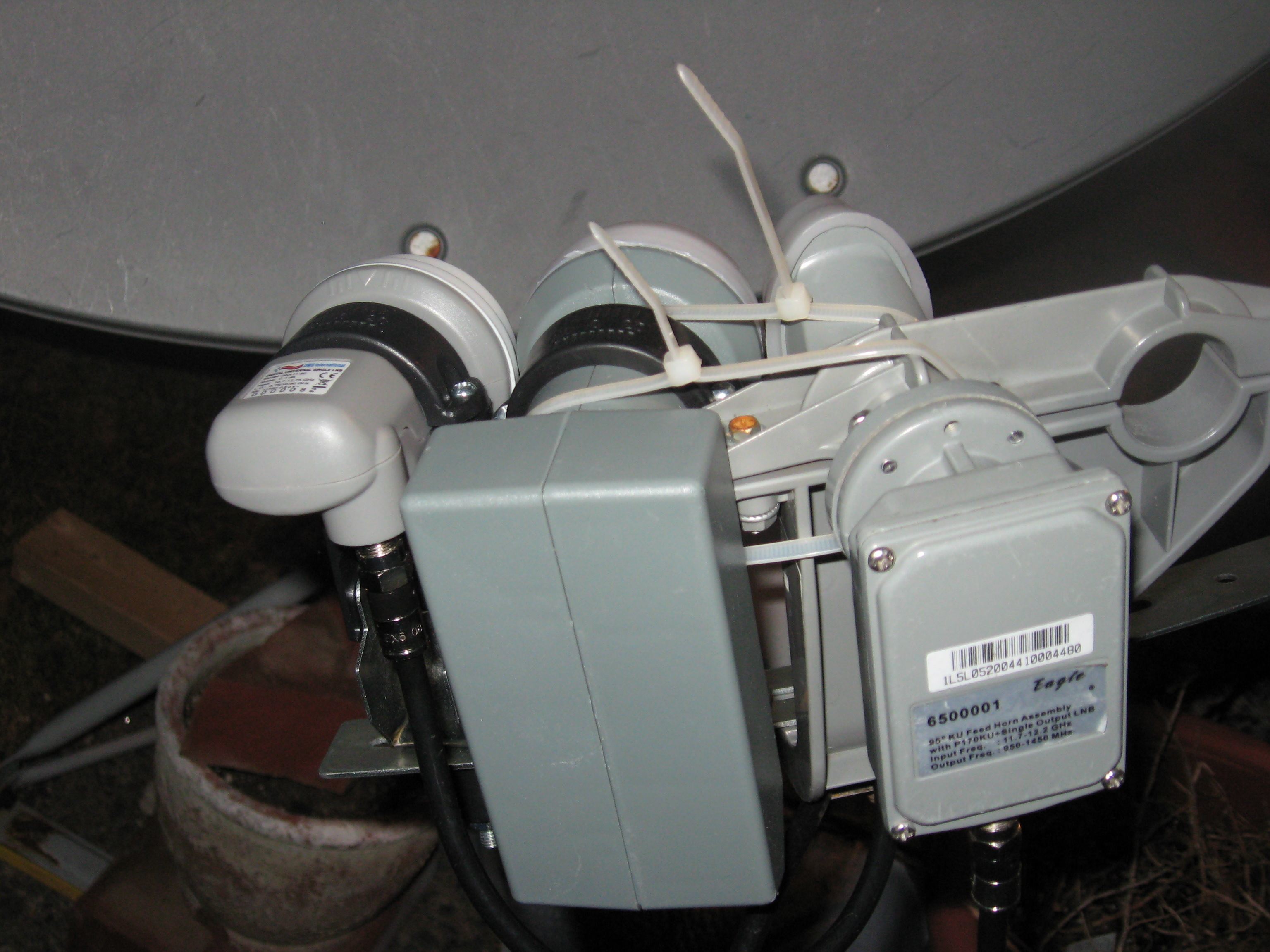

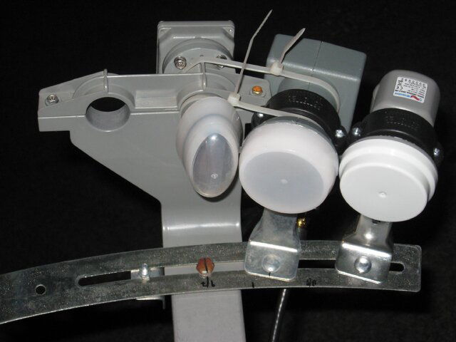

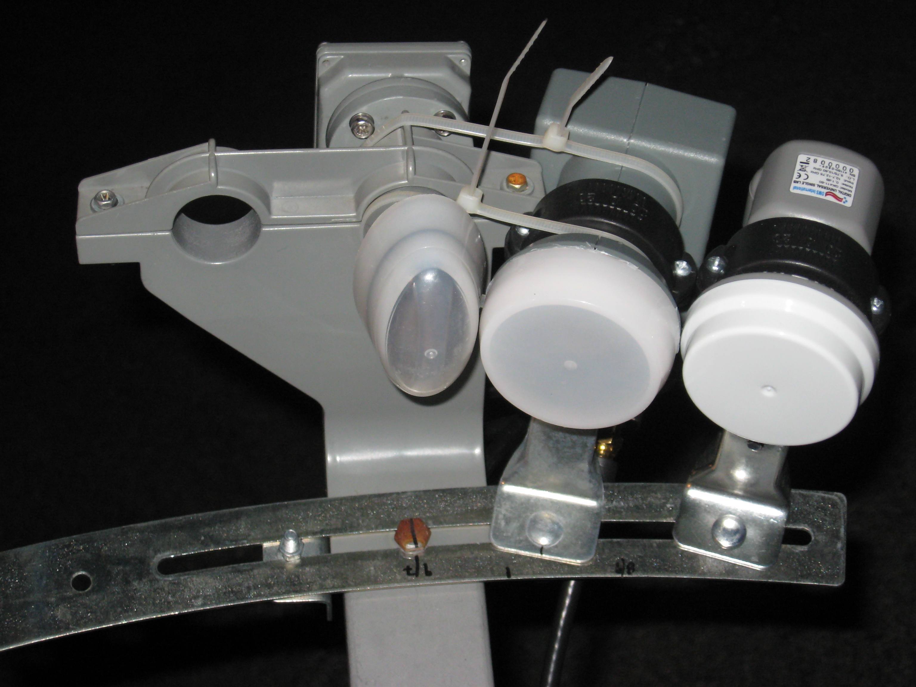

I have the same setup, LNB that came with dish is on 101W(AMC 4) and LNB next to it is 97W(G19) and then 91W(G17). I used a universal bracket and tie wraps to attach the G19 LNB. The LNB holder that comes with the dish makes it very hard to get an adjacent LNB close enough without the added tie wraps. I also first positioned the dish for 101, elevation and skew, then moved it about a 1/16 to an 1/8 of an inch to the left from behind the dish to improve signal on 97.

Southeastern PA, Just set your dish up for 101,use dishpointer.com great site, strap another LNB next to the stock LNB as close as you can get it and watch the quality meter on the STB using a strong TP on 97 and go from there.

What about the curved metal strip you are using as your base? Is that something you manufactured yourself?
