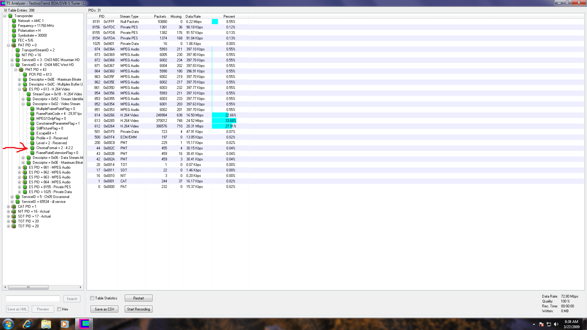

Here is a screenshot of the Transedit analysys of the NBC West HD S2 feed on AMC1. I put an arrow where the chroma info is.

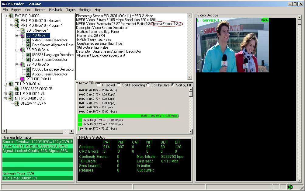

TSReader will give you the info too. Please post ( I don't have access to the feed) TSReader snapshot with selected video PID [613] of the channel.
yes I know, but the point is if Transedit could do it and save me a step (the step of recording the TS and then importing it into my TSREADER). My DVB-S2 USB device works much better with BDA than with the WDM drivers, so it's not a slam dunk to use TSREADER unless TSREADER ever comes through with the rumored BDA support. I've just been doing the workaround for some signals of high interest for analysis.
If it's a uplinker controlled thing, that would explain why I don't see it in Transedit unless the uplinker specially had that item in there. I'll have to tune the signal of the Transedit screenshot with chroma and verify I get the same results.
