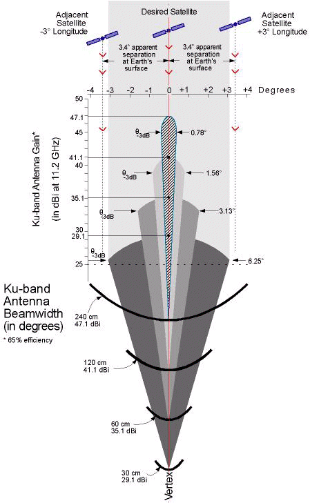

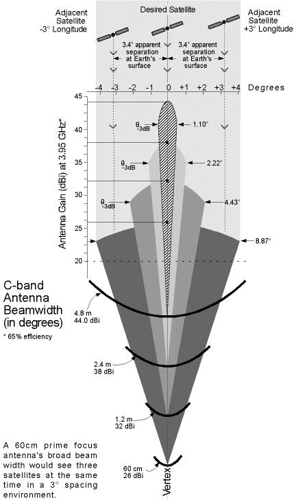

-3 dB Loss @ 11.7 GHz
70 cm (27 in) sees 2.54° to each side.
80 cm (31 in) sees 2.22° to each side.
90 cm (36 in) sees 1.97° to each side.
100 cm (39 in) sees 1.78° to each side.
110 cm (43 in) sees 1.61° to each side.
120 cm (47 in) sees 1.48° to each side.
150 cm (59 in) sees 1.18° to each side.
200 cm (78 in) sees 0.89° to each side.
Here is a good "Antenna beamwidth calculator".
The following images are from: The Battle of the Bands

-3 dB from the main lobe is what is usually considered for interference.
If all dishes are pointing at 122.85° (G18's exact location) West they will pick up interference from:
70 cm dish [120.31° - 125.39° West]
80 cm dish [120.63° - 125.07° West]
90 cm dish [120.88° - 124.82° West]
100 cm dish [121.07° - 124.63° West]
110 cm dish [121.24° - 124.46° West]
120 cm dish [121.37° - 124.33° West]
150 cm dish [121.67° - 124.03° West]
200 cm dish [121.96° - 123.74° West]
121.0°W is really at 120.77°W and 125.0°W is really at 124.85°W.
So it looks like a 90 cm dish (by 0.03° to the 125.0° West side) is the bare minimum dish size for interference free reception with a 2° Ku band spacing if you have no errors.
Using my pansat 3500 and disecq 1.2 one click is 0.3°
If you look at the dish you can't see a difference, if I take that into account (Alignment error of +/- 0.3°) you really need to have a 110 cm dish.

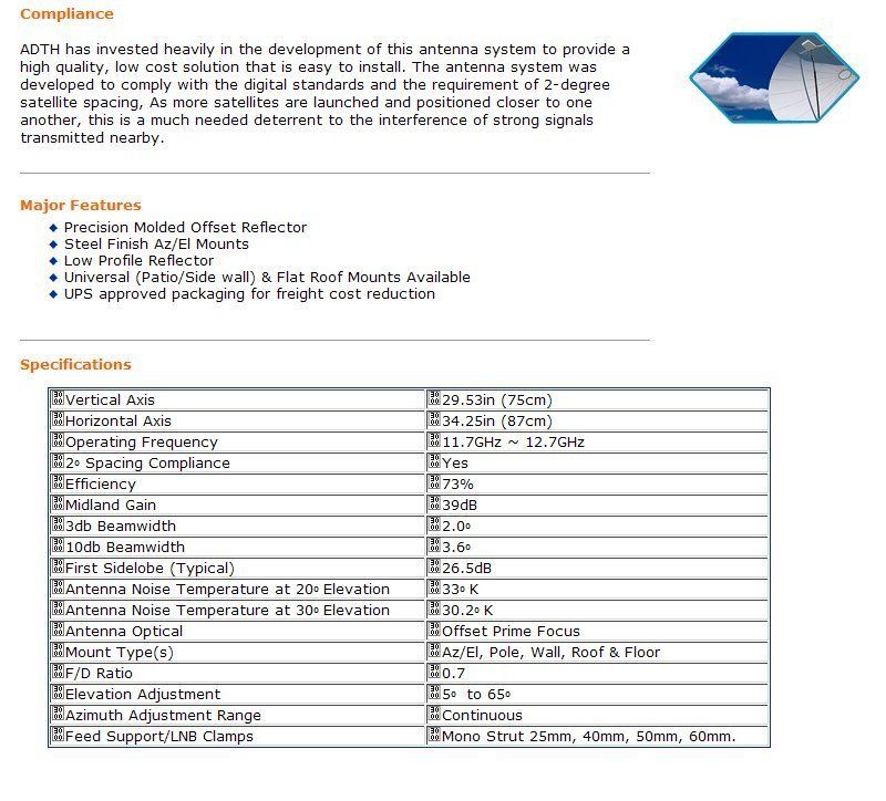

According to the specs on my 84cm dish it's 2 degrees at 3db down. So 123 being 1.8 degrees away from 125 makes sense with me bumping the dish a tad. One thing that wasn't brought up here is the efficiency of the dish. A dish with better surface accuracy has better efficiency and can be smaller, sloppy reflectors don't play well at 2 degrees.
