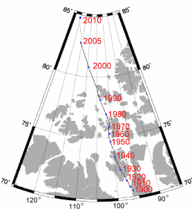

It appears that the Satguys calculation is referencing an updated Magnetic Declination table. We will update the declination table next week. Quite interesting that the Magnetic Declination point really jumped a large distance in the last year! Seems that we are due for a reversal in the upcoming years, but who knows....
