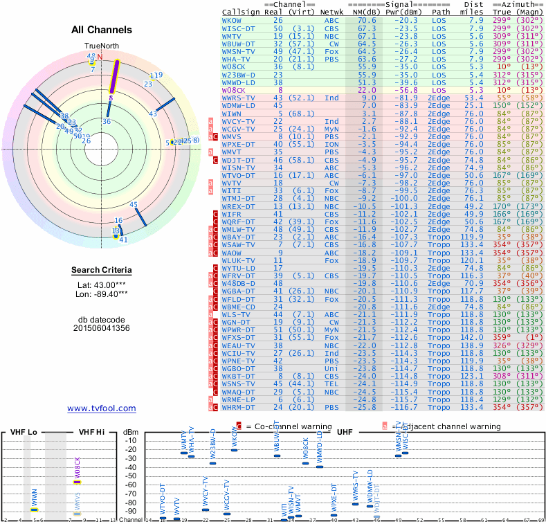

Thanks FaT Air, as a last resort I can put in a coax A/B switch. TV Fool info is as follows:
Upload 2015 6 23 11 26 59
The two channels I do not get on the roof are 3.1 and 47.1 but can get them on ground level without all the other channels.
