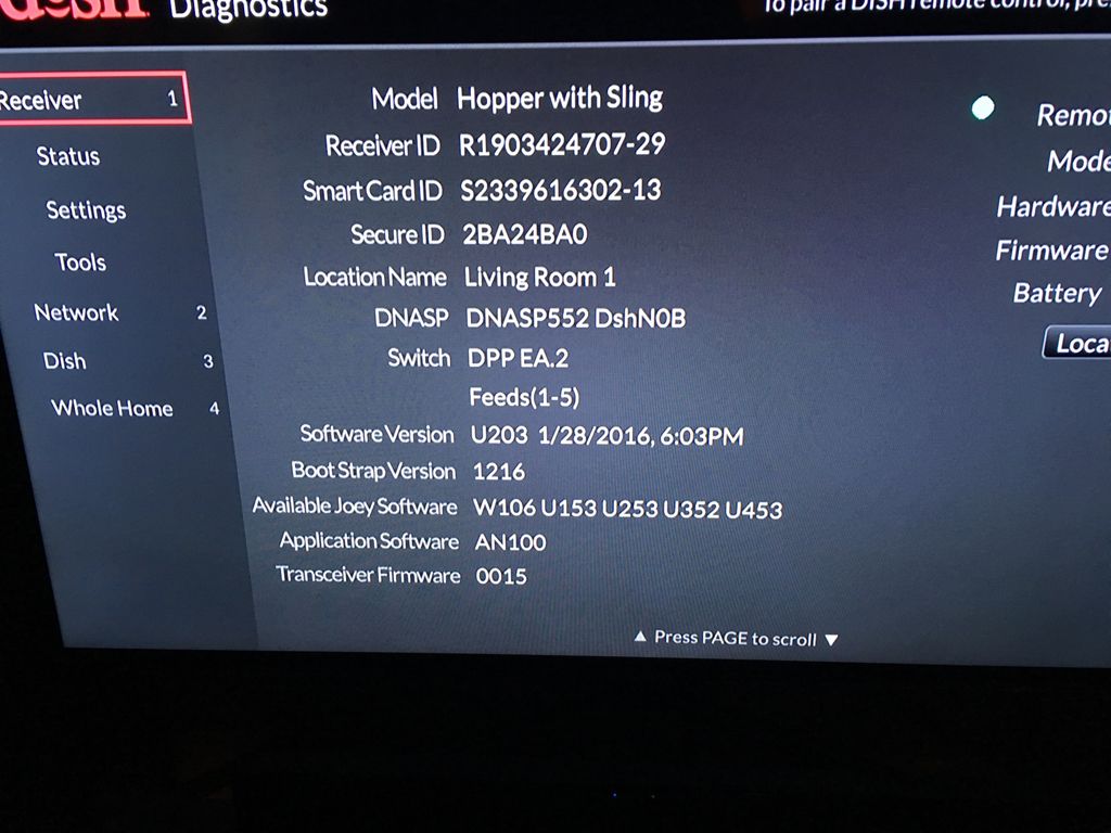

Also some of you with SJ issues. Press menu 2 times and post here what software version your SJ is running. It looks to me the update dish sent yesterday updated everything to Uxx3 but the SJ is still at U352. Looks like they are still fixing up issues

My SJ is still running U352.

The Hopper will list what Joey versions it has downloaded. I'm not 100% positive, but mine all seems to match the Hopper version's last digit, as in, U203 on the Hopper and the Joey software available are Wx53, U153, U253, U353, etc, etc. The "W" version is for the wireless Joey and the others are for, in no particular order that I'm certain of, Joey 1, Joey 2, Super Joey, 4K Joey.
My hopper is still showing U352 for the SJ. I believe that may be the issue. Doesn't seem like everyone got the updated software for the SJ yet.
Yes, that is an "issue". Well, maybe not.... Either way, that SJ can't update to U353.
By the way, I'm not saying my Hopper in fact has U353 on it. I just gave those numbers as examples of what it should look like.

I just checked my Hopper and all the Joeys software ends in 3 except the SJ which is still at U352 which is what my SJ is still running. Strange...
