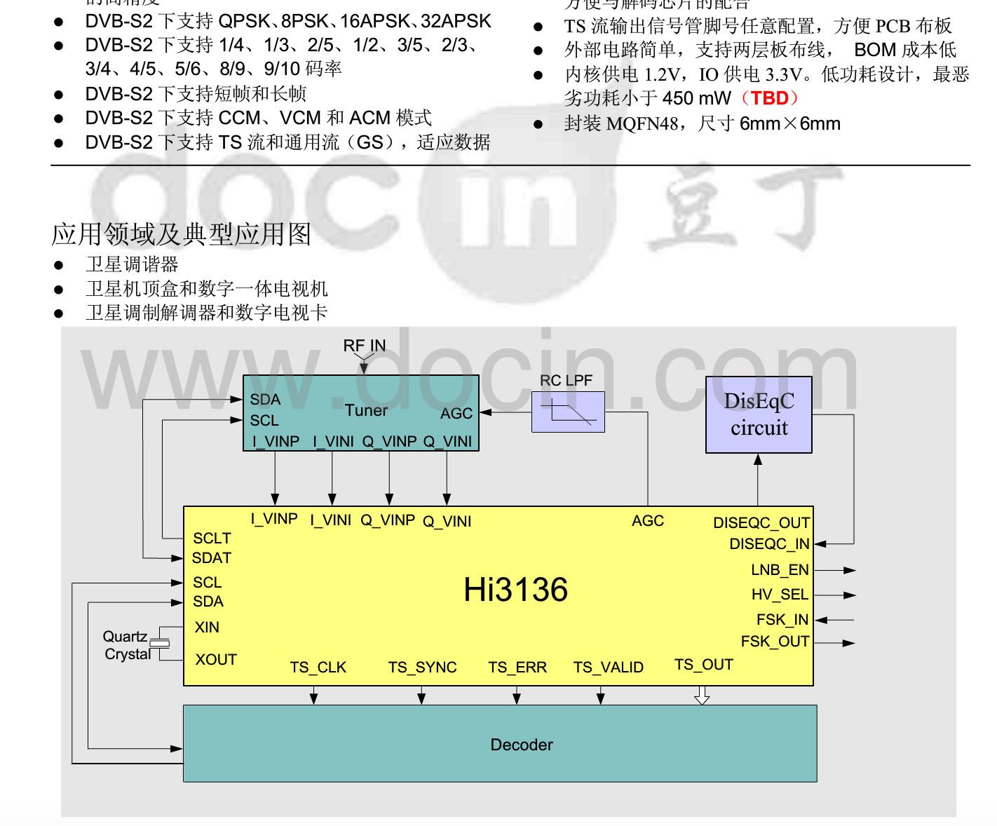

I am wondering if the Hi3136 Demodulator will do ACM. Also wondering if this will have some of the same problems as the A3 Quad Combo, which can't (yet) record UHD and has other issues. I understand that its still in test mode, so nothing is set in stone.

I found the full specs and block diagram for the Hi3136 demodulator. ACM is listed! :happydance

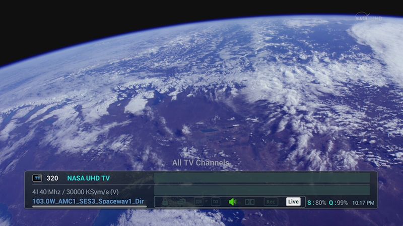

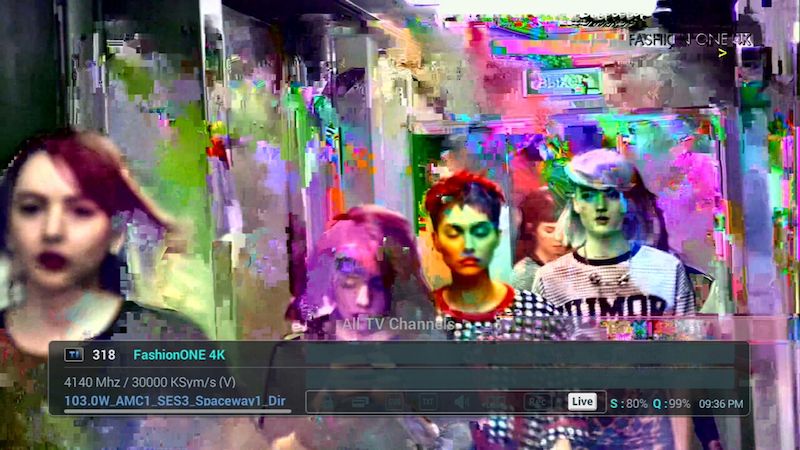

2) All the UHD channels on 103W and 105W have various playback problems on my 1080P TV. There are the frequent audio cutouts and dropped video frames / pauses on NASA UHD. When I say 'frequent' I'm talking about every second or two. Pauses may last for a split second to several seconds. Sometimes it locks up and requires a power cycle. 'Fashion One' UHD is severely pixelated. The 'Silent Monkeys' channel has the same video issues as NASA UHD.

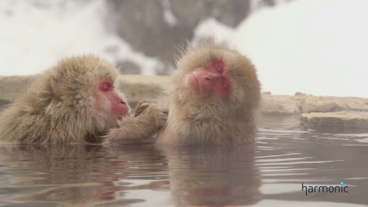

What & where is the "Silent Monkeys" channel?
Never heard of this one.
103W 4140V 30000
It's silent. From what I could tell by lipreading he said "I'll scratch your neck if you scratch mine".

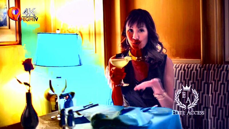

On 103W there's UHD1 (Silent Monkeys), Fashion One 4K, High 4K TV, and NASA UHD TV. Some screenshots below. As you can see, Fashion One is pixelated and High 4K has strange colors.
I've got NASA UHD on 105. But I'm going from memory. Will check out 103 for the others. Thanks!
