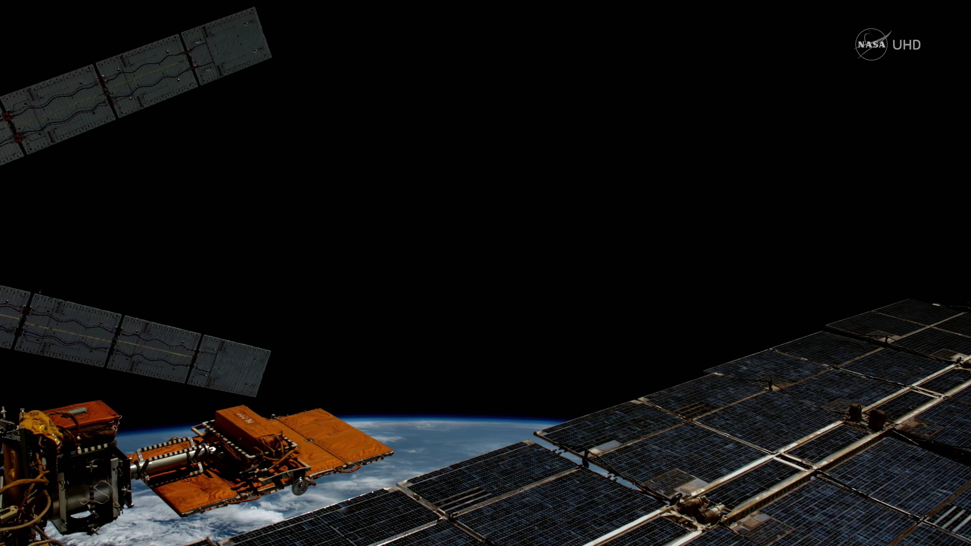

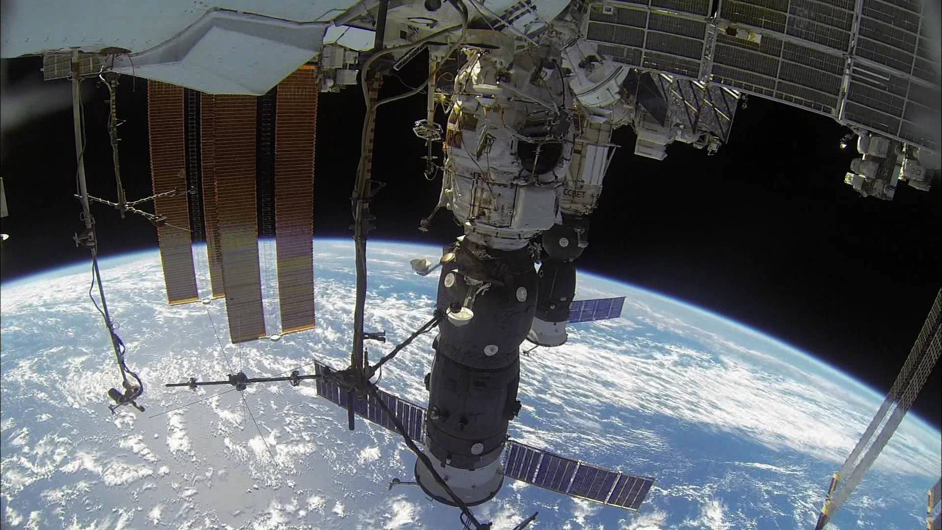

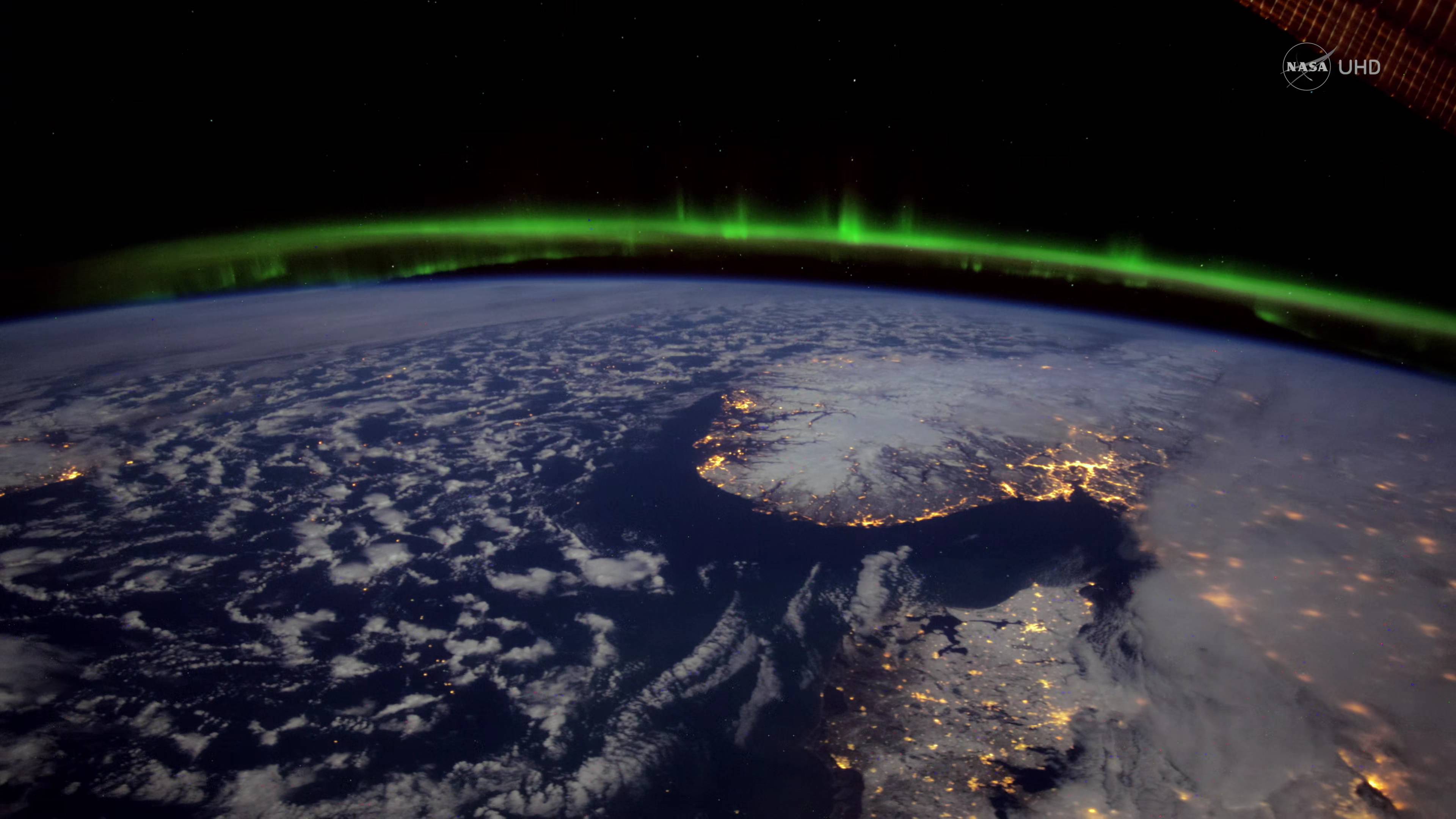

A couple weeks ago I got it running again and could get NASA UHD locked off 105, but it was jerky. Seemed to skip about 90% of the frames. I put the video card in and it now drops about 25% of the frames. I just put W10 on in place of XP and it seems to be running more CPU% all the time. Don't know if there's more optimization to be had. I'm sure there's room for improvement in the LAV codecs with 4KTV.
Running DVB Dream with the W8.1 drivers. Had to edit the Registry to get the stream to detect. (see https://rickcaylor.websitetoolbox.com/post/prof-8000-windows-810-7740421 )

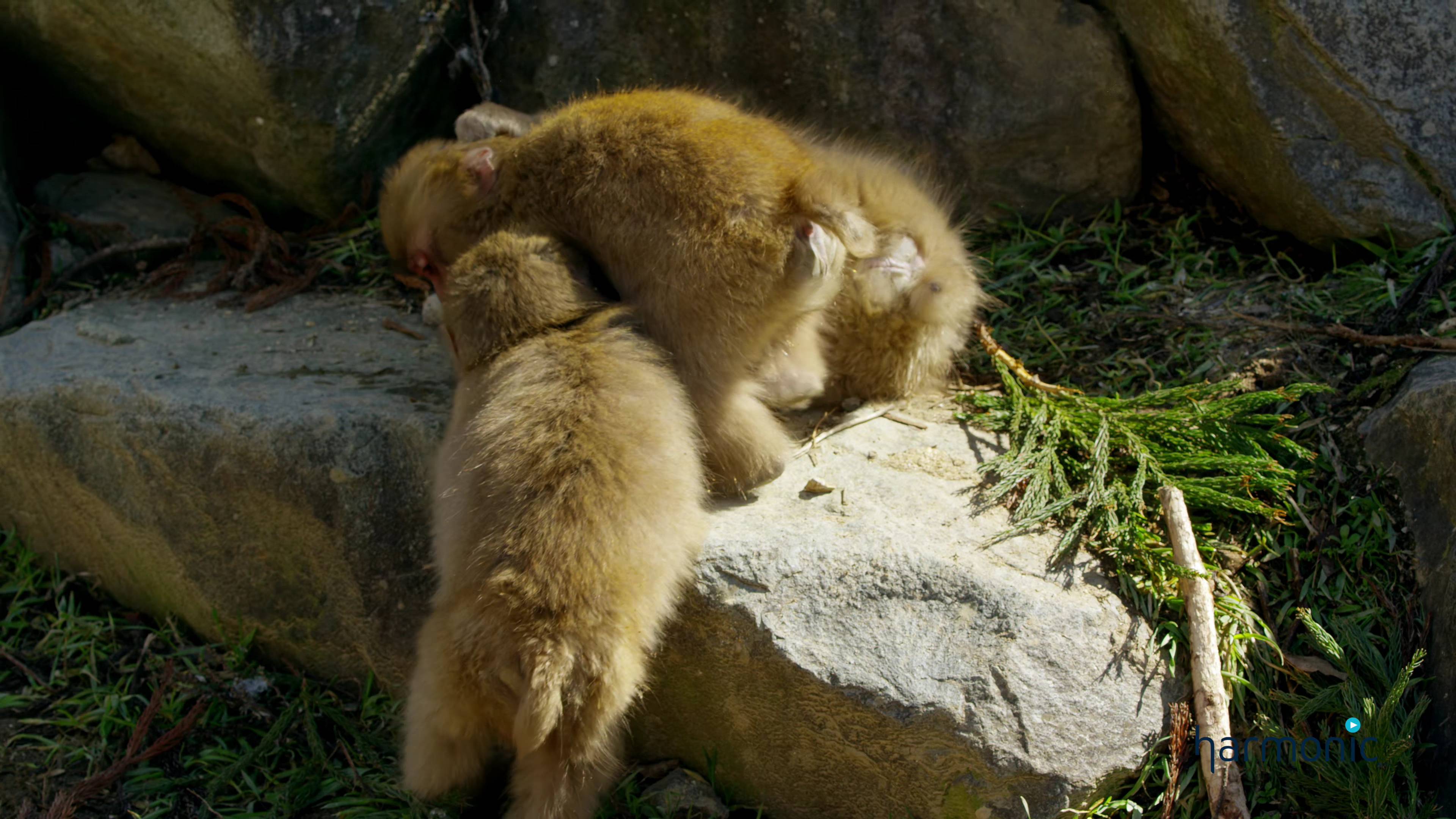

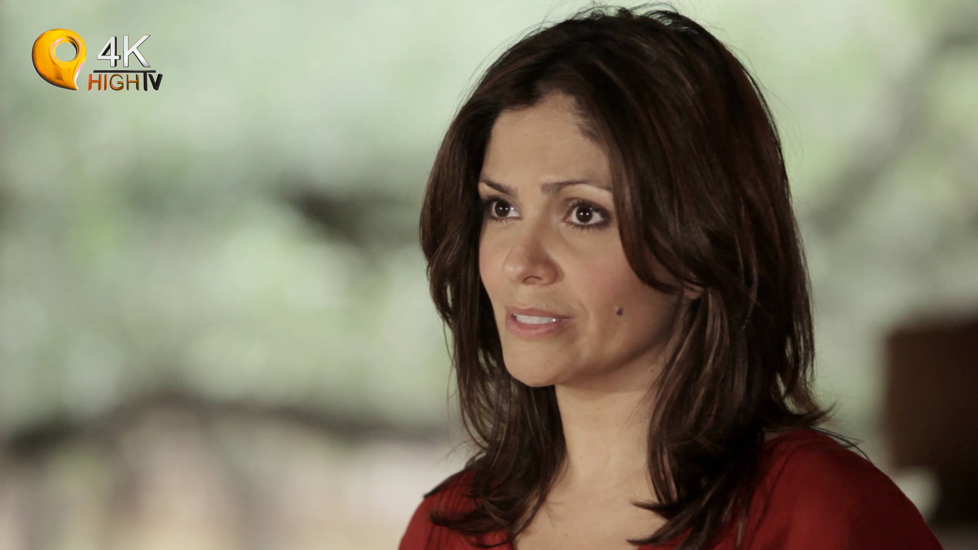

The other UHD channels off 103 are really problematic, pretty much unwatchable. FTV can barely make a picture.
UHD1_2570 4140_V_30000_20160303_204747.jpg Silent Monkeys Channel
High 4k TV_2570 4140_V_30000_20160303_205016.jpg High 4K Channel
NASA UHD TV_2570 4140_V_30000_20160303_203924.jpg NASA UHD TV_2570 4140_V_30000_20160303_203951.jpg NASA UHD

And the "High 4K" channel appears to be 10bit, which would seem to explain the strange colors.
