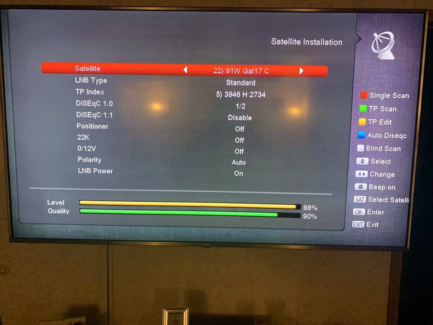

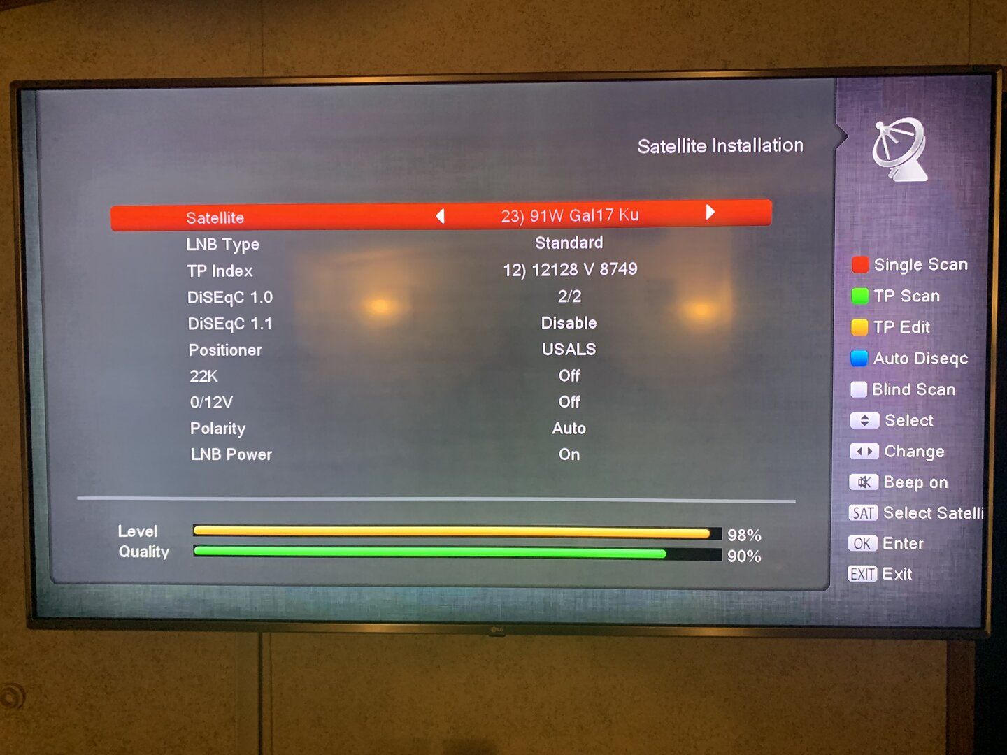

Team,
can anyone tell me why my C band dish positioner moves when I change satellites with my KU band dish? In the menu settings the KU dish uses USALS for location and the C band dish positioner is set to off. Both are using DISEqC 1.0
please advise,
thanks
Settings for C band and KU band dishes

One of the cables goes directly to the C-band LNB? As in the setup, no diseqc 1.2 command is issued for the c-band dish?
Or is the sat-signal still going through the V-box, even though no diseqc 1.2 GotoNn command is issued?
Still, when you issue a diseqc 2/2 command, the voltage should not reach the C-band port of the switch. There are only two ways that I can think of that that could happen: with a shorted port of the diseqc switch, or when the switch, while switching, switches very briefly to the default port (1/2).
You can test for shorted switch by disconnecting the diseqc 2 port cable, and check if the C-band LNB is reached by diseqc setting 1/2 AND by diseqc setting 2/2. When, even if you chose diseqc 2/2, the signal from c-band can still be received, the switch is shorted.
For the other possibility: change ports from the switch! When you don't use diseqc 1.2 GotoNn commands for C-band, there would be no problem. Otherwise the problem would possibly shift to the Ku-motor....
