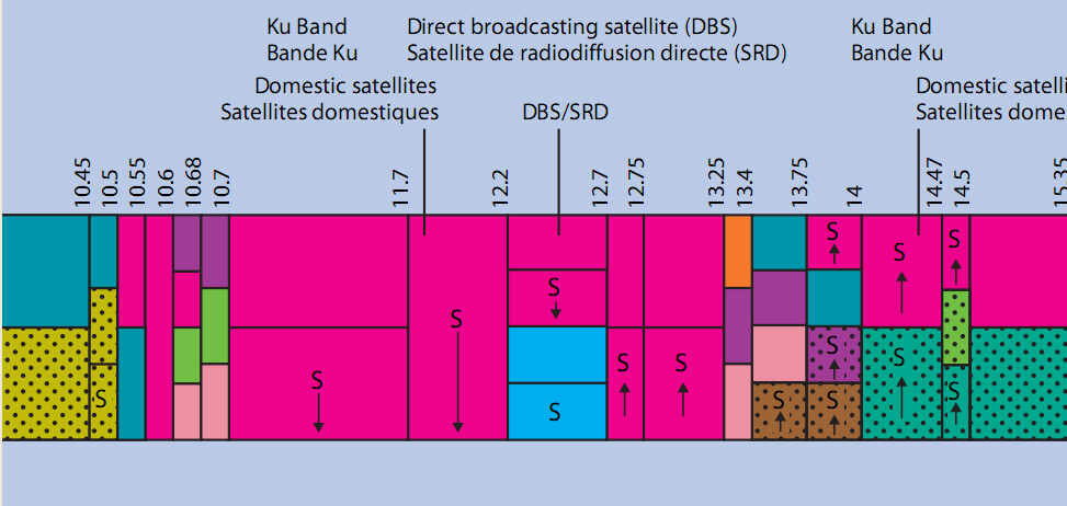

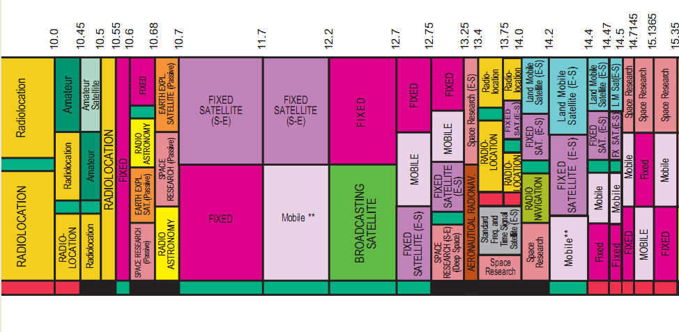

You might not see much below 11.7 Ghz in North America, for those frequencies are assigned to terrestrial use. It took some doing and authority to allow Shaw Direct to use some of those frequencies for their G1 satellite.

Here are Ku freqs for Canada
http://www.ic.gc.ca/eic/site/smt-gst.nsf/vwapj/spectallocation-08.pdf/$FILE/spectallocation-08.pdf
