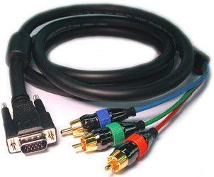

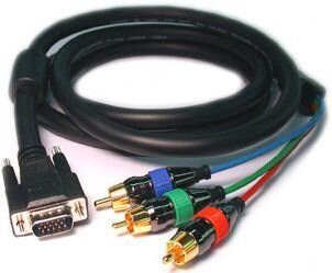

Something like this will do VGA->Component.
Only for $3.55 each when QTY 50+ purchased - 12FT VGA to 3 RCA component video cable (HD15 - 3-RCA) | VGA to 3 RCA component cable
