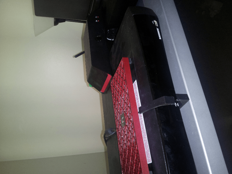

Sling adapter for Dish only works on tv2. You would need a stand alone slingbox which connects to the tv 1 video output instead. I have this type of set up. You can see my sling adapter and slingbox. I can have two people remotely viewing at once. See attached.
