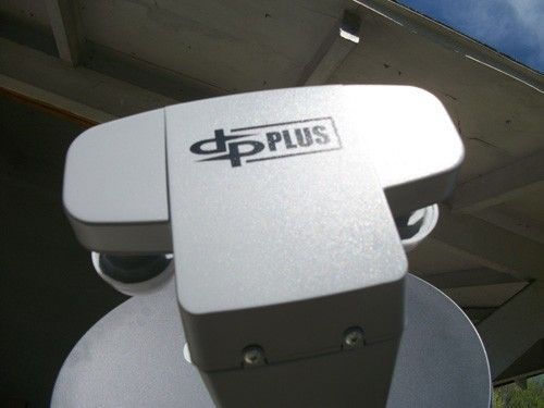

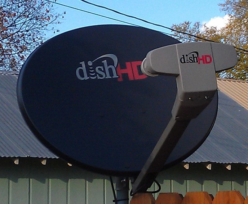

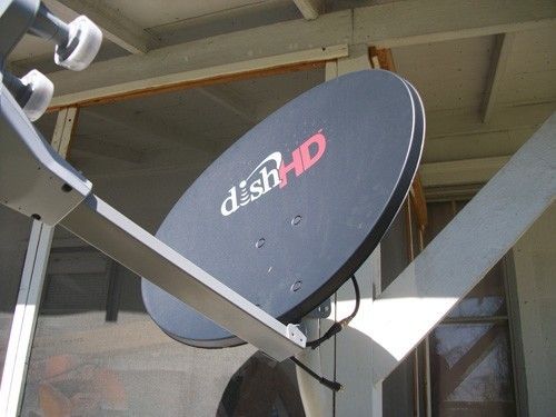

My dish says "DishHD" and its black, the guy said he sold me a dish 1000.2, when I looked DishHD up on Google Images I found a black DishHD dish but their LNB says DishHD on it, mine doesnt... I wondered if I have a wrong LNB on it? Check the pictures...
My Dish:
My LNB:
This is the photo off of google images:

The LNB with the red HD on it is a 1000.4 western arc LNB. For a slightly larger dish.

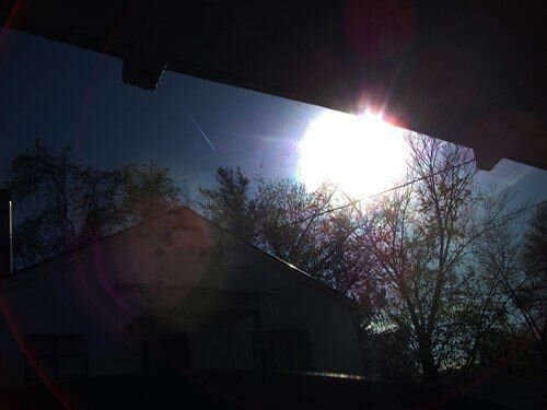

The picture wasn't a good one, the sun was right in the camera and I didnt have much room behind the dish to get a very good photo, I adjusted the photo's levels in photoshop to give a better view of the tree line next to the building which I believe is about where 129 should be (basically where the sun is, but may even be a little more west than that)

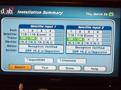

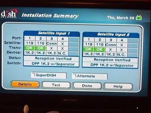

You said it should look like this when 129 is not showing up? with Conn and a X?
That looks like a pretty low clearance for 129, and something may indeed be blocking it. "Conn" means it is connected properly, but no signal is coming through the LNB. I agree with Rorshach in this case, I think it's best if we have a tech come out to verify line of sight

I would say from your picture that you almost certainly have trees in the way of the 129. Probably need to gain a decent amount of height to clear them.
