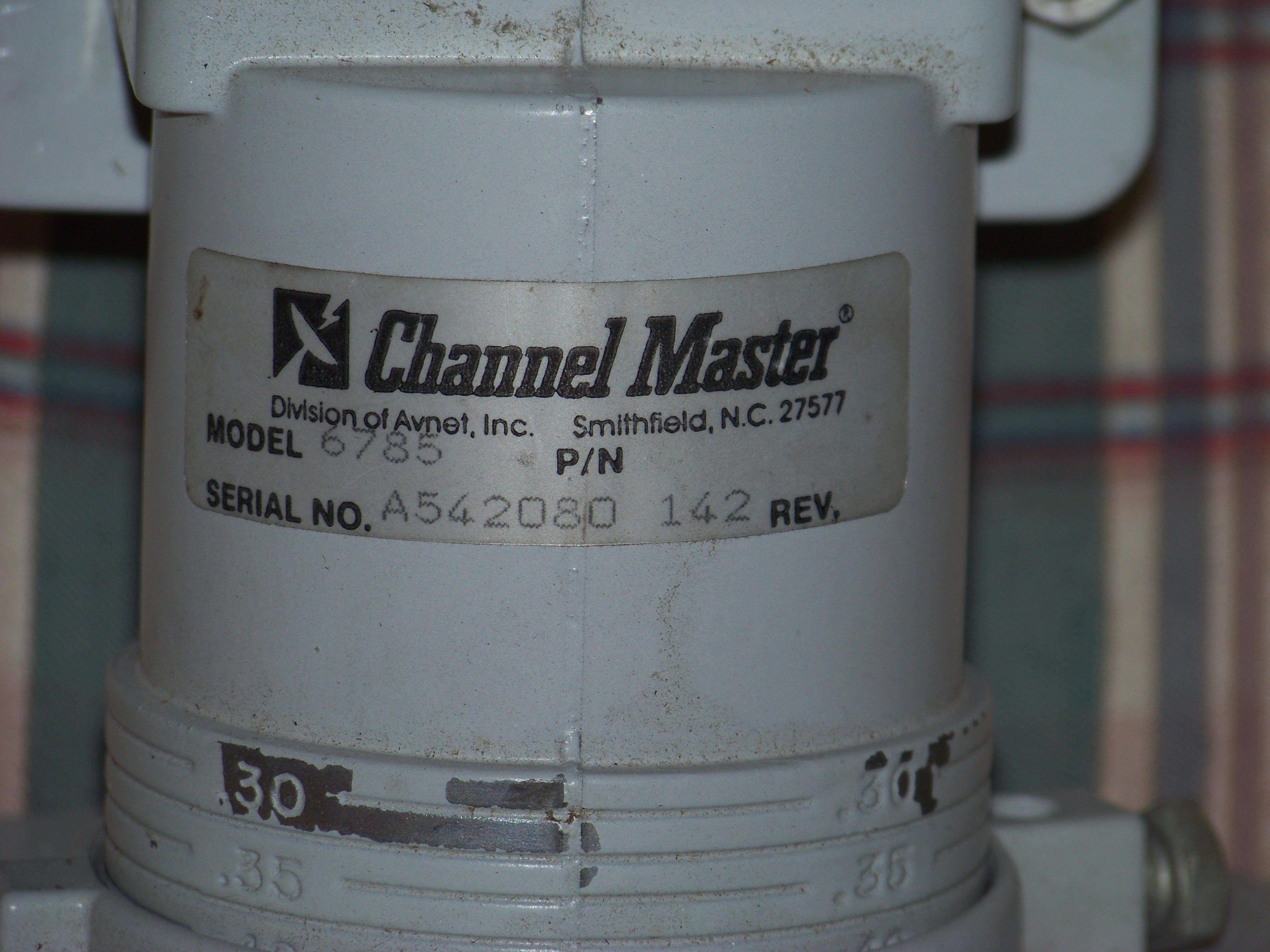

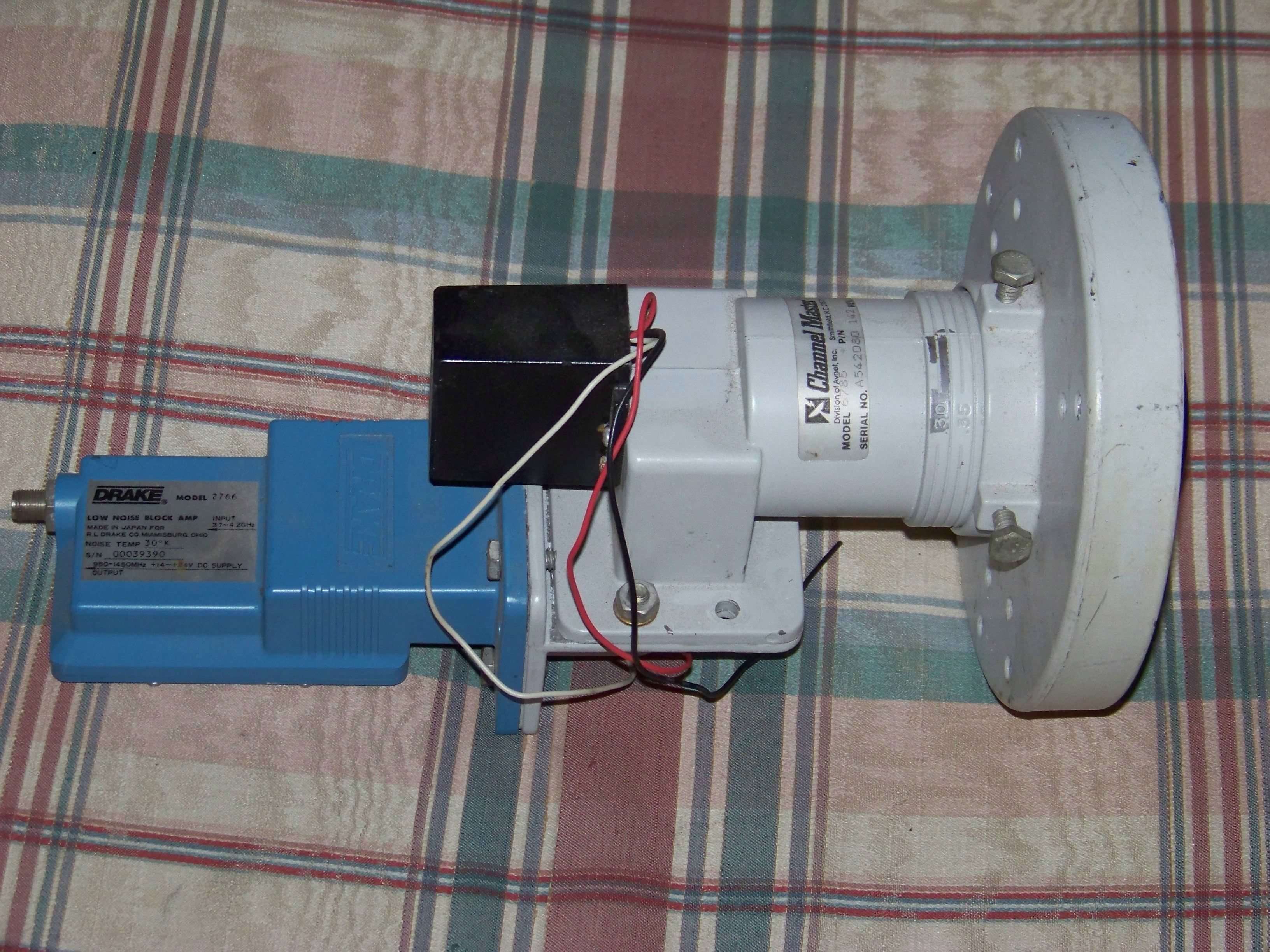

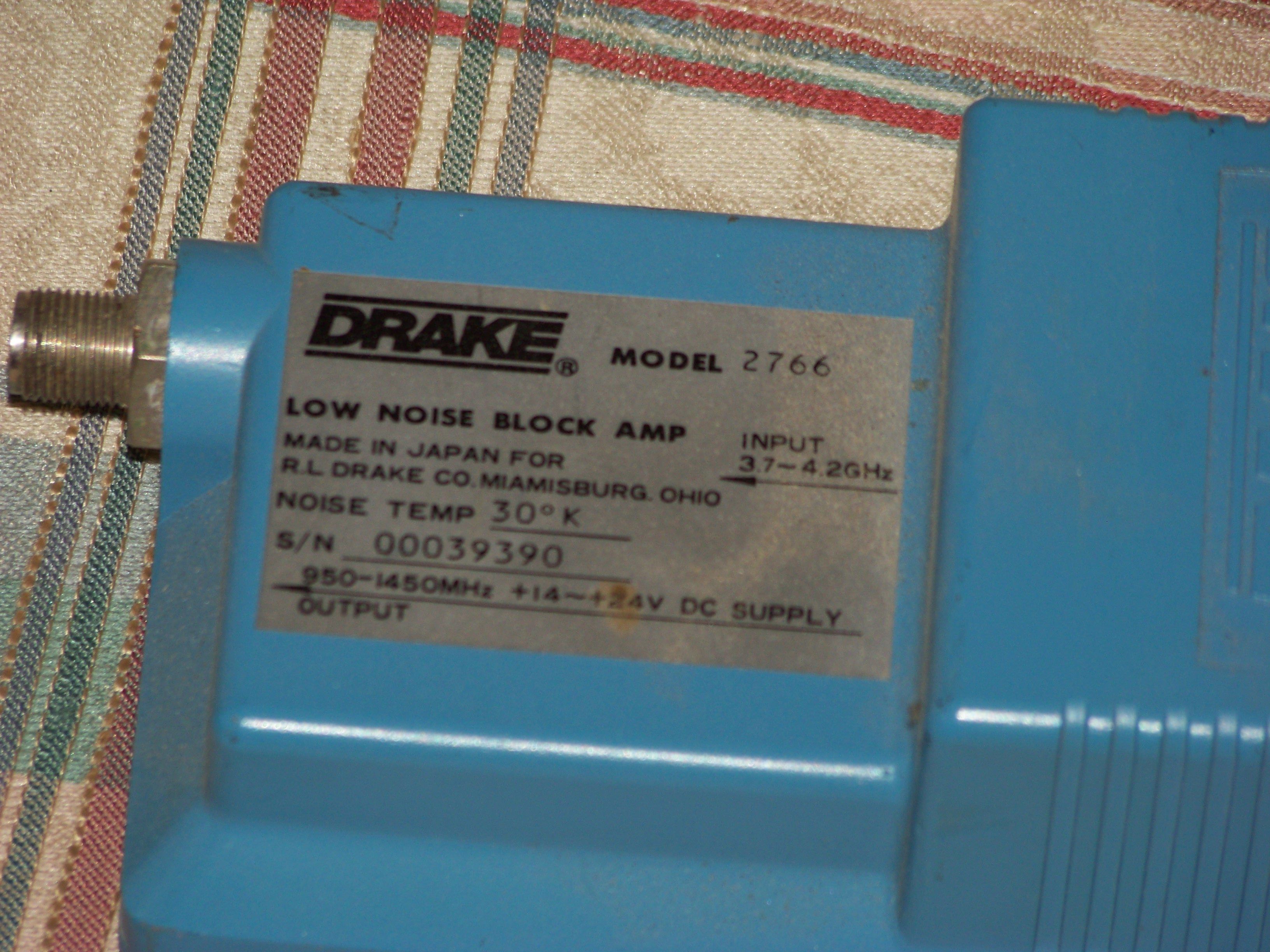

Does anyone know if i can use or upgrade this to work with my DSR-920 for 4dtv?
Thanks

It should work fine. It's a Chaparral knockoff feedhorn/polorotor. With a 30 degree Drake LNB. The 4dtv uses wideband signals so even if the old Drake is + or - 1 meg or more it will work.
