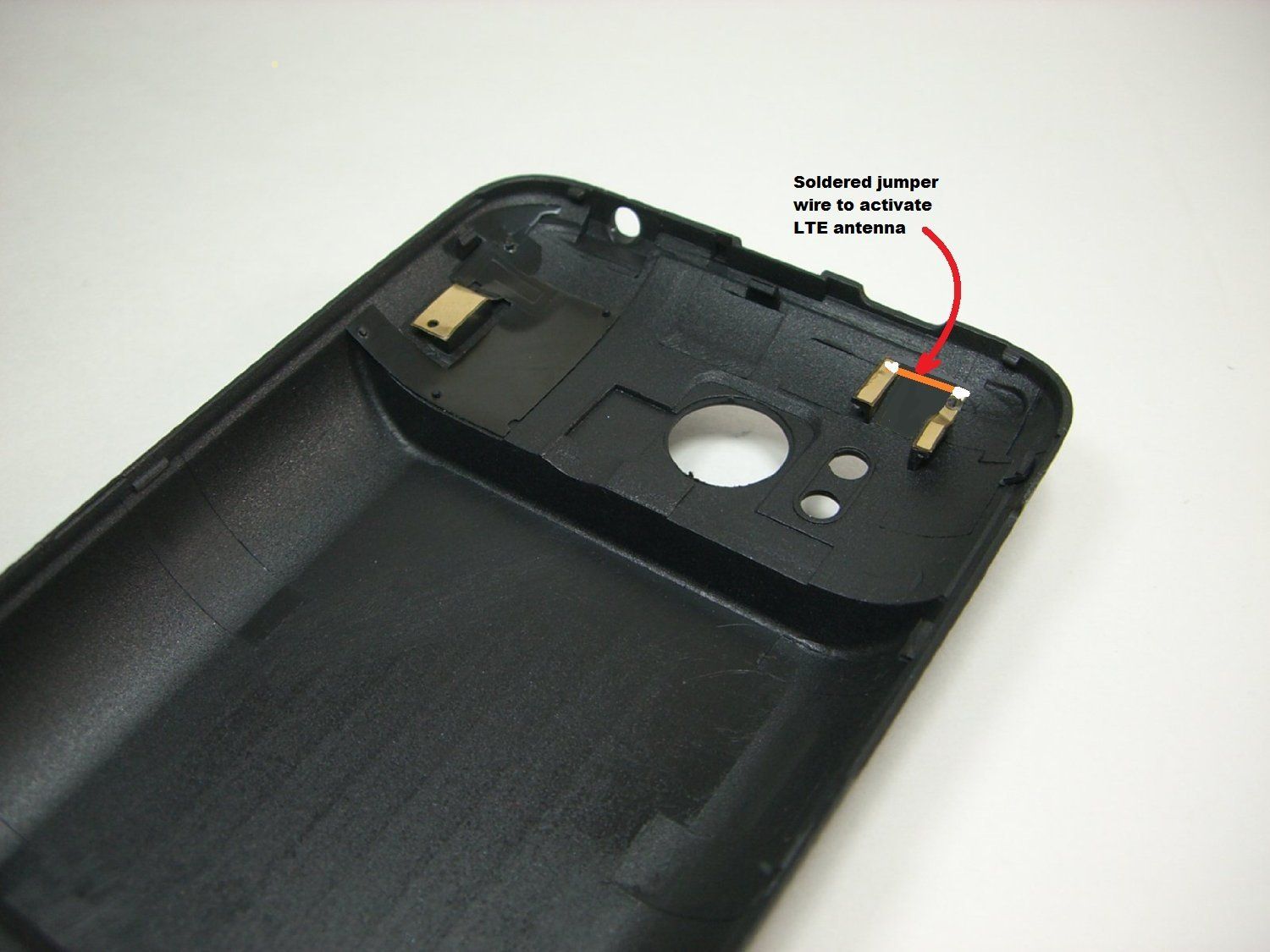

Price too good to be true? For that price I ordered two. I also read the feedback and the major concern was that the larger back would not work for 4G. Others complained that the batteries were used. But the price was too good to not take a chance. I got two kits in and tested them. The backs were different. Both had the left metal tab with antenna. But the large dual tab on the right was missing on one and the other it was two individual tabs. I have no idea why these are so different but when I tested them on the phone I discovered the reports to be true. The one with no metal tabs on the right would only get 1X data. The one that was split could only get 3G and then had trouble accessing any high speed sites like my security cameras video on 9 cameras or sirius XM app. I soldered a jumper wire connecting the two metal tabs and then tested again. Now the LTE popped right up and all my broadband apps were functional on LTE. SUCCESS!

Yes, I understand. BTW- the picture I put up is real close to the actual cover. I "painted" in the jumper wire just to show where it goes. I should take a picture of my solder job, I guess to prove I did what I did.

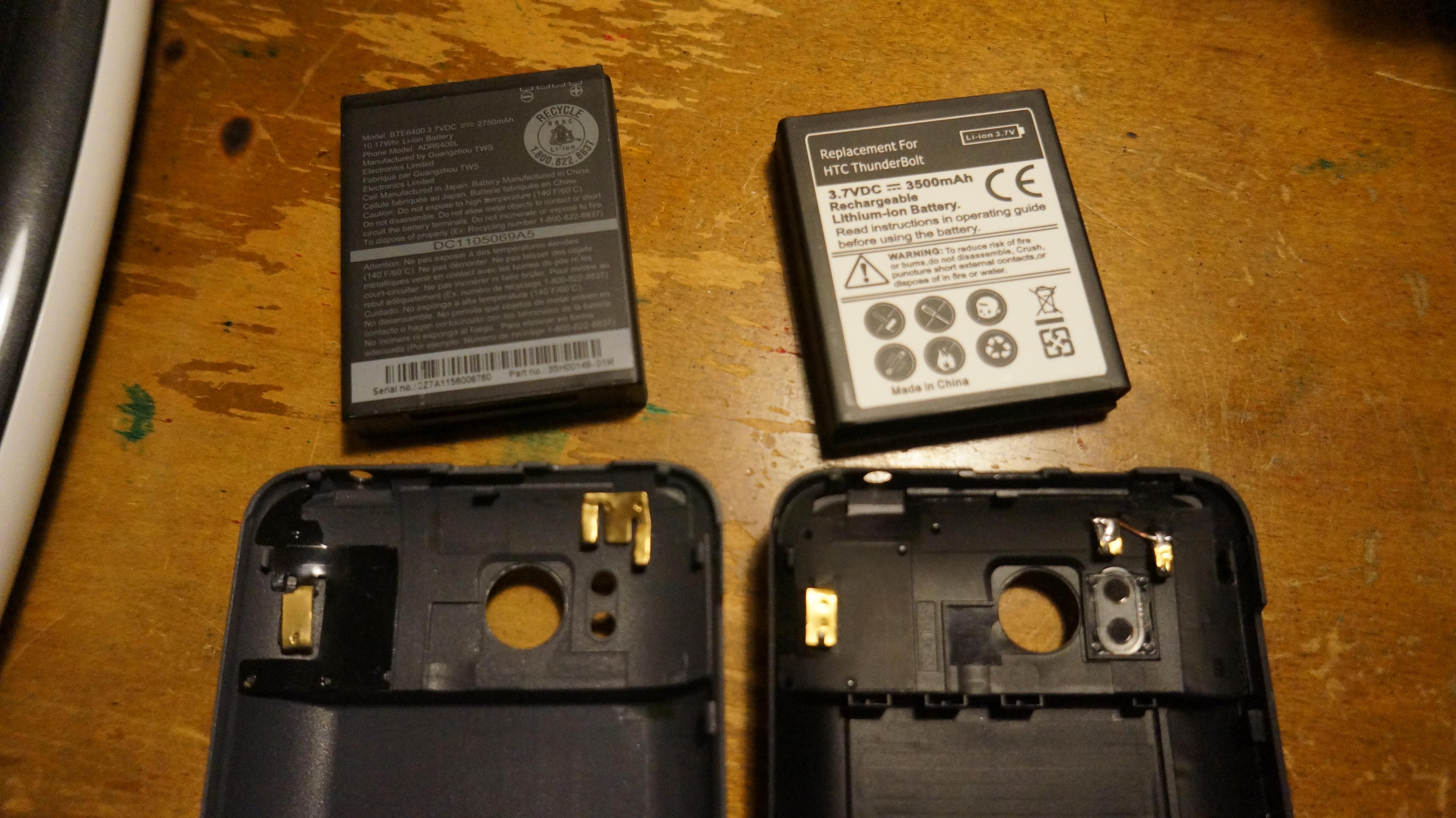

Here is the picture of the two different extended battery covers. The one on the right is the one I fixed with a jumper wire to activate the 4G (LTE)
The one on the left shows the two tabs with brass shorting them out but it lacks the actual antenna that resembles black tape. Hard to see. The 3G tape antenna on the left side of the covers is more visible. It has the single tab.
