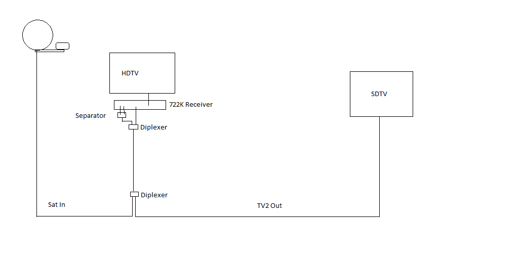

You do not always need diplexers. If you have two cables going from the receiver to a utility room then there is no need for a diplexer. You would only need a diplexer when there is only one cable to that location. The purpose for this is so you can have the the satellite signal going to the receiver and the TV2 out signal going back through the same cable. Picture this as a single cable below:
______________________________________________
-----------------------------------------------------------> Satellite to receiver
<----------------------------------------------------------- TV2 out to other TV
You can pass two different signals through one cable. The diplexers allow you to combine the signals at one location and then to separate them at another location.
?Hopefully this diagram makes more sense.
Thanks for the info JM42 - But what about the diplexers? Every schematic I have looked at has them in line.
If you need them then they could go anywhere between the dish and separator. If you have OTA going to the second 722, or are planning on using the TV2 out on the second 722, or want access to the TV2 out of the other 722, you may need one.

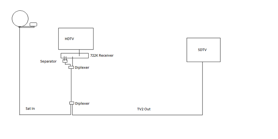

New Schematic Picture
OK here we GO
2 COAX from DISH to Exterior Box.
1 COAX from Exterior Box to Diplexer.
1 COAX from Diplexer to TRIPLEXER.
1 COAX from VHF/UHF to TV2
What can I put in-line on the 1 COAX from the Exterior Box so I can connect a second VIP722K?
Thanks,
?Tony
You will need to run a new coax from the exterior box to the second 722 receiver. There is no way to connect 2 receivers using a single coax.
OK here we GO
Assuming:
  1. The "exterior box" is just a weather protected junction box, and not a switch or other active component.
  2. The second "coax from dish to exterior box" is not OTA or some cable remnant.
  3. The second "coax from dish to exterior box" is actually connected to the LNBs at the dish end
Then you need to extend the second "coax from dish to exterior box" to the new receiver location.
There is nothing you can "put in-line on the 1 COAX from the Exterior Box" that will allow a second 722 to be connected.
Each 722 needs a run all the way back to the dish.
Pay very close attention to MrDogDad's second sentence in post #13. It sounds like you want badly for it not to be true.
You don't need a diplexer if you're using a triplexer. The triplexer is a combination diplexer-DPP separator device.
