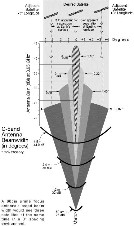

After having a look at the attached image, and looking at lyngsat it looks like you might be in luck as far as side interference since I can't find any regular downlinks from 116.8W to 125W on the same polarity, but you'll should experiment
