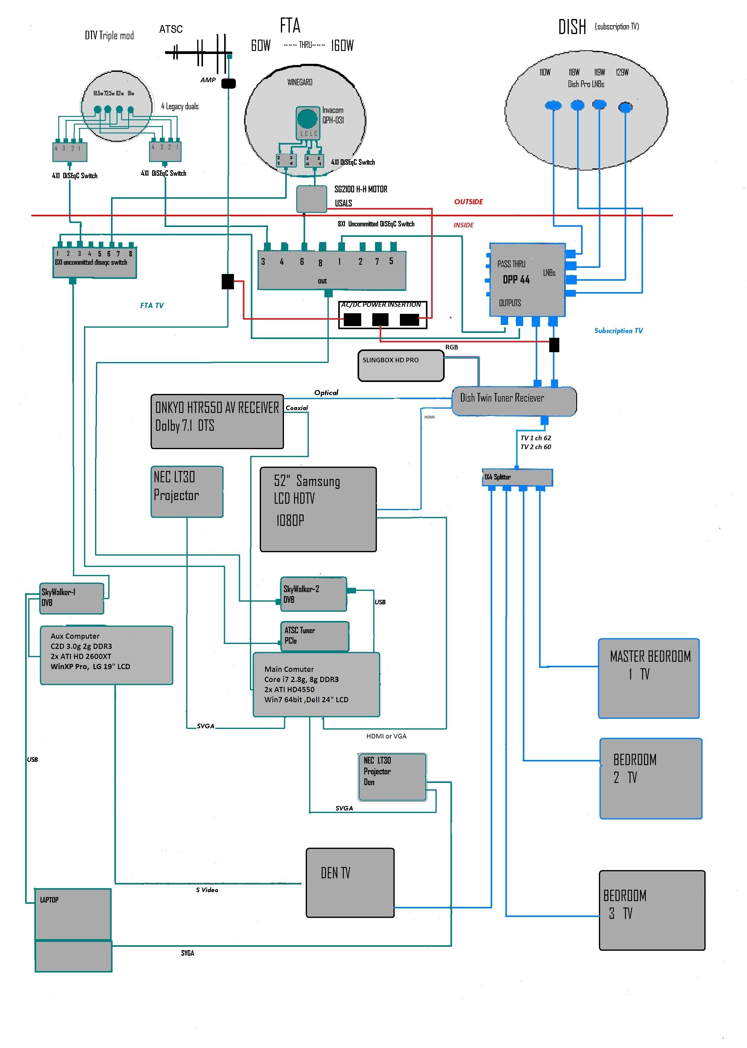

But just for experimenting sake. I have added my dish subscription dish and other fixed dishes to my motorized FTA setup, using an 8 port uncommitted switch.
