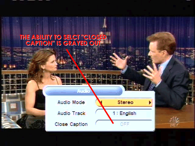

In the audio (green button) menu on the Coolsat, the last parameter on the list is 'Closed Caption' but the option is grayed out, so I can't change it... is that a problem?

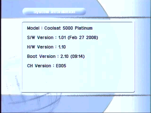

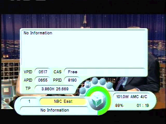

I tried S-video, composite and even RF outputs, 2 different TV sets (Sony & Mitsubishi). OTA closed captions works fine, as does CC from the TVRO analog channels (like PBS-X on AMC4 & ABC on IA8), but I'm getting nothing from the Coolsat. The fact that the "closed Caption" option is grayed out in the audio menu has me concerned... does this option need to be "on" for it to output CC data, and if so, how do I get it so that it's not grayed out and I can select on/off?
Attached are also the channel info screen as well as the firmware version... maybe there's something there that's causing me problems?
