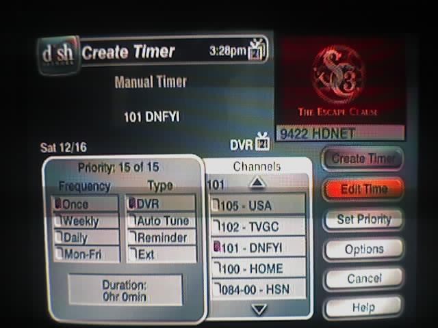

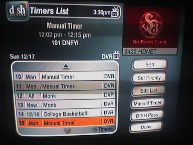

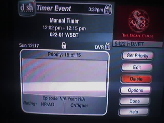

Ah, the behavior is different than the 942. The locals are available at the high end of the channel list. Here's some cameraphone shots:

Basically, the first three pictures show the creation of the manual timer. The fourth one is editing the manual timer and changing the channel to 22-1, WSBT-HD. The fifth shot is the completed manual timer for 22-1, done from TV2 as can be seen in the top banner.

Well, I went in and tried it again. This time when editing the channel rather than scrolling through I just typed 9999 to get to the end of the list, and sure enough, there are all my OTA locals. Very interesting work around.
Thanks for following through on this for us and sorry for my doubts I had earlier.
